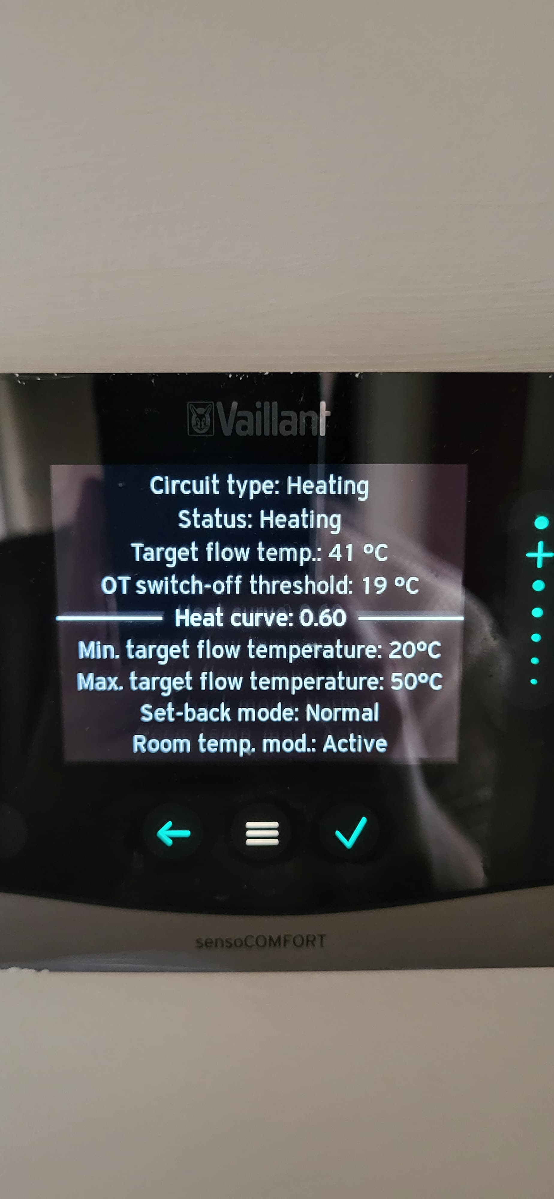

I don’t use the weekly planner, just have it on setback and have desired temperature set to 21 degrees C. My sensocomfort is mounted in the vestubule where the balance radiator is fitted.
During spring / summer it doesn’t come on as much obviously but winter, especially this one has me concerned. Not that it isn’t heating. It is. My house is not cold.

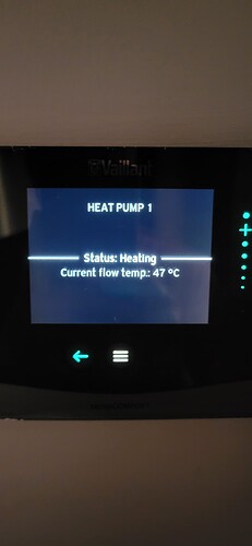

I have attached a picture of my Circuit 1 display taken at 08:35 this mornng when the temperature was -6 degrees C
Heat curve is low as temperatures in the house are fine.
Also the flow temperatures.
This confuses me as which module is determing when flow temerature is reached? Not only that one shows the flow temp way overshot maximum.
I tried having room temp mod. on active only and the compressor just kept running but not low and slow. According to my smart meter it was running at full pelt. (worked by multiplying the max kW rating of the compressor x the pence per unit of my tarriff) so i switched back to expanded.
Any ideas what to do? I’m looking into getting the control board replaced as that seems like a good bet.

The overshoot may be down to a VF1 sensor being connected. Check to see if you have a sensor on flow pipework that is connected to a connector called “VF1”. This was in a lot of Vaillant schematics, but is now not recommended as it can cause overshoots.
To get the best efficiency from the system you should ideally be using “active” room mod instead of “expanded” and adjust your heat curve down if possible. There will be a bit of trial and error needed, but by doing this you may be able to reduce the flow temperature and in turn improve efficiency,
‘Expanded’ mode will turn the heat pump and circulation fully off once the indoor temp reaches your set point, then back on again. I would only use Expanded mode in the summer months, when it makes sense for the entire system to be off, except for hot water runs.
‘Active’ mode will aggressively ramp up power to quickly reach your indoor set point; this is why you’re seeing high initial consumption. It does settle after a while.
‘Inactive’ ignores all indoor temp readings, and runs using pure weather compensation based on outdoor temp only; this will be the most likely to run ‘low and slow’ as you’re intending.
Hi thanks for the answers. DHW wasn’t on as that is programmed to come on between 1pm and 2:30PM. I’ve just run a little experiment. Set my room temp. mod to Active, below is the result
Now not too long after i took these pictures my heatpump did throttledown for a few minute, smart meter was down to a few hundred watts (no other major sources of energy use were on)
I will look at the other temperature sensor.
Quick update. Left the house for half and hour, came back and system had throttled back up to full, flow temperatures above target on both flow temperature readings. For the time being gone back to expanded mode as i can’t afford to have the compressor running full tilt when flow temperatures reached

If the ASHP flow temperature is overshooting (above when the heating circuit wants) then you have a seperate issue. It’s almost always one of these three reasons:
  • DHW is running
  • There is another heating circuit asking for higher flow temperature.
  • Flow/BufferTop sensor is connected (either to VF1 on heat pump controller or S1 on VR71)
But if could also be a fault or an issue with a sensor.
Nothing wrong with using expanded is this is what is working best currently, but ideally you want to get to the bottom of the overshoot issue and tune your heat curve to enable you to run it more efficently on active.
