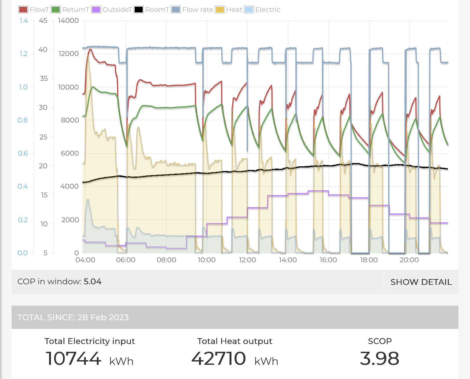

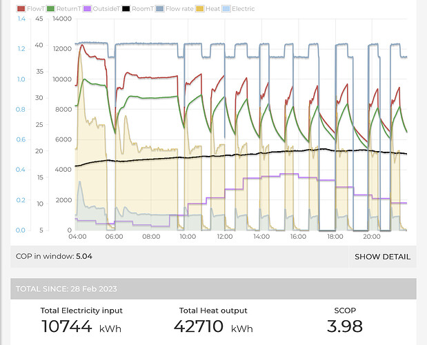

I run my system in Expanded all the time. Energy Integral can lead to shutting the heat pump off if it reaches its trigger point before the set temperature is exceeded.
The data below shows this clearly. I have just come back from holiday and so the house was returning from running at 15°C and is returning towards it’s normal target of 20°C
The top blue line shows flow rate. When this drops slightly the heat pump is shutting down on Energy Integral (and the circulator pp keeps running). When it drops to zero the heat pump is shutting down because the temperature set point has been achieved (and the circ pp shuts down as well).
Whether it shuts down on Energy Integral or temperature set point depends on the race between reaching their respective trigger points.
Hope this makes sense!
