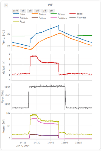

**Post date:** [4 January 2024 14:22 UTC](https://community.openenergymonitor.org/t/vaillant-arotherm-owners-thread/21891/254 "2024-01-04T14:22:13Z")
I have a newly installed arotherm plus vwl 105/6 & VWZ MEH 97/6 hydraulic station. I don’t have an OpenEnergyMonitor setup yet but am reading all relevant data out of the device via ebusd (flow temp., return temp, flow rate, electrical power, yield power) and pipe it into Home Assistant via MQTT so I have some real-time monitoring set up (happy to share any configs if so desired). I have come across some curiosities that I need some help understanding.
1. Vaillant provides electrical power via ebus. Electrical power aligns very closely with my 3-phase Shelly setup that monitors heat pump electrical supply, so that’s all good.
2. At the same time, I can read the current yield power. It is my understanding that this is the environmental yield power, i.e. power extracted from the environment. As a matter of fact, when integrating this power over the full day I get almost exactly the same Environmental Yield Energy as the myVaillant App provides. Yesterday’s self calculated environmental yield based on the power measure was 34.4 kWh whereas Vaillant gives 35.5 kWh. As my data polling is not as granular as Vaillants internal polling and I am using a completely independent numerical integration, this is quite a good match.
3. Since I can also read flow rate, and flow/return temperatures I though that would enable me to calculate actual heating power, which by Vaillant’s definition would be Environmental Yield + Electrical Input (minus some system losses). Now comes the part I don’t understand: If I calculate heating power via 4186 J/kg/Kelvin \* Flowrate \* deltaT, I am getting almost exactly the values that Vaillant provides for the Yield power. You can see a snapshot of my measurements in the following picture:
 ![image](https://community.openenergymonitor.org/uploads/default/original/3X/b/d/bd2bc7be1b360b8713cf0bebcdc45a47c8ed89da.png)
P\_yield is grabbed directly via ebus from the heat pump, P\_heat is calculated on the fly as defined above. In my understanding, those two should not be equal. Remember I calculated above that the integrated yield power sums up to Vaillant’s “Environmental Yield”. Heating power must be higher since we’re also putting electrical energy in (and Vaillant, in multiple documents, explicitly states that Yield energy is not equal to heating energy.
Can anyone help me understand why the yield power would be equal to my calculated heat power?
EDIT:
What a stupid mistake & remarkable coincidence. It all comes down to forgetfulnes & unit errors (should have known as a physicist :D). I didn’t convert flow rate from kg/h to kg/s (factor 1/3600 error); also somehow the water heat capacity 4186 J/kg/Kelvin got left out of my calculation. Those two almost perfecly cancel out the COP factor at current flow/outside temperatures. I corrected this and now it makes perfect sense. Thanks for listening 😃 .
 ![image](https://community.openenergymonitor.org/uploads/default/original/3X/1/1/11f6ce1850eccc28dec863771fe55db043ba48d9.png)
