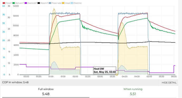

Ran -60 and -100 settings on consecutive nights. Currently with a desired temp of 19C on Expanded (as don’t really want it on in the day and cba with programming the weekly timer etc)
Dropped to 2 noticeably longer cycles with longer intervals despite nominally lower outdoor temp (6.4C!) which suggests it is working correctly. Yet to be awake and at home whilst its running to watch the energy integral move.
Interestingly day 1 the pump ran between cycles, day 2 it didn’t (which I imagine is just expanded kicking in as it definitely felt cosy last night!)
Another interesting observation (from my point of view) is 5.5 kW is the output it was giving me when the compressor backed off which is a little higher than I had hoped for given I suspect the unit is oversized for my needs.

Emoncms - app view

Edit: now tested and energy integral is behaving as expected (live monitor updates every 30 secs by half the difference between desired and actual flow temp: ebusd off until controller issue sorted!)

Was cycling down to about -2C before. Will be interesting to see the behaviour next heating season.

I bumped it to 100 from the default of 60 during the winter and noticed a huge difference. I have before vs after charts. Will share them later.
