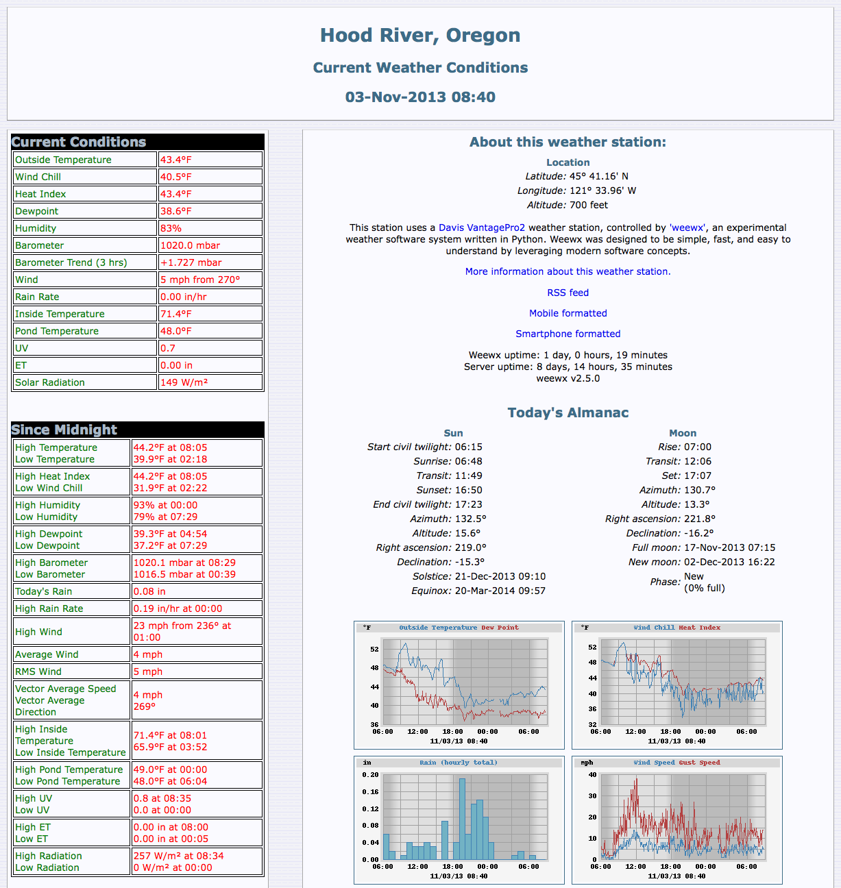

 ![image](https://community.openenergymonitor.org/uploads/default/original/2X/5/55ca35f02db7341bd2e398f43b46087bacda81e3.png)
Here’s a link to a Python app that’ll take your WH1080 data and draw lots of nice charts and graphs: [http://www.weewx.com](http://www.weewx.com)
Like this one:
[![](http://www.weewx.com/screenshots/hoodriver.png) ](http://www.weewx.com/screenshots/hoodriver.png)
