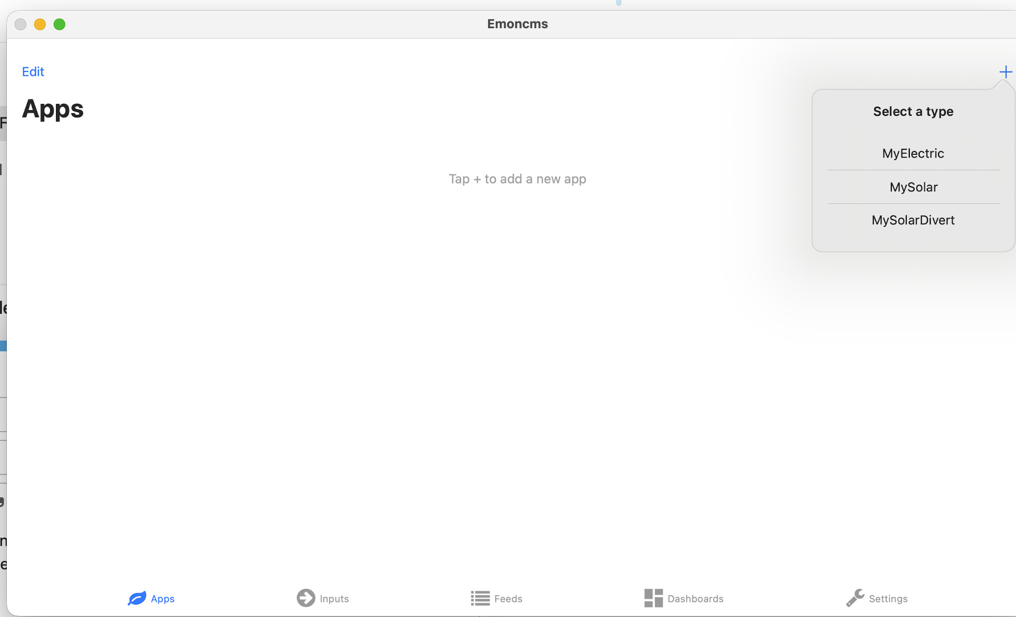

Have been using the web for getting information for my heat pump. Downloaded the App onto my Mac. When I open the app I can see the Dashboard but not the Apps. It requests that I add an App, but when I click on + it does not show the Heat pump App.
Hello @dmhom the iphone app was a really nice community contribution by @mattjgalloway but it pre-dates the MyHeatpump app that is available in the web version of emoncms.org. Our recommendation is to use the web version directly and then save a shortcut to the home screen, following this process: https://www.youtube.com/watch?v=lKbsY8hLVaw
Sorry, it’s correct that the iOS app doesn’t support the MyHeatpump app unfortunately. I haven’t got a MyHeatpump setup I could develop it against, and I haven’t had chance in a while to update the OEM app sadly!
