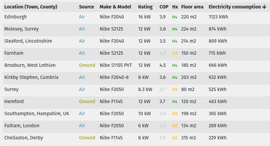

For comparison, here’s a [snapshot of NIBE heat pumps over the last 30 days](https://heatpumpmonitor.org/?filter=nibe&period=last30&minDays=30&add=floor_area,from_energy_feeds_elec_kwh&rm=installer_name,installer_logo,combined_data_length,learnmore,photos,training,water_cop,mid_metering) showing electrical consumption over a variety of property types (David’s Passivhaus is at the bottom):
 ![image](https://community.openenergymonitor.org/uploads/default/original/3X/0/2/02409c77390fb8aaac24aa7db30f0163cc1cdc4e.png)
600 kWh over 30 days falls in the middle of that list, so not terrible, though maybe higher than you would have hoped for with a passivhaus.
