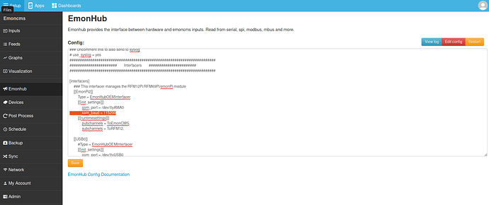

Login to the local emoncms account and navigate to Emonhub > Edit config:
Change the baud rate for the [[EmonPi2]], Type = EmonHubOEMInterfacer from 115200 to 38400. Older hardware used this slower baud rate, the new hardware uses 115200.
Click Save at the bottom of the page to complete.

I tried modifying the config as mentioned however it made no difference, I changed the baud rate as suggested, still the display shows __, I went back to the old image and tried to reset the emoncms password but there is no such file as resetpassword.php.

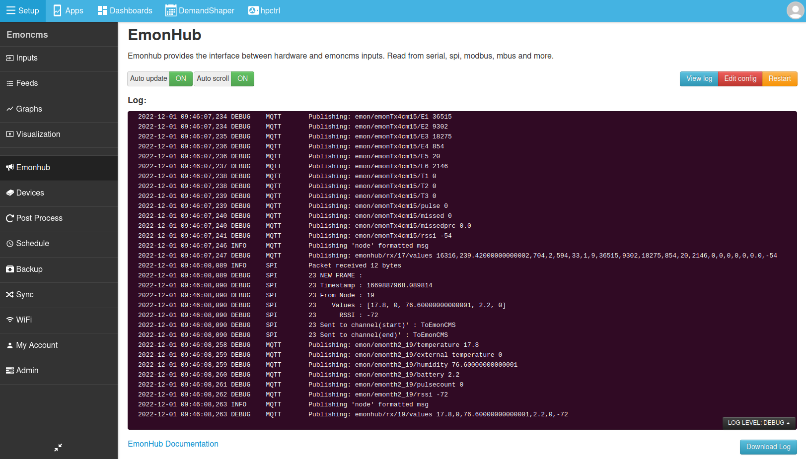

Hello @canpandave with the baud rate changed the next place to look is the EmonHub log, do you see any data coming through there?
If you see data coming through there, there should also be inputs on the inputs page. If you dont see anything in the EmonHub log window try restarting EmonHub by pressing the ‘Restart’ button top right.

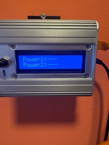

I am, obviously a neophyte, but I have it back up now and this is the serial monitor log. Power indicators still show Power1:—, Power2:—. I am willing to try anything

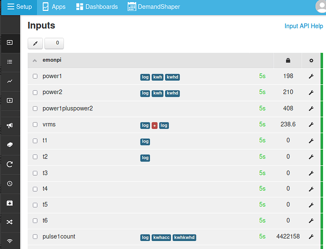

So, can you describe what you mean by “Power indicators”, and what now shows on the Inputs page of emonCMS? You should see something like this, but you won’t have the centre column of process steps.

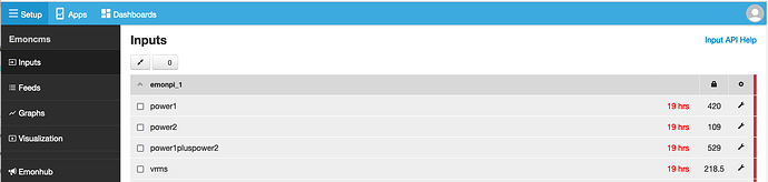

From what I see it looks like the data was reported only once 19 hours ago,
and the Power Indicators I refer to are on a screen of the LCD display of the Pi.
If you’d said the powers shown on the LCD screen, we’d have known what you meant.
It looks as if the process that transfers the data from emonHub into emonCMS isn’t working. This is an area I don’t know at all well, so I might struggle.

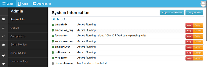

The starting point is, are all the processes running on the Admin →System Info page?
Yes, pretty much exactly as your screen shot, I have 0 feed points pending write is the only difference
