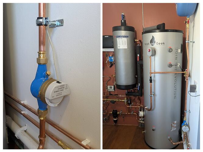

Hi @teepbee,
I’ve had a look at your data and I can see the water meter is working, reporting data with 0.01m3 (1L) resolution :partying_face:
It took 5.5 days for the meter to start reporting. It seems it take a while for the battery in the IWM-MB3 reader to charge up, according to the datasheet this rechargeable battery is charged from the USB MBUS reader. The was actually a sticker on the box which said to allow 6 days of recharging before use, however since the reader started reporting immediately I assume the battery was already pre-charged. I guess it’s the hall-effect part of the reader which reads the water meter rotation, which take a while to charge.

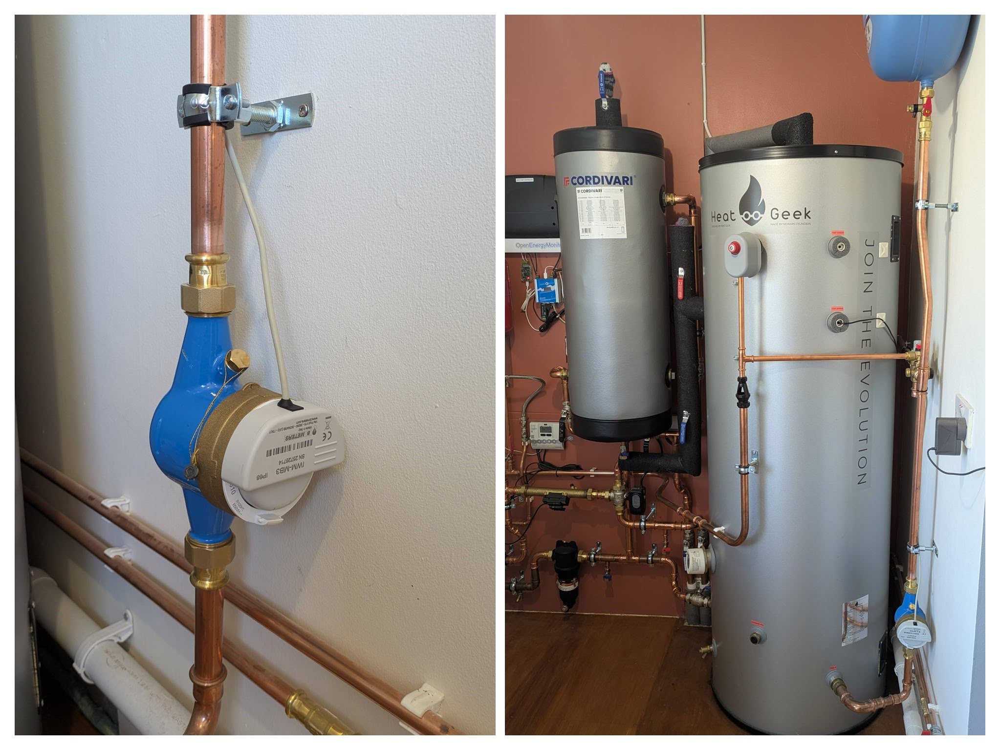

Apologies for being aware of this, nobody has mentioned it in the past! I’ve just installed the same meter on my home system, it’s currently reporting 0m3, I guess I’ll need to wait 5-6 days for it to start reporting

Actually the sticker says 6hrs, but it seems to take longer than this. My water meter has been connected for 3 days now, no data yet. I’m expecting it to start reporting in a day or two. Will keep you posted :eyes:
