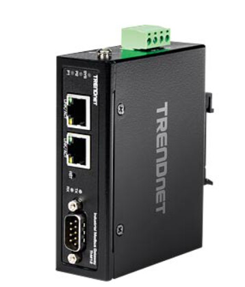

What is on the end of the Modbus cable remote from the B19? If it is a cheap USB-\>RS485 convertor, then these are not galvanically isolated so may be the cause of your strange behaviour. In my experience with Modbus/RS485 on real industrial plant, for lengths below 10m, the cable quality is not very important, it would work OK over a bit of wet string (provided it was twisted pair wet string).
**Author:** ![Martijn\_Hinderdael](https://community.openenergymonitor.org/user_avatar/community.openenergymonitor.org/martijn_hinderdael/32/34246_2.png) [@Martijn\_Hinderdael](https://community.openenergymonitor.org/u/Martijn_Hinderdael)\
**Post date:** [31 August 2026 09:02 UTC](https://community.openenergymonitor.org/t/troubleshooting-samsung-101-error-codes-on-a-ae080rxydgg-eu-wiring/30295/5 "2026-08-31T09:02:23Z")
A Trendnet TI-M12 with ground connected to the casing (screw connection next to the green wire connectors)
Both Modbus and NASA cable are ~20m

Although that looks like a professional bit of kit, it doesn’t specifically say the RS485 is galvanically isolated. So (lot of assumptions here) …
- Since the Intesis does not exhibit the problem and is galvanically isolated, but I don’t believe the B19 is and does exhibit the problem, it is likely galvanic isolation is significant.
- The only way to clear the 1.1v on F1/F2 is a power cycle suggests a non-destructive interface chip latch-up, probably caused by a large noise spike, probably caused by un- suppressed switching of an inductive load.
If that theory is correct, then @Johnmo suggestion is one way of slowing down that spike. I guess I would be inclined to open up the Trendnet first to confirm if the RS485 is galvanically isolated , it should be obvious from the layout, a large track free gap somewhere in area of the RS485 interface chip. If it is, then it is looking like a noise spike coupled into the cable.

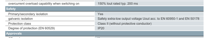

The TI-M12 is connected to a 24V DC Siemens power supply that I ordered with my Siemens LOGO PLC.
Only thing directly connected to the outside world on that thing is the casing connection to ground…
The modbus RTU cable is terminated with a 120 Ohm resistance on the heat pump side but not on the TI-M12 side (I could not fit a proper resistor in the DB9 connector).
Do you still consider it plausible that some spike could travel to the Modbus cable from the TI-M12 side with this setup?

> [@Martijn\_Hinderdael](#):

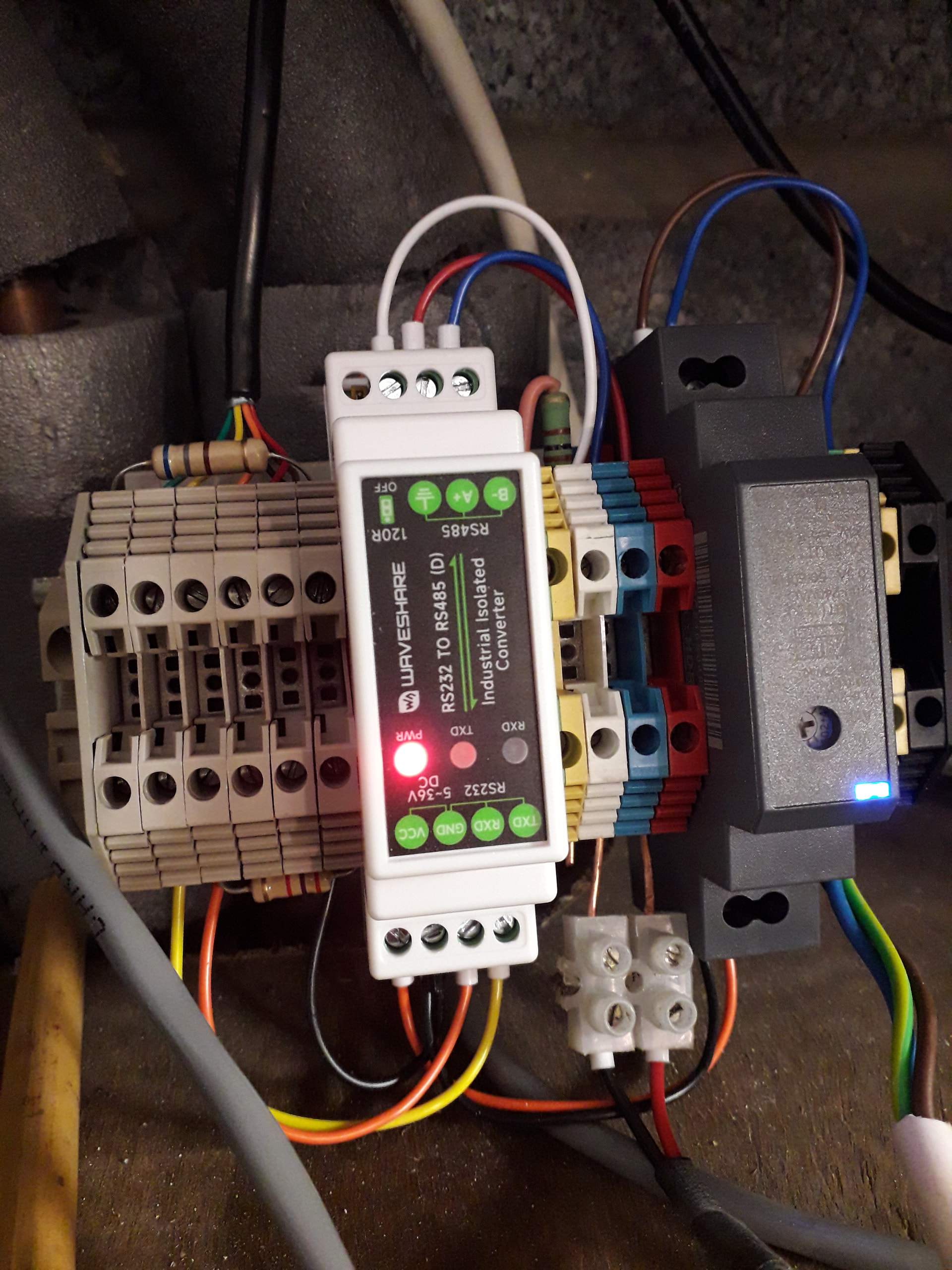

If this was a 1-phase TNCS installation, then probably not. However, the AE080RXYDGG/EU appears to be 3-phase, and the 50R resistance between Earth and Neutral suggests a TT installation, so my probably not becomes possibly yes. In fact your connection of the enclosure of the T1-M12 to Earth with this setup may well be the injection path of the noise spike. If you don’t want to open the T1-M12 up to have a look, since it has RS232, then you could buy something like …
> **[RS232 TO RS485 (D) - Waveshare Wiki](https://www.waveshare.com/wiki/RS232_TO_RS485_(D))**
to prove/disprove the point (it’s a lot cheaper than a 'scope). I use this device in my system.

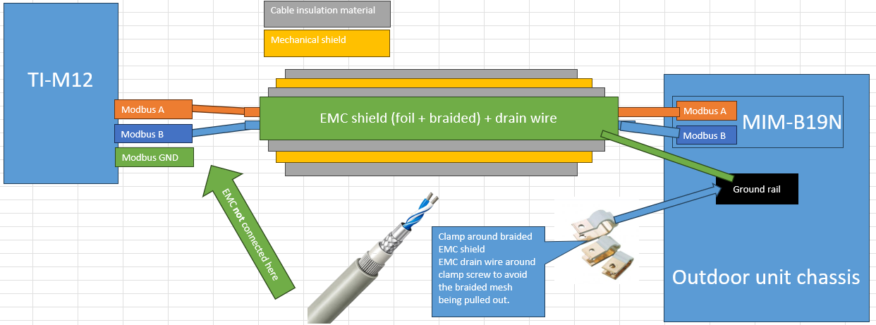

I think I missed this, are you saying you had the third RS485 signal, the GND connection, connected to the shield of the cable? If so that would likely be a very bad thing. So yes, I would connect the shield to the grounded metalwork of the outdoor unit, especially if the F1/F2 cable and modbus cable travel together over a significant part of the 20m. When connecting the shield grounds to the chassis make the connection as short as possible otherwise you will suffer from the pig-tail effect, from a high frequency point of view the shield will not be connected to ground at all.
Something like this
[https://www.soselectronic.com/en-gb/products/ettinger/14-45-505-134517](https://www.soselectronic.com/en-gb/products/ettinger/14-45-505-134517)
**Post date:** [6 September 2026 21:12 UTC](https://community.openenergymonitor.org/t/troubleshooting-samsung-101-error-codes-on-a-ae080rxydgg-eu-wiring/30295/16 "2026-09-06T21:12:51Z")
> **[RS485 grondkabel 1 pair Belden Alternative 9841 SWA Eca](https://webshop.cedel.nl/nl/RS485-grondkabel-1-pair-Belden-Alternative-9841-SWA-Eca)**
> Hoge kwaliteit Belden Alternative RS 485 Modbus kabel 1 pair (2 aders) voor diverse toepassingen. De kabel wordt gratis op maat geknipt.
This is the cable I purchased for the Modbus connection.
Although the picture does not show it, the cable has a drain wire which is connected electrically with the shield.
The mechanical shield is not connected…if I remember well.
Mechanical shield is certainly not connected to the outdoor unit Chassis but I am not 100% confident if it is also not connected to the EMC shield.

![image](https://community.openenergymonitor.org/uploads/default/original/3X/1/f/1fd2650e7587e5205b93944b5eedfe20c18168a9.png)
(Correction on the clamp connection explanation)
Is this interpretation how you recommend it?
Sorry for keeping asking but after having taken things apart more often than I am happy with I really need to understand 100% what I should do.
