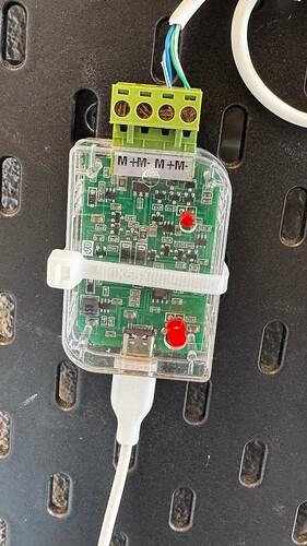

Hi there,
I’m trying to troubleshoot the following communications issue:
```auto
Aug 25 12:01:00 emonhp emonHub\[2294\]: ERROR MBUS Could not find MBUS device
Aug 25 12:01:00 emonhp emonHub\[2294\]: ERROR MBUS Could not write to MBUS serial port
Aug 25 12:01:00 emonhp emonHub\[2294\]: ERROR MBUS read_data_frame could not read from serial port
Aug 25 12:01:00 emonhp emonHub\[2294\]: DEBUG MBUS Invalid MBUS data received 0 bytes 0.4 ms, count: 1
Aug 25 12:01:00 emonhp emonHub\[2294\]: DEBUG MBUS Invalid MBUS data received 0 bytes 0.5 ms, count: 2
Aug 25 12:01:00 emonhp emonHub\[2294\]: DEBUG MBUS Decoded MBUS data: None
Basically, my heat meter is installed and connected via the MBUS adaptor on the emonpi2. I can see it’s configured for `com_port = /dev/ttyAMA0`
This device exists:
```auto
 pi@emonhp:\~ $ ls -l /dev/ttyAMA\* 2>/dev/null
crw-rw---- 1 root dialout 204, 64 Aug 25 12:00 /dev/ttyAMA0
But I don’t see any messages in the log when I plug the dongle in, even though there is a red light indicating power.
 ![IMG_8921](https://community.openenergymonitor.org/uploads/default/original/3X/f/5/f5fa325bb0f59b4b93a6a990dee537c765118fce.jpeg)
 ![IMG_8920](https://community.openenergymonitor.org/uploads/default/original/3X/d/6/d69fdb05f89f50c0478ce1e80c6cc1693fc5d6c0.jpeg)
Is there anything I need to look at? Any suggestions?
Thanks!

> [@rvangraan](#):
> `Could not write to MBUS serial port`
It might be a permission issue. Other than that, I don’t know, sorry.

I’ve solved the problem. The cable was bad and it the emonpi detected the port after swapping the cable.
