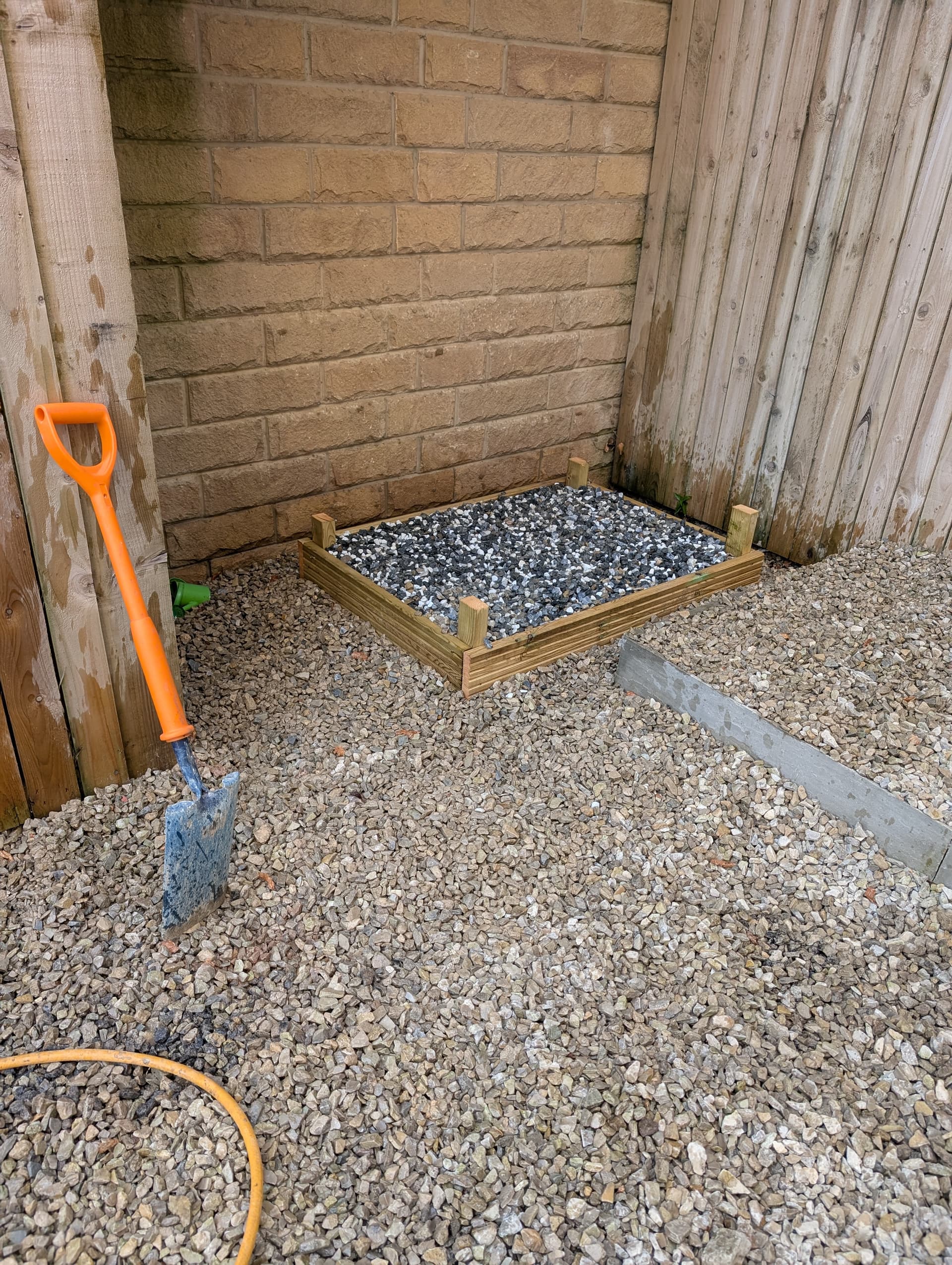

![PXL_20250506_110032116](https://community.openenergymonitor.org/uploads/default/original/3X/6/e/6e56229d57d4a22b1729c86bf681d1019c38a1e5.jpeg)

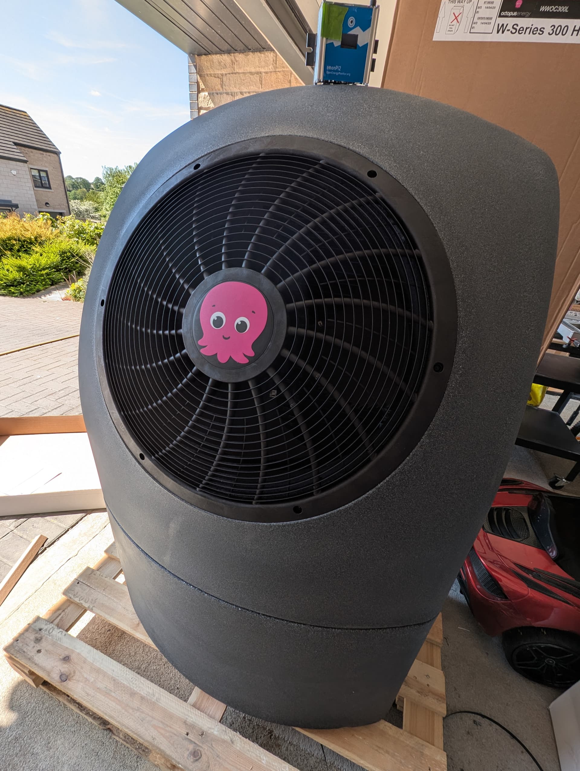

Rescheduled for next week.
So it turns out the cosy 9 DOES have a removable panel but because it’s wrap around you absolutely need clear ground in front, it has moulded sliders.
 ![PXL_20250506_154920082](https://community.openenergymonitor.org/uploads/default/original/3X/8/4/84d9d15df5573aa74ae82c9280a60ad3910e6629.jpeg)
I’ve also found out that in no way shape or form can the cosy 9 condensation drain go into soil stack or grey water waste - I have not had a solid confirmation on this but apparently the volume of R290 means there is a auditable risk of that leaking into drainage system… So soakaway only! Daikins apparently have a no return valve to prevent this.
I have the system here so I will take some internals soon. Box states 4.65 COP @ 8kW. 0.88 KG of R290.20A max current. UPML 25-105 130 grundfos.

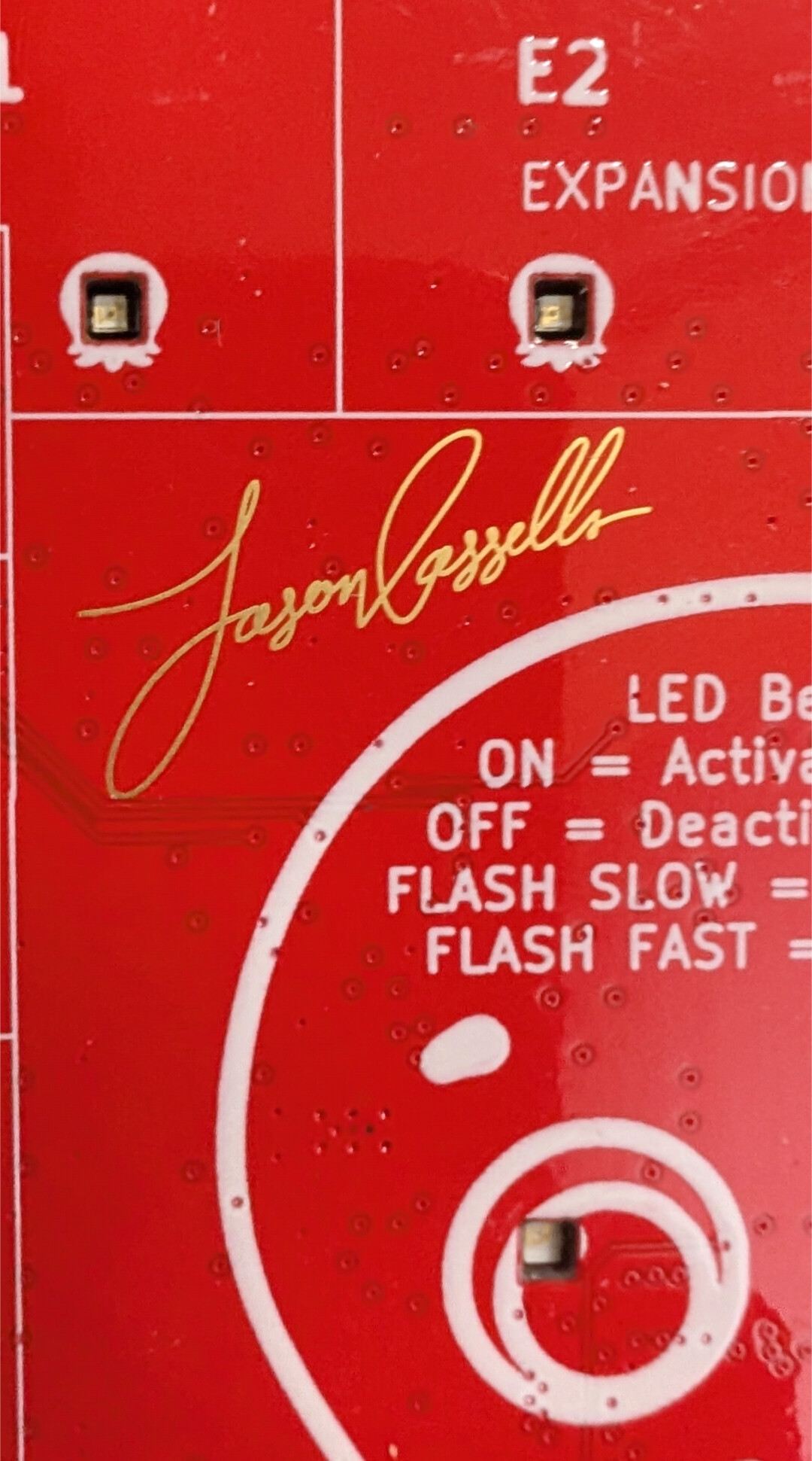

**Author:** ![Swwils](https://community.openenergymonitor.org/user_avatar/community.openenergymonitor.org/swwils/32/21026_2.png) [@Swwils](https://community.openenergymonitor.org/u/Swwils)\
**Post date:** [7 May 2025 21:15 UTC](https://community.openenergymonitor.org/t/the-worlds-easiest-octopus-heat-pump-install/27733/66 "2025-05-07T21:15:08Z")

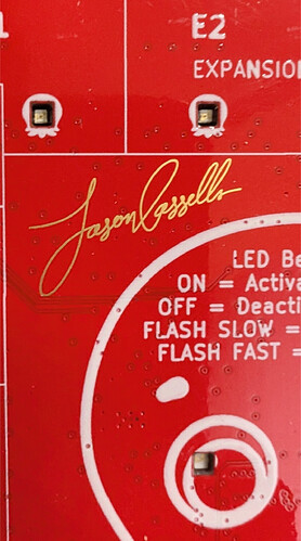

Reading various labels…
USB C diag port.
Internal modbus.
CAN bus.
Lots of 10k NTC. Some clipped, some in solder pockets.
Inverter VFD seems to be a ED3 from emerson so I would guess that means it’s an Emerson Copeland scroll compressor. 👍
SIKA flow sensor.
Some lovely lovely Easter eggs.

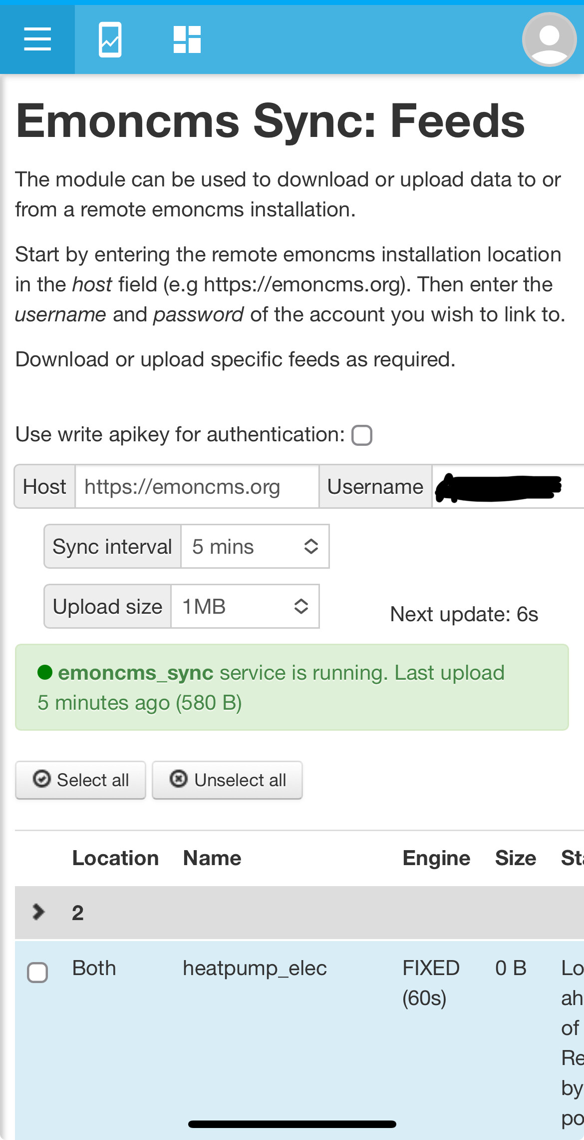

**Author:** ![agileoctopus](https://community.openenergymonitor.org/letter_avatar_proxy/v4/letter/a/85f322/32.png) [@agileoctopus](https://community.openenergymonitor.org/u/agileoctopus)\
**Post date:** [15 May 2025 19:58 UTC](https://community.openenergymonitor.org/t/the-worlds-easiest-octopus-heat-pump-install/27733/71 "2025-05-15T19:58:47Z")
Sync the feeds from your local instance to [emoncms.org](http://emoncms.org), set up the app on there, then make public. You need credits on there from the shop. If you bought kit from them, you’ll have got some credits free. Sign into [heatpumpmonitor.org](http://heatpumpmonitor.org) with emoncms credentials and fill in the form under My Systems.
 ![image](https://community.openenergymonitor.org/uploads/default/original/3X/d/0/d007f991a84c460044b1bd78a18430ee78182279.jpeg)

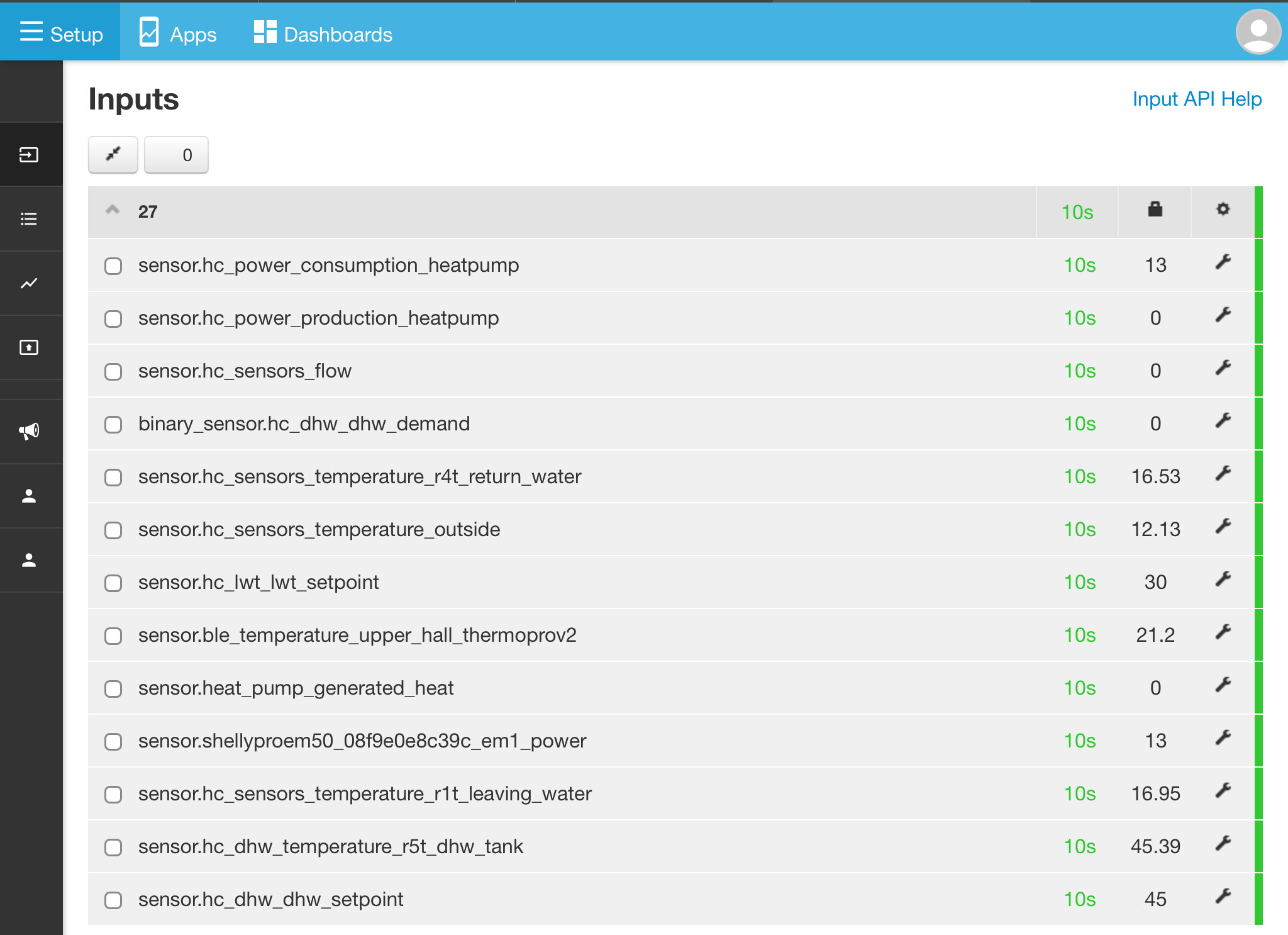

**Post date:** [16 May 2025 10:28 UTC](https://community.openenergymonitor.org/t/the-worlds-easiest-octopus-heat-pump-install/27733/72 "2025-05-16T10:28:50Z")
OK I got it working.
I don’t have a outdoor temp sensor in the emonpi, I also can’t the Cosy 9 temp sensor into emoncms.
I have it as a sensor entity in HA thats working, but I cant work out how to add an inputnode to write the sensor to emoncms for use on the app.
**Post date:** [16 May 2025 10:50 UTC](https://community.openenergymonitor.org/t/the-worlds-easiest-octopus-heat-pump-install/27733/73 "2025-05-16T10:50:44Z")
Cool. emoncms history integration will enable you to send the outdoor temp sensor straight from HA to [emoncms.org](http://emoncms.org). You have to configure it via YAML with your emoncms API key.
**Post date:** [16 May 2025 10:59 UTC](https://community.openenergymonitor.org/t/the-worlds-easiest-octopus-heat-pump-install/27733/74 "2025-05-16T10:59:54Z")
Yeah ive tried but I cant get it to work. I can’t seem to generate a new inputnode for it.
```auto
emoncms_history:
  api_key: *****************************************
  url: https://emoncms.org
  scan_interval: 30
  inputnode: 19
  whitelist:
    - sensor.octopus_energy_heat_pump_ ********************** _live_outdoor_temperature
And I dont see any new inputs in emoncms.

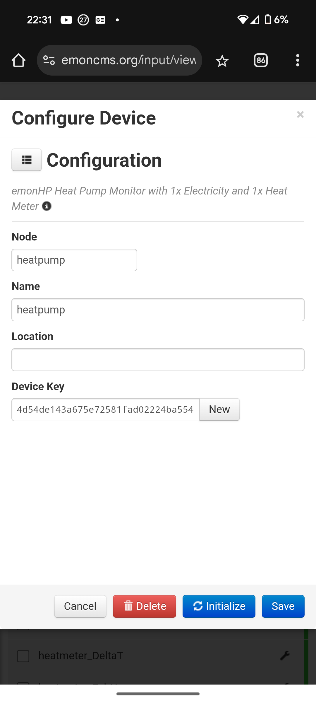

**Author:** ![mcwill](https://community.openenergymonitor.org/user_avatar/community.openenergymonitor.org/mcwill/32/33817_2.png) [@mcwill](https://community.openenergymonitor.org/u/mcwill)\
**Post date:** [16 May 2025 20:26 UTC](https://community.openenergymonitor.org/t/the-worlds-easiest-octopus-heat-pump-install/27733/75 "2025-05-16T20:26:27Z")
You are adding it to InputNode 19, is that the node number of the “heatpump” input group?
Have you expanded that group to see if it has appeared there?
 ![IMG_0128](https://community.openenergymonitor.org/uploads/default/original/3X/2/d/2d62403e25841847dfc9102b2806770b0880aa8a.jpeg)
**Post date:** [16 May 2025 20:41 UTC](https://community.openenergymonitor.org/t/the-worlds-easiest-octopus-heat-pump-install/27733/76 "2025-05-16T20:41:01Z")
I don’t know the node id of heatpump
It’s not appeared. 😭
**Post date:** [16 May 2025 20:47 UTC](https://community.openenergymonitor.org/t/the-worlds-easiest-octopus-heat-pump-install/27733/77 "2025-05-16T20:47:03Z")
As an alternative: Configure the local emonpis MQTT server in Home Assistant and push the data via MQTT to the emonpi. Alternatively usethe Node-REad addon for HA which can easily dend any HA sensir via MQTT so it appears in emoncms. The latter is the approach I’m using. Currently on the road but happy to provide mire info if needed when I return.
**Post date:** [16 May 2025 21:00 UTC](https://community.openenergymonitor.org/t/the-worlds-easiest-octopus-heat-pump-install/27733/78 "2025-05-16T21:00:49Z")
Click the cog on the right of the Heatpump node
**Post date:** [16 May 2025 21:32 UTC](https://community.openenergymonitor.org/t/the-worlds-easiest-octopus-heat-pump-install/27733/79 "2025-05-16T21:32:12Z")
It’s not there just a key that’s not an int
 ![Screenshot_20250516-223111](https://community.openenergymonitor.org/uploads/default/original/3X/e/e/ee4b361d5f1919b684aaf749793525a30aa2899a.png)
**Post date:** [17 May 2025 05:24 UTC](https://community.openenergymonitor.org/t/the-worlds-easiest-octopus-heat-pump-install/27733/80 "2025-05-17T05:24:49Z")
Looks like your node id is heatpump, maybe try that instead of 19.
