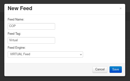

On the emonCMS feeds page, scroll to the bottom and click on New feed. In the dialogue that opens, select the VIRTUAL Feed engine, enter a Feed Name and (optionally) a Feed Tag, e.g:
 ![](https://community.openenergymonitor.org/uploads/default/original/3X/0/7/07af1923dc90aa807706648036557503e6d687f6.png)
Save, and you should now see the new Virtual Feed in your feed list.

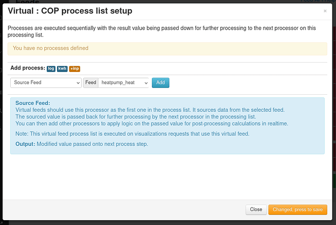

Click the box in front of your new Virtual Feed and the menu at the top of the page will expand. To add the processes, choose the spanner icon. The feed process list configuration dialogue appears:
 ![](https://community.openenergymonitor.org/uploads/default/original/3X/a/7/a7b72de1ded36de1f1685e7cd0b448d6f8592681.png)
Select the Source Feed process and select the “heatpump\_heat” feed from the drop-down list, and Add.
Then select the ‘/ source feed’ process (divide by specified feed) and select the “heatpump\_elec” feed and Add:
 ![](https://community.openenergymonitor.org/uploads/default/original/3X/3/3/33f745b9d8dad7a92732bcea484add4fc91724dc.png)

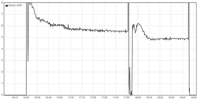

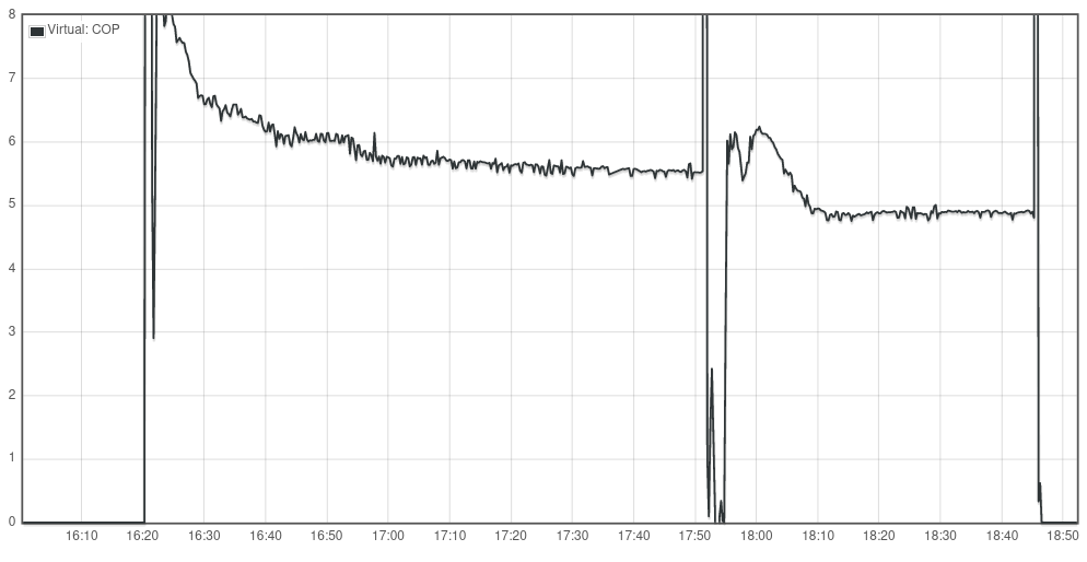

Click ‘Changed, press to save’ and then open the Virtual Feed in the graph view. If you are calculating CoP you may want to set minimum and maximum limits on the y-axis as the calculation can momentarily go off the scale when the compressor starts and stops:
 ![](https://community.openenergymonitor.org/uploads/default/original/3X/0/3/036fc3951497e60260555bd7db556f49af32fe99.png)
The CoP calculation here is done on the fly from the underlying heat output and electricity consumption feeds. The Virtual Feed does not use any additional disk space, and because of this, Virtual feeds created on [emoncms.org](http://emoncms.org) are free, they are not included in the pay-per-feed billing.

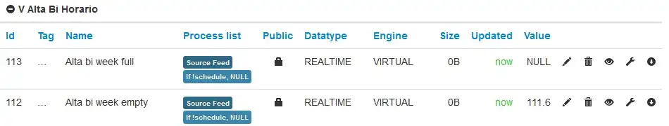

Here is an example of how to use a virtual feed and Multigraph to highlight energy used at different times of day. The feeds for measured power and the schedule already exist.
Create a virtual feed for each rate schedule, to receive data when the schedule is true, all using the same source feed data (measured power). The schedules should together exactly cover the time period (day, week etc) and not overlap:
 ![](https://community.openenergymonitor.org/uploads/default/original/3X/e/f/ef4c5c8a9fbb8b2a6cfb4940aca45fedaa56b793.webp)
And the resulting Multigraph shows the measured power for each schedule in a different colour :
 ![](https://community.openenergymonitor.org/uploads/default/original/3X/c/f/cfd1c58c6817aed6fcd64871ea520e4af2fcb333.webp)
The above example came from Chaveiro’s original post announcing Virtual Feeds, unfortunately without the Multigraph settings.

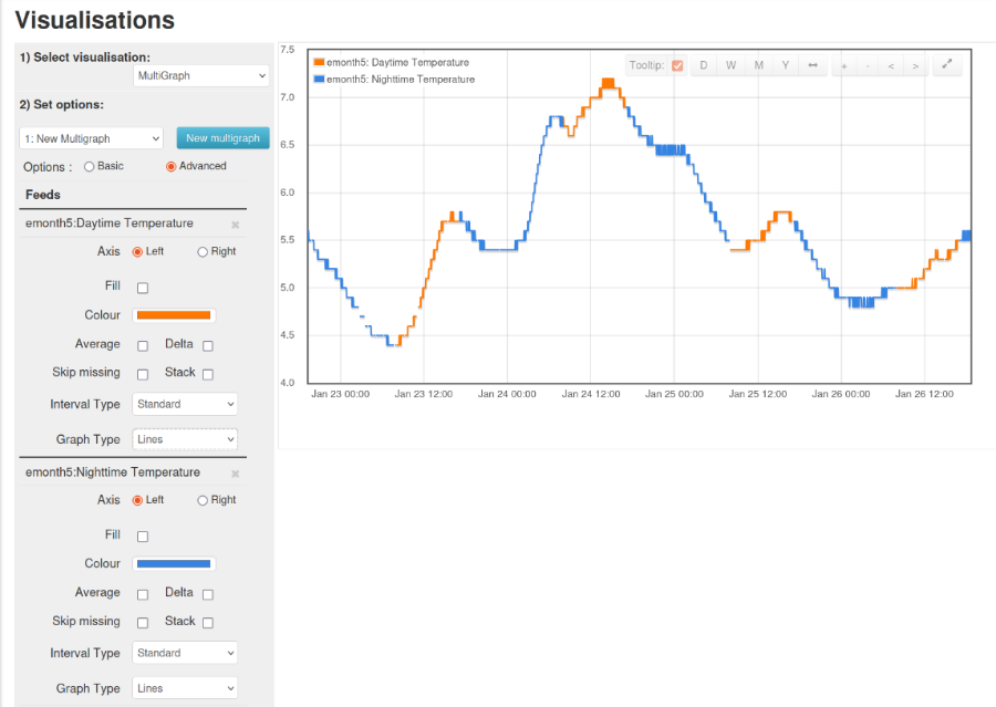

Here is another example, this time using a single schedule to indicate from 8 am until 5 pm is ‘daytime’ and everything else is ‘night time’. Take care with the negative logic. The Virtual Feeds look like this:
![](https://community.openenergymonitor.org/uploads/default/optimized/3X/f/b/fb05a5dda09eb30fa6e74d3741541c51ab993180_2_690x70.png)
and the Multigraph visualisation settings and the graph they produce:
 ![](https://community.openenergymonitor.org/uploads/default/original/3X/b/8/b8ec7c8aac3ce13974153784fcd0d00adec6fb8a.png)
