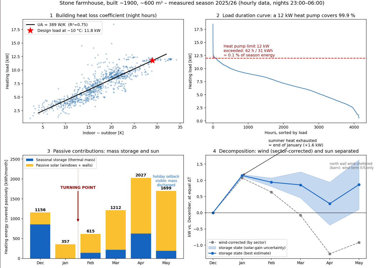

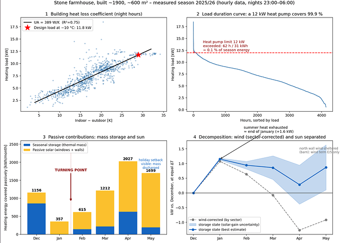

**Post date:** [16 August 2026 15:56 UTC](https://community.openenergymonitor.org/t/the-house-that-couldn-t-have-a-heat-pump/29921/12 "2026-08-16T15:56:26Z")
Fascinating thread, i though i was alone with my experiment to try to run a non-suitable house on heat pump.
My house has 600m2 living space. Built 1900 in Switzerland at 800m height. The climate in comparison has a mean of -6° in comparison to Scotland. The Roof was isolated with 18cm, the windows changed 30 years ago. Wall insulation is impossible, it would destroy the outer appearance of this house. 65 cm Stone Wand. Oil heating Valiant 24KW.
We installed 25 years ago a thermic sun installation 30m2, with a 3’800l tank.
Without solar thermic, the oil consumption is 5’000l/year, with 3’800l/year. Still a lot.
But normally in my region, with the assumption from partly isolated houses, the consumption is 110-140Kwh/m2/year. I’m at 75 (assuming 90% efficacy of the oil heating). It confirms what the author of the threads write, the official assumptions are wrong. But why, the author thinks the isolation is better than naked stone. I have an alternative hypothesis.
The story is that i wanted to install a heating pump, but not with a bad COP. And i made a few subjective observations:
- If i use a steeper heating curve, i had the impression the extra power just disappear in the short term
- I had the impression the house is keeping the summer heat through the beginning of the winter
This gives the idea i could use a high inertia house to have a better COP
Therefore, i conceived with the help of an AI a program to run the heating curve differently than usual.
As the author i use an ESP32, Home Assistant and a raspberry to host locally the HA.
The regulation is the following:
- If a cold period is announced in the meteorologic prevision. The T° of the Inlet heating is augmented. The idea using a good COP period to load with thermal energy the house.
- Doing exactly the contrary if a warm period is coming.
- Lowering the outlet Temperature if a sunny day is coming, using the passive heating through the windows and the wall.
- Using the lowest possible heating curve (determined by testing)
- All thermostats are fully open to assure a constant flow in the heating circuits (entirely different from the author)
The sensors:
- T° sensor 10cm in the outside wall.
- T° sensor on the in an outlet from the heating circuit
- T° in different rooms
- T° outside, wind and sun protected
Then, i have simulated a heating pump, letting my oil heating running exactly with the inlet temperature as a heating pump would do. And calculating the theoretical COP from the inlet temperature and outside temperature.
The result is:
- COP 3.7
- -59% in costs
- From 80Kwh/m2 to 17 Kwh/m2 (this is the huge number)
**Author:** ![Jacques\_x](https://community.openenergymonitor.org/user_avatar/community.openenergymonitor.org/jacques_x/32/37840_2.png) [@Jacques\_x](https://community.openenergymonitor.org/u/Jacques_x)\
**Post date:** [16 August 2026 18:07 UTC](https://community.openenergymonitor.org/t/the-house-that-couldn-t-have-a-heat-pump/29921/13 "2026-08-16T18:07:01Z")
But the analysing of the sensors provides another insight. The idea of seasonality is real.
The first graph shows the relationship between the difference outdoor indoor temperature vs heating power, seems on a regression line.
But it is not correct. If i decompose it for every month this relationship, it is not constant. In fact clearly they is a carry over from the summer and i refined the analysis with the passive sun contribution.
And this gives an interesting picture:
- Until January the house is using the energy stored during the summer.
- Then the sun begins to load the house
- It represents like 10’000KWh a season
