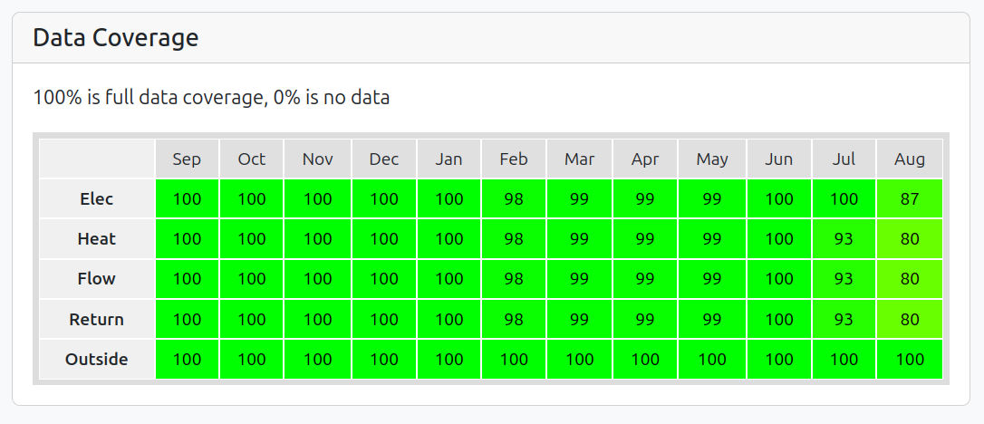

What does quality_* measure, on what scale , completeness, or plausibility too? (With the concrete version: would a sensor reporting an impossible value consistently still score high?)

Quality is purely a null count / total data points count for a feed app/apps/OpenEnergyMonitor/myheatpump/myheatpump_process.php at master · emoncms/app · GitHub
Yes all °C
The quality fields are used for this ui element on the system view page, which has a better title “coverage” rather than quality.
E.g: https://heatpumpmonitor.org/system/view?id=748
