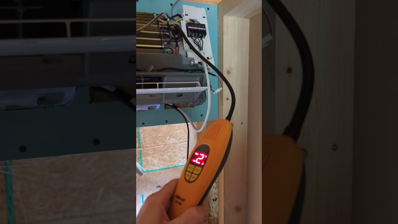

Not all is plain sailing mind.
Bolt it in. Flare up the pipework. Hook up the wires. Light the woodburner to warm up the indoor unit so that moisture evaporates at a sensible temperature. Vacuum it down. Release the refrigerant. Leak check.
Balls. Thought I’d made a bad flare until I realised that the unit was leaking from an internal braze (and the gas coming down the insulation sleeve) rather than my flare:
[![](https://img.youtube.com/vi/_15Dsbf-jGQ/maxresdefault.jpg "6 November 2023") ](https://www.youtube.com/watch?v=_15Dsbf-jGQ)
Those sniffers detect leaks down to 3g/year. (about what leaks from a car AC compressor rotating seal even by design). Cracking bits of kit for £60 or so. Don’t bother with soapy water etc. Nitrogen pressure test is nicer but lots more kit to have for the odd installation; and wouldn’t have made identifying the location of the (tiny) leak and showing it to the supplier easy.
Shut the liquid line, fun the split in full cooling override until you’ve drawn the refrigerant back into the outdoor unit, shut the vapour line and knock the power off. Call the supplier.
Local distributor to be fair took one look at the vid and asked whether I’d like to pickup a new indoor unit myself or for them to come swap it and weight out the refrigerant/weight in the correct amount in the event that a material quantity had leaked.
Not easy then but can’t grumble at that on a €630 widget.
Shouldn’t really do that in the UK because F-Gas regs. (you need a certificate to know that you shouldn’t let all the gas out before you’re allowed to touch these) Rest of Europe and the USA are less fussed. Can buy the units and the kit to fit them properly at B&Q. Don’t be irresponsible though and do get the tools including one of those heated diode detectors if you are fitting them.
