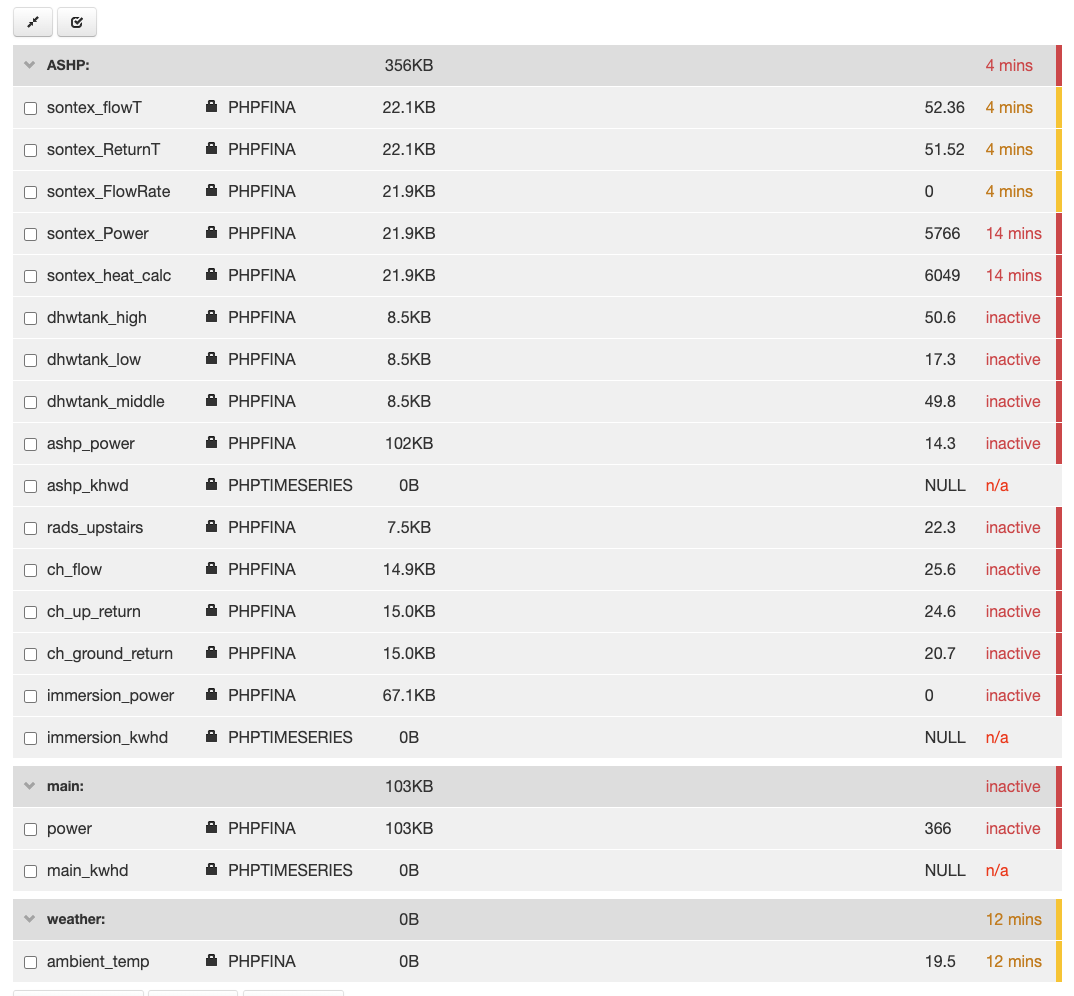

HI,
I am looking to sync my emonpi (running local emoncms install) with [emoncms.org](http://emoncms.org) to contribute to [heatpumpmonitor.org](http://heatpumpmonitor.org).
The two emoncms instances connect fine and I’m able to transmit feeds manually by hitting ‘upload’ on the local copy - however i can’t see how to sync on an ongoing basis?

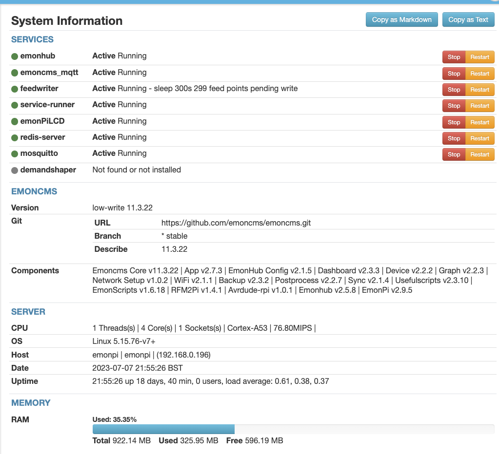

ServiceRunner appears to be running fine along with all other services (screenshot below) - i’m running v11.3.22
I have been reticent to post this issue as I have to think there is something very basic that I’m doing wrong. Could somebody point me in the right direction please? Screenshots below and big thanks in advance.
Local emoncms after hitting upload on first three feeds.
 ![image](https://community.openenergymonitor.org/uploads/default/original/3X/6/2/6204f961476bd7ea5ae4df004953b1534c1a41ac.png)
[Emoncms.org](http://Emoncms.org) after a manual sync
 ![image](https://community.openenergymonitor.org/uploads/default/original/3X/9/b/9b710da132d49c49b7e3b83638dd90aed08c8f9f.png)
Admin on Emonpi. The FeedWriter is showing the pending write…
 ![image](https://community.openenergymonitor.org/uploads/default/original/3X/d/4/d47eaee3796178414ea9c86839ec25ee256edda9.png)
**Post date:** [8 July 2023 12:19 UTC](https://community.openenergymonitor.org/t/syncing-with-emoncms-org/23869/2 "2023-07-08T12:19:23Z")
Hello Ben
You can set up a sync module cron upload to do this automatically. Start by logging in to your Pi using SSH. Then open crontab:
crontab -e
add the line:
45 1 * * * php /opt/emoncms/modules/sync/sync_upload.php > /dev/null
that will upload your latest feed data to the configured remote server at 1:45am every morning, please select a random time (or times) so that we don’t get everyone uploading at the same time.
This will upload only the feeds that you have already started to upload via a manual sync.

**Post date:** [21 August 2024 17:22 UTC](https://community.openenergymonitor.org/t/syncing-with-emoncms-org/23869/6 "2024-08-21T17:22:23Z")
A new version of the emoncms sync module is now available that uploads data in a much more efficient way and removes the need for the crontab entry above, replacing it with a background service. I would recommend updating to use this new version, please see release post here: [Emoncms Sync module v3.x.x](https://community.openenergymonitor.org/t/emoncms-sync-module-v3-x-x/26599)
