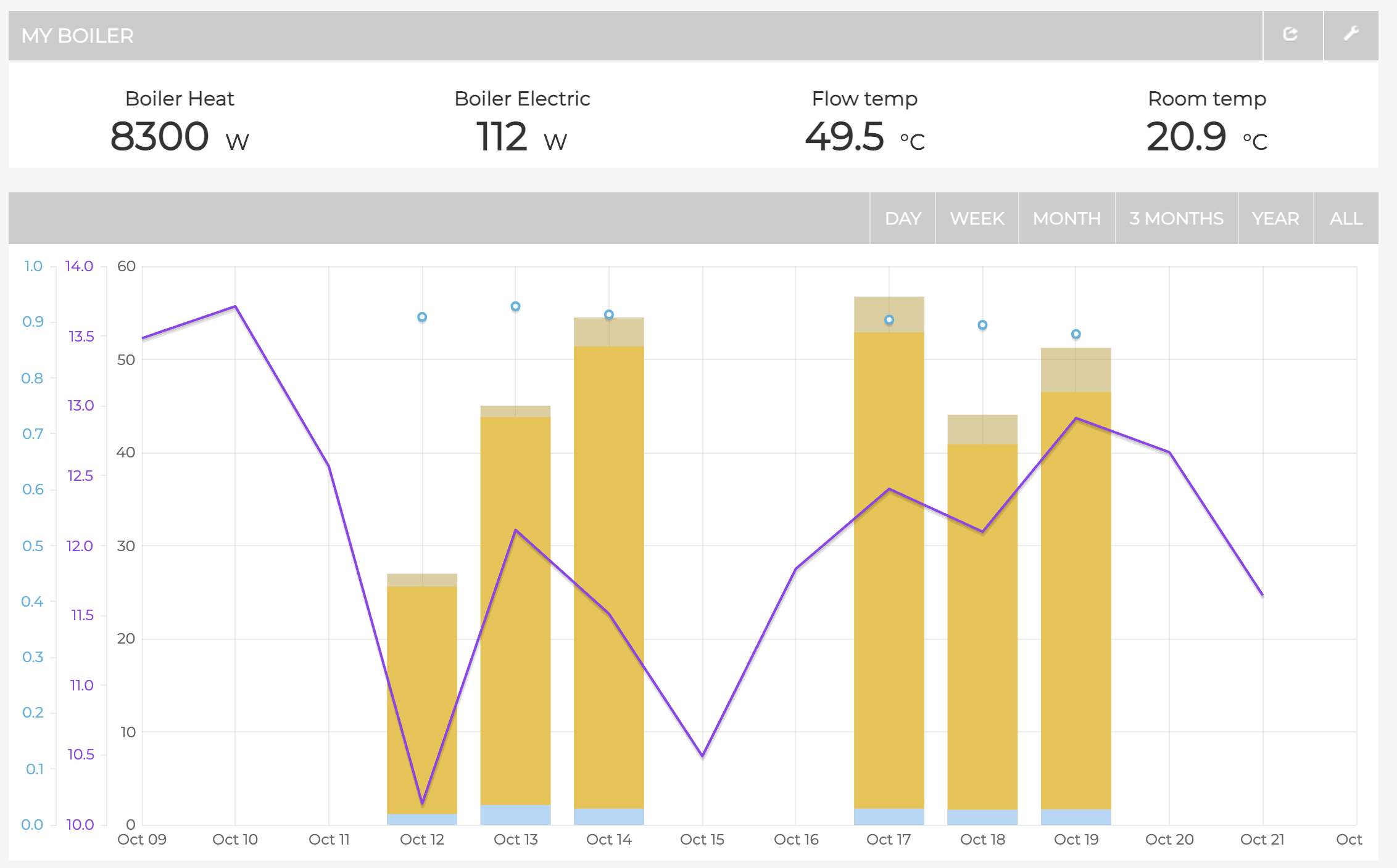

Hi folks
I’ve been uploading my gas boiler data from Home Assistant for a while and I can see all of the data arriving in [Emoncms - app view](https://emoncms.org/app/view?name=MyBasingstokeBoiler&readkey=f3e7a02a8b94cd9d91d5c66a3bf2b603) . However, on a few days I’m missing the summary bar graph. e.g. below. What is causing the gaps? I’ve checked and can’t see any missing info on the uploaded data graphs. Any advice would be very welcome. Cheers.
Tim R
 ![Screenshot 2025-10-21 at 11.52.05](https://community.openenergymonitor.org/uploads/default/original/3X/e/7/e7055febcb837a90425c79f12869f4cbd0436164.png)
**Post date:** [21 October 2025 14:22 UTC](https://community.openenergymonitor.org/t/summary-bar-graphs-missing-on-a-few-days/29276/2 "2025-10-21T14:22:50Z")
Hello @gr0mit I’ve just fixed the energy feeds for you, they needed recording using “log to feed (join)”, this joins across small gaps in the data. The missing bars result from null values in the kWh data at midnight, log to feed join removes these
