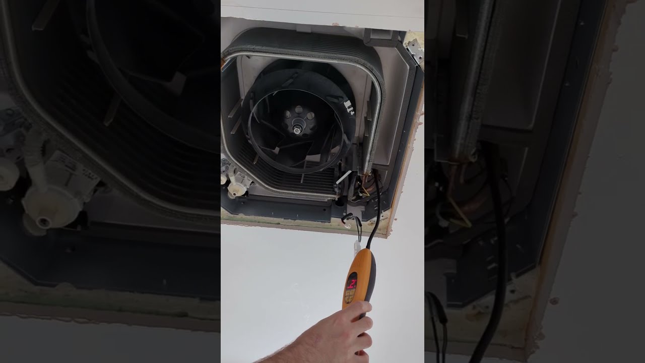

Father went for a Mitsi FDTC60VH ceiling cassette (fits between 650 space ceiling joists) in the hall to try cool the whole house without wall units. Unimpressed by this. Expensive. Naff controls. Noisy. The evaporator coil leaked like a sieve a little after a year of operation. Not installed by the premium tier installer means 1 year warranty and you don’t want to know what “office” type AC parts cost out of warranty. Uneconomic to repair.
[![](https://img.youtube.com/vi/gPj85XqzJso/maxresdefault.jpg "Leak from brazing on Mitsi Heavy FDTC60VH coil") ](https://www.youtube.com/watch?v=gPj85XqzJso)

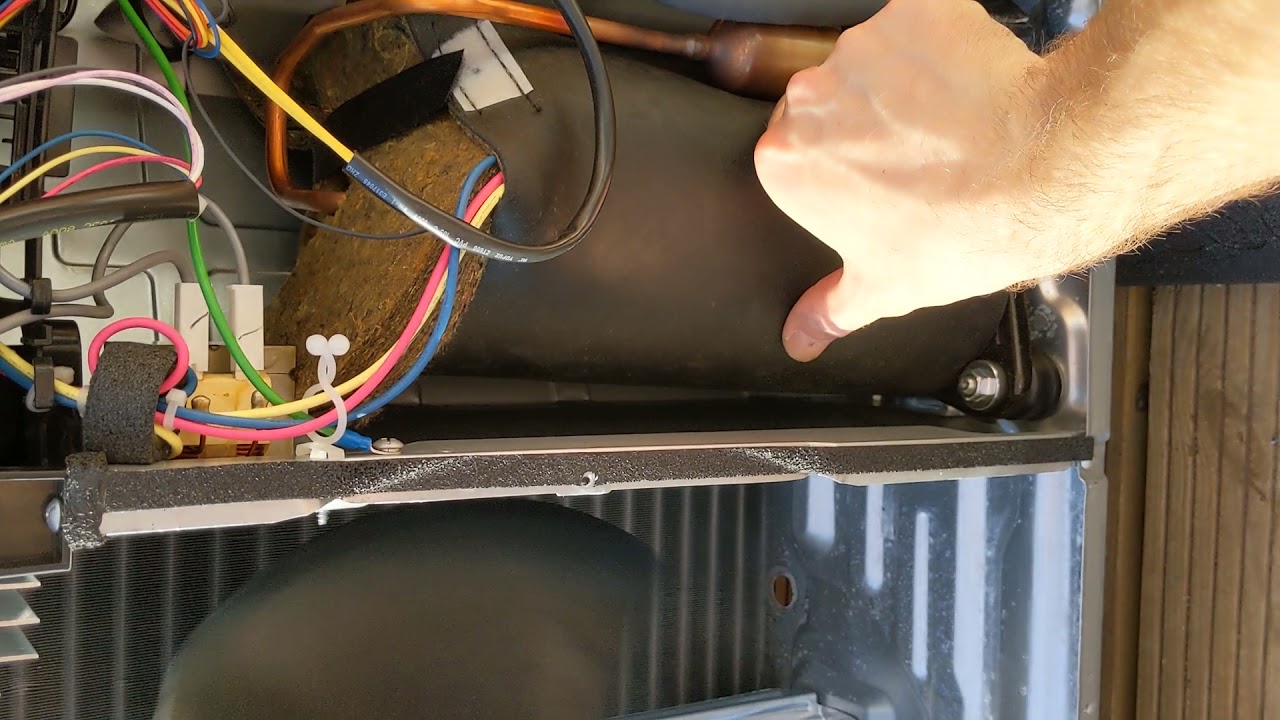

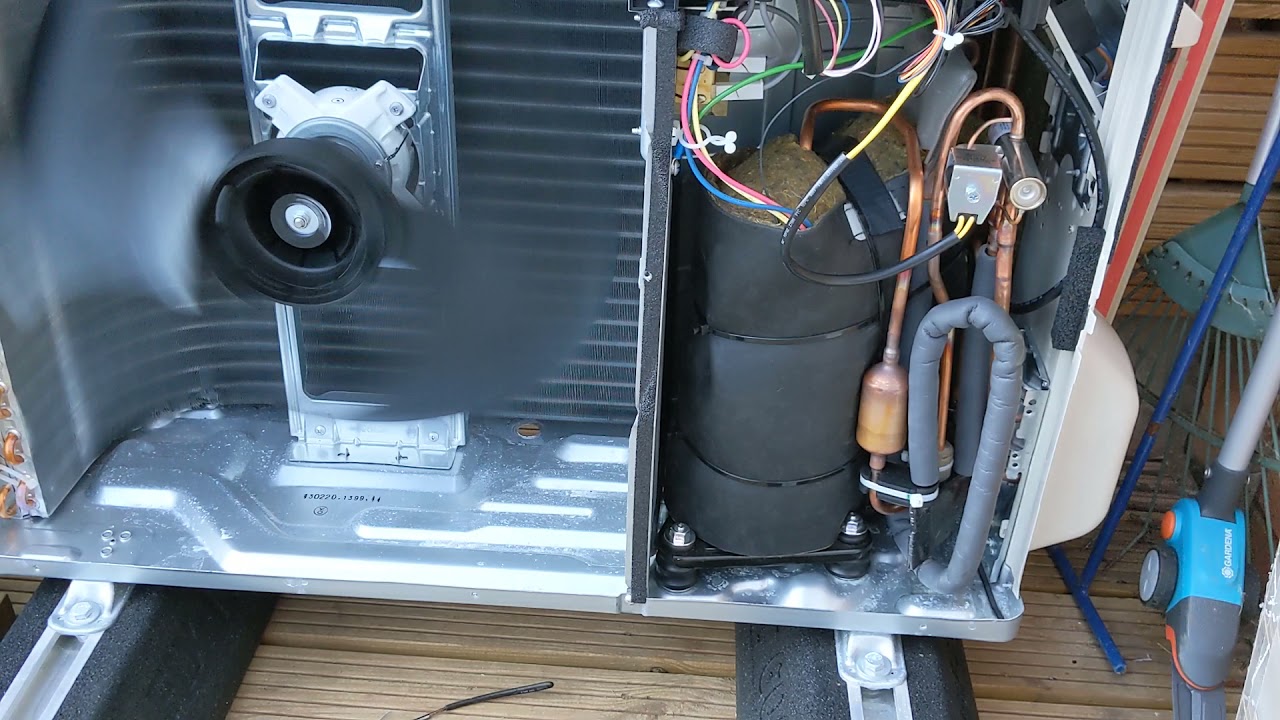

I’ve also gone el cheapo with another Midea Xtreme save; this time a little 2.5 kW split so that it runs the coil cooler and dehumidifies more aggressively than the 3.5 kW unit; in the cabin. Again a £15 ESP32 dongle for control.
It was intended for occasional cooling and does that nicely but has actually been used as much for heating (frost protection mode at 8C, or indeed occupied at 20C). No electronic expansion valve etc on these; just inverter drive and an orifice tube. I was dubious how they would perform. At -10 degC it will happily maintain +20 degC inside. At -25 degC it will happily maintain +8 degC inside. (I was moderately worried about tripping on minimum temperature but no) Defrosting is brutally frequent nearer 0 degC; not so frequent when it really gets cold; and noisy as it comes (lots of whooshing of refrigerant through lines as reversing valves do their thing)
This also had bad brazing on the evaporator coils. (cheap heated diode F-Gas sniffer purchased for leak detecting the car AC but will sniff down to 3 grams/year)
[![](https://img.youtube.com/vi/_15Dsbf-jGQ/maxresdefault.jpg "6 November 2023") ](https://www.youtube.com/watch?v=_15Dsbf-jGQ)
No questions asked by Midea. "Hello, see Youtube link for problem. “Oh. That’s not right. When can we come and install a new one?”
