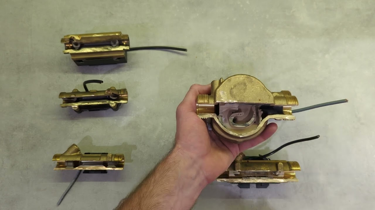

If the old meter body “did have some dirt” that is definitely a problem for your system in general. (there shouldn’t be any)
I would waegr that it’s probably also a problem for the Sontex meter in particular as these rely on vortex-shedding, vortex-shedding relies on sharp edges and strong reflections amongst other things, and dirt in our meter is probably gong to soften all those / reduce vortex shedding frequency / cause under-reporting of flow.
If it were mine I would isolate, pull the thing to bits (you can dismantle the flow sensing element on these), and physically inspect for muck in the pressure ports to rule that out.
Here’s what one looks like inside: (the little holes are the pressure ports to the pressure transducers that are looking to sense the vortices as these are shed from the assembly designed to create/reflect these - see Sontex Superstatic 749 Fluidic Oscillator Heat Meter - YouTube for the flow patterns that crate pressure changes that the meter picks up)
Vs an ultrasonic meter of the “external transducer and mirror” style: (signal shoots across the pipe, hits the mirror, along the pipe, hits the mirror, then to the other ultrasonic transducer) Very important on these that the transducers are on the SIDE of a pipe if mounted horizontally not on the top (air) or bottom (dirt). There’s really nowhere for any dirt to settle here.
Or an ultrasonic meter of the “inline transducer” style: (signal shoots along the pipe between the two transducers) Orientation is less critical for this style and again there’s really nowhere for any dirt to settle here.

If anything I think they’re the most sensitive type of meter to dirt.
Air less so. The vortex shedding and pressure sensing elements can handle some entrained air.
Dirt (sediment) I’d say there’s plenty more scope for mischief for these non-ultrasonic meters than the ultrasonic types.
Photos in post above.
Hello @marko those are really interesting cut through pictures and insights on dirt vs air, thanks for sharing!

No worries on cut throughs. Sometimes it’s easier to take the 4.5" electric spanner to something than to describe it in words.
(the day job is heat metering and much time is spent on the various ways the real world differs from lab conditions - should write a cheat sheet at some point as time allows)

FWIW @dfeist - I’ll do a proper version in due course but perhaps this gives some better idea:
Unless your Sontex meter is mounted with the flow going DOWN I can’t really see anywhere for the muck to accumulate. If they’re mounted horizontally (with the pressure sensor on top) or vertically (flow going UP) there shouldn’t be anywhere that muck can sit.
If it is mounted with the flow going DOWN then you could be accumulating muck in the chamber that the oscillations are supposed to occur in. This won’t be visible with the top remove though. You’d have to cut the thing open to see it. (or rinse in clean fluid and measure the sediment later)
