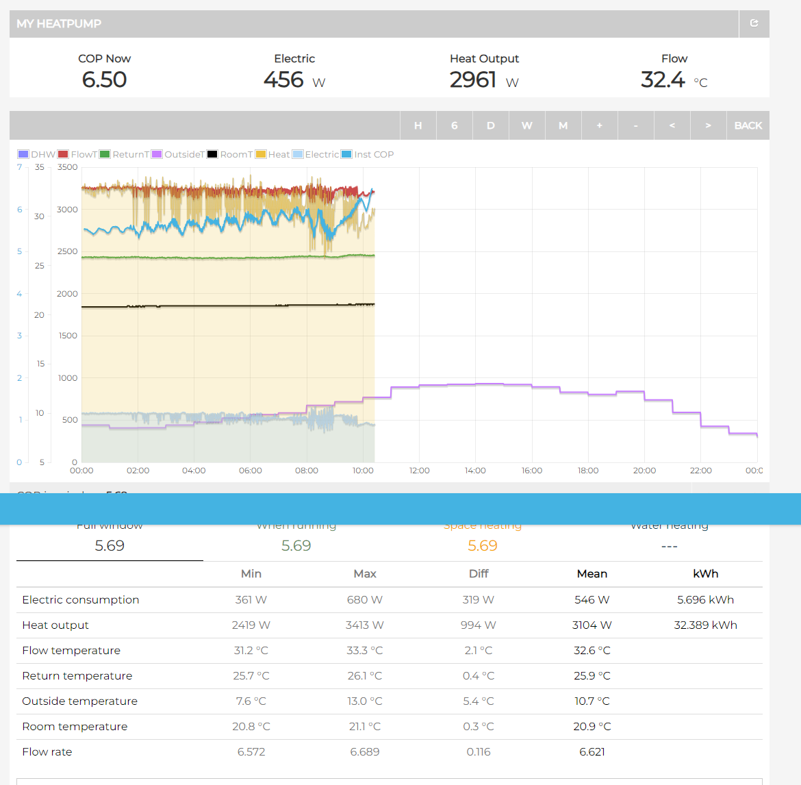

thought i would share my system on this thread
also a octopus heat pump install which had a 9 kw Daikin installed but the survey was terrible , now we have a 6 kw heat pump installed now and is working better
please read the notes on my system to give you better insight
[https://emoncms.org/app/view?name=My%20HeatPump&readkey=1da9e37af3d5ac9669792233ea85675c](https://emoncms.org/app/view?name=My%20HeatPump&readkey=1da9e37af3d5ac9669792233ea85675c)
have you tried to turn off the modulation ??
I’m
Using espaltherma , with a independent power meter
the system does seem to run smoother occasionally , but then after changes in the mmi is disrupts it again ,
Or unstable after a hot water cycle

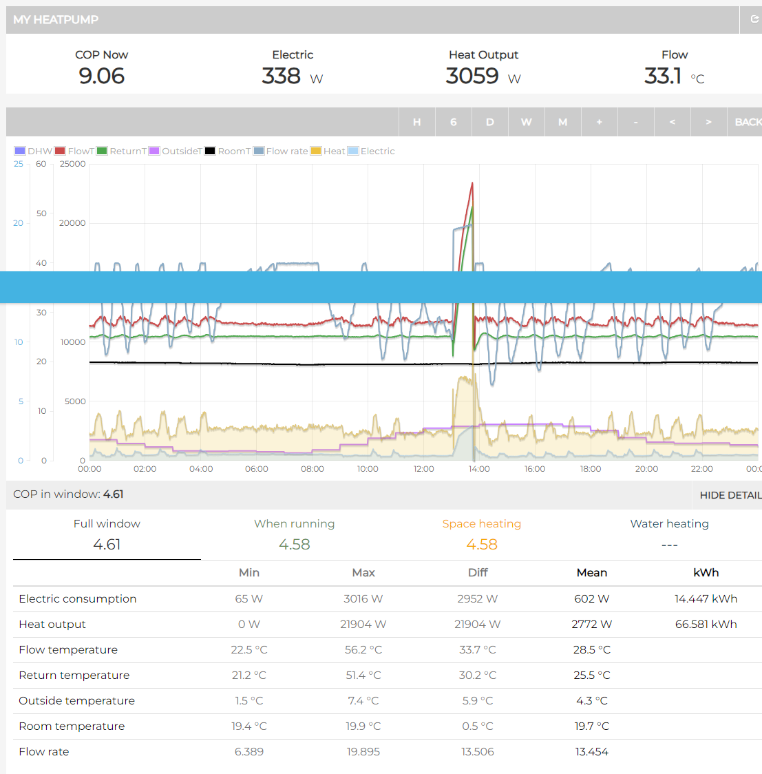

**Author:** ![matt-drummer](https://community.openenergymonitor.org/letter_avatar_proxy/v4/letter/m/e0b2c6/32.png) [@matt-drummer](https://community.openenergymonitor.org/u/matt-drummer)\
**Post date:** [5 December 2024 09:35 UTC](https://community.openenergymonitor.org/t/something-has-gone-quite-wrong-with-my-8kw-daikin-today/26702/174 "2024-12-05T09:35:27Z")

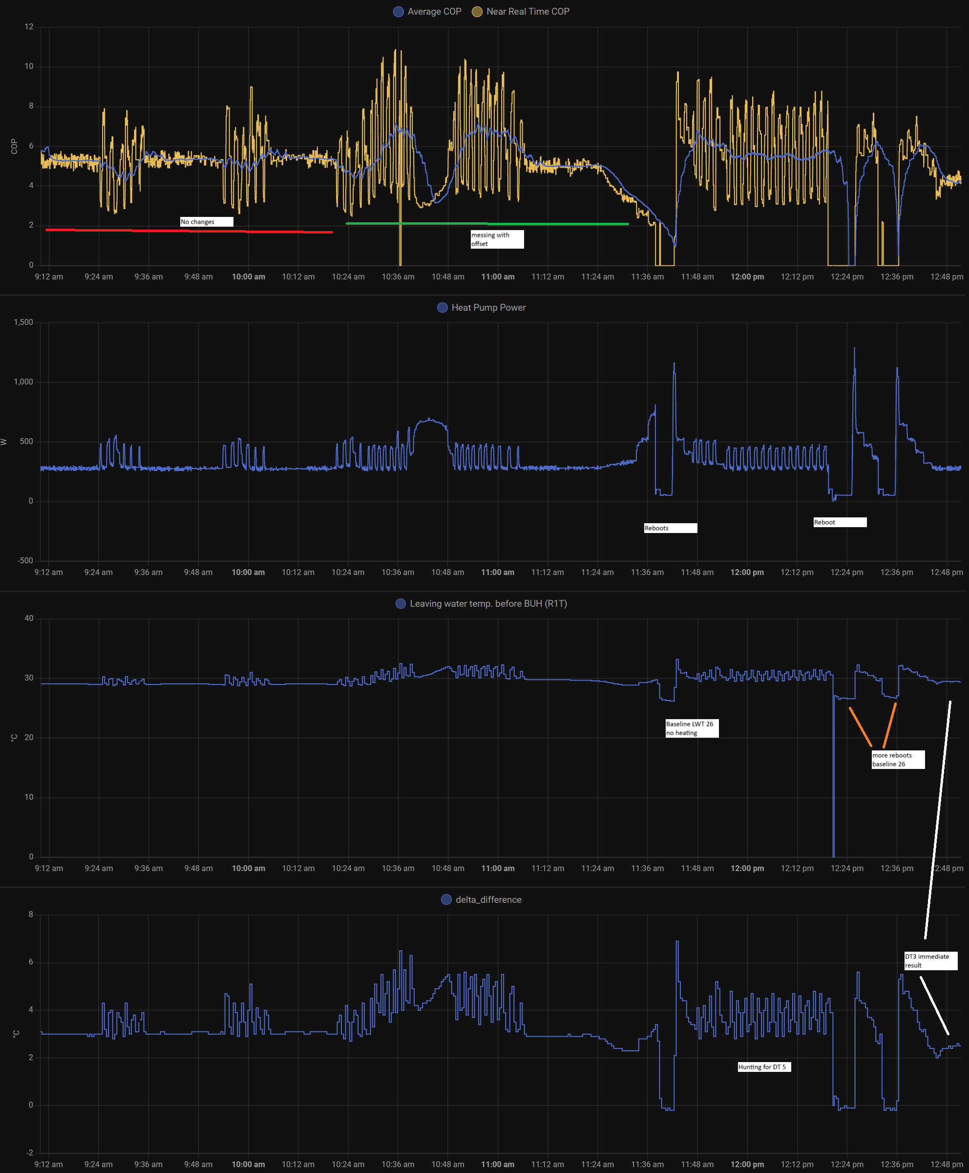

So here is a good example of how bewildering I find this heat pump.
It is today. Maybe @johncantor has a better idea of what is going on but I will say what my diagnosis is.
 ![image](https://community.openenergymonitor.org/uploads/default/original/3X/b/5/b531cb50c0e14f2cd3132811b1b9afd60c7345e9.png)
The flow temperature is set at 32c. As it gets warmer outside something is causing the heat pump to become more and more unstable, either a direct result of the increase in outdoor temperature or something caused by my house because of the increase in outside temperature.
The flow temperature, electricity consumption and heat output are jumping about quite wildly and the efficiency is dropping even though the outside temperature is increasing.
I think that the heat pump has pretty much lost control of the flow of refrigerant and is really struggling. I always get the feeling at this stage that the flow temperature is now too low for the increased outside temperature and this is why I tend to run at higher flow temperatures when it’s warmer, not by much, but just enough to keep it more stable.
It’s relatively inefficient in the state it is now compared to when it is more stable.
This stops me running a wdc because I don’t need the lwt to be as high when it is colder outside as it needs to be when warmer.
And then I have to choose whether to have the heating on and accept too much heat or turn it off.
I can’t run a heating schedule without invoking Madoka control and I don’t want to do that because of the 2c hysteresis on the room temperature.
I have spoken to Octopus engineers about replacing the Madoka with something else and they suggest Tado but it involves running wiring to the heat pump. I have asked if Octopus can help.
And here it is about an hour later. It has now stabilised itself and the efficiency increases as we would expect.
It is pretty clear if you draw a straight line through the bright blue COP that the period of severe instability results in a significant drop in efficiency compared to stable operation.
 ![image](https://community.openenergymonitor.org/uploads/default/original/3X/4/5/45f99c08b74256d3f89d67cecbf09d1a155c1a08.png)

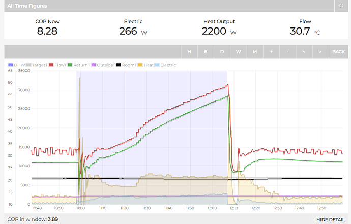

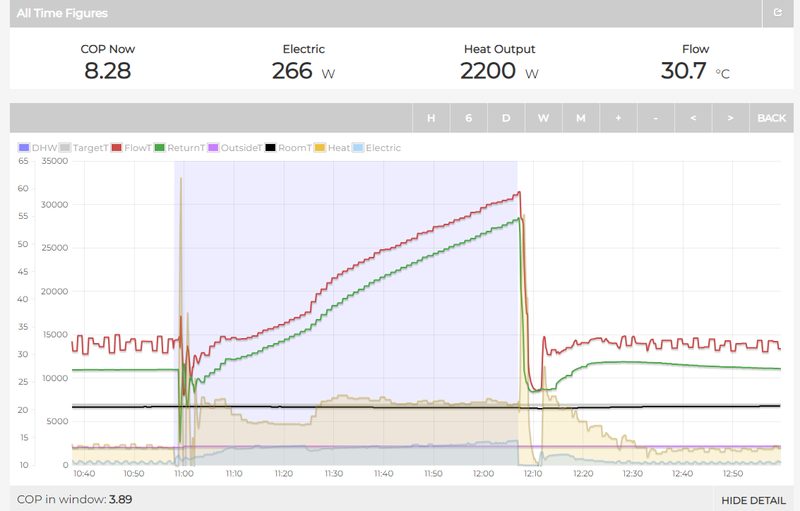

I am seeing the same thing, I have been moving the offset to see the results, Yellow real-time COP and Blue is an average COP over 5 mins.
I know its above and beyond what is expected of a home user but we are particular and like the data, I have implemented my own Ground floor temp control with Home Assistant - you can set your own hysteresis, set and target temp, cycle etc, you can use any temp sensors IP, Zigbee, Z-Wave place them around the house to get an average, it would cost less than £50 and a bit of time to get exactly what you want. Link to my trail below if anyone is interested?

I have a theory - my DT is set to 5, while messing around with the WDC the system reboots and I noticed the baseline flow of water after 6hrs of heating was 26, my WDC is set to 28 @ 10, the current outside temp is 11, so the system is targeting a LWT of 28, but it’s trying to maintain a DT of 5, so is overshooting (have set to 4) to 31 by increasing the power, then is steps back resulting in micro power bursts and a flow temp between 28 - 31, @matt-drummer I think ur DT is 8 is this too much for the logic within the SW at higher outside temps, what is your base flow temp without heating (turn of the heating and run a short air purge then measure 5 min job) does this match the LWT and DT of 8 or is it less?
I have just set my DT to 3 to see if I can get a steady power draw.
**Post date:** [5 December 2024 13:00 UTC](https://community.openenergymonitor.org/t/something-has-gone-quite-wrong-with-my-8kw-daikin-today/26702/179 "2024-12-05T13:00:50Z")
Hi Neil,
My dT is actually set at 10c because I run in the radiator setting.
I do this to keep the flow rate on the floor, it is the only way the flow rate remains anything like steady.
I can run at around 26/27 flow if I want but the heat pump is unhappy and inefficient.
I have tried dT of between 2c and 5c and none of them work as well as what I do now in terms of efficiency.
At lower dT’s I run into flow rate limitations, at a low dT the flow rate isn’t enough to get the required heat.
What I found was I needed different dT’s depending on outside temperature and it is not something I want to keep adjusting.
I also find that the flow rate varies wildly, it yo yo’s up and down, with a dT of between 3c and 5c.
I would have expected the heat pump to be able to settle on an appropriate flow rate to maintain the requested dT at a fixed lwt, but that is not what happens.
Here it is at a fixed flow temperature of 28c and a dT of 3c
 ![image](https://community.openenergymonitor.org/uploads/default/original/3X/3/a/3a9cbb7cf8979e52ffe9f07a32bf44ddd61325c0.png)
I find that my current way is most efficient and easiest to control despite the shortfalls.

And this is Zak’s dhw today.
Not a dT issue on space heating, just what I would consider to be abnormal behaviour, or maybe just normal now?

Just to add to the conversation I had my DT set to 3 earlier in the year and updated this to 5°c as the pump was running much faster and not able to maintain the DT easily and deliver enough heat (got a bit chilly when the temp dropped).
Having full radiators in theory according to Daikin we should be using DT10 but again I have tried this on my property and the outcome was not as good.
I am sure there has to be some way of taming this beast if Daikin are actually interested and it is not an “Undocumented Design Feature”.

My conclusion in terms of control is that there is too much going on.
When I invoke Madoka control with a wdc, overshoot and modulation, I end up with a heat pump that doesn’t really know what to do.
It’s trying to maintain a dT and varies the flow rate to do this at the same time as varying the flow temperature (because the outside temperature is changing and/or the room temperature is changing not enough or too much)
It’s too many variables and it just isn’t smart enough to deal with it at best efficiency because one or more things are never quite ideal.
Coupled with that, I have too much radiator capacity that takes the heat pump into areas that it can’t cope with, either flow temperatures that are too low or needing flow rates that are too high.
There isn’t one setting that works all year round. As Zak says, one day a dT of 3c is great, but then another day it won’t work as the pump can’t keep up.
And so with that, I might as well control it myself, not what I wanted, but my choice because I want it as efficient as possible, just because I can and I am too weak to resist the temptation.
