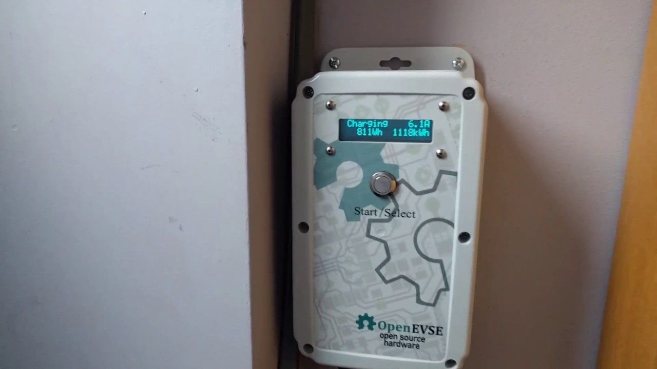

Here is latest example using ā€˜Eco modeā€™ to modulate charge rate based on solar PV output. All diversion calculations are done directly on the ESP (nodeRED not required). Solar data is coming from emonPi via MQTT (simulated in this example since I donā€™t have solar PV onsite and itā€™s raining!)
Voice control using Google Home and MQTT:

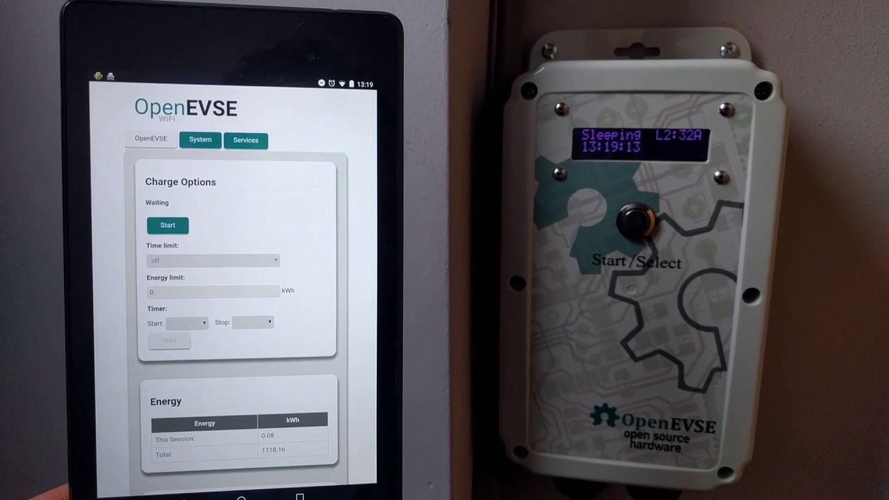

Web UI Demo:
