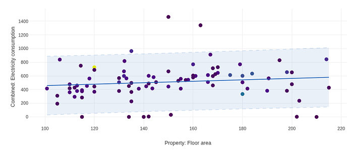

Data collected by [HeatpumpMonitor.org](http://HeatpumpMonitor.org) shows that that properties of a similar age and size have consumed between 400 and 800 kWh of electricity in December, so the figures you’ve shown do not look particularly high.
