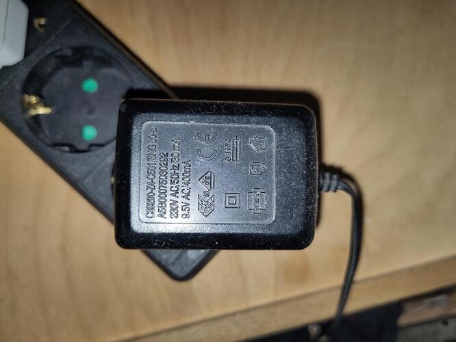

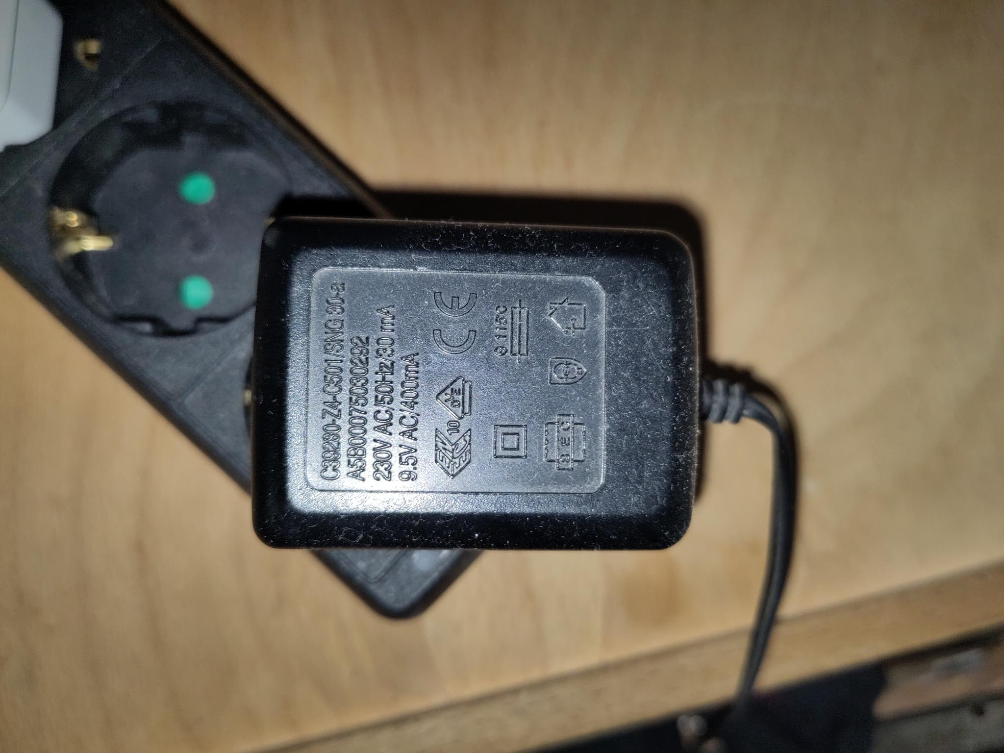

The question, where that phase error came from is still open, I will try to find out (VT + oscilloscope). The VT seems to contain a thermal fuse at least:
 ![signal-2024-08-15-173637_003](https://community.openenergymonitor.org/uploads/default/original/3X/e/0/e04108abd440b84db20198549e270e947236c664.jpeg)
(Symbol under “CE”)

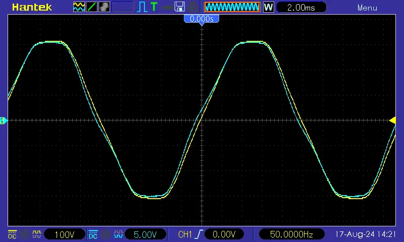

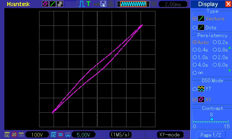

I expected this would be the case. I would hope there is nothing else in there - but if there is, why? We shall probably never know. I find it really hard to believe a simple transformer can generate a phase shift of 30 - 60°. This is a UK “Ideal” a.c. adapter as sold by the OEM shop. Yellow is the mains 240 V, blue is the 9 V output.
 ![pic_386_2](https://community.openenergymonitor.org/uploads/default/original/3X/3/9/39696869643816501457b872b994417b38904ccc.webp)
and in X-Y mode:
 ![pic_386_3](https://community.openenergymonitor.org/uploads/default/original/3X/6/b/6b8013ed293f5d8ee025ba8556a32fff28715be5.webp)
The adapter was “Ideal No.2” in [my report](https://docs.openenergymonitor.org/electricity-monitoring/voltage-sensing/report-idealpower-9v-acac-adaptor.html).
