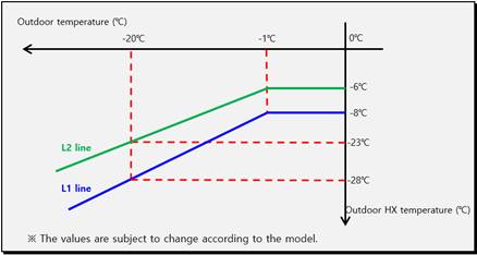

I wonder whether we Samsung users have been conflating two controller algorithms…
Samsung tell us that real defrosts are subject to the following defrost strategy:
You will see that this implies that a defrost cycle starts when the R32 temperature leaving the EEV is at or below -6degC, and stops when various other parameters combine/apply. This starts the compressor, and flips the 4-way valve to defrost/cool position, which directs hot compressor discharge into the evaporator to melt any ice build-up on the airfin. It takes heat from the emitter circuit
or the DHW circuit, depending upon which was in use at the time of the “start” request.
We have also been advised there is a frost-prevention algorithm:
“This is the anti-freeze logic, when ambient is below 3C and the system has been idle for 60 mins the primary pump will run for 5 mins with the DHW valve energised to ensure return temperature is above 6C. This will happen every hour these conditions are met. This logic is fixed and cannot be turned off.”
This algorithm just starts the circulation pump (not the compressor) on a regular (60 minute) basis for a few minutes to ensure that the pipework is comfortably above freezing point. And it takes heat from the DHW tank!
I infer from the above - and several posts on the forum - that some Samsung users may be seeing a frost prevention cycle but think that they are seeing a defrost cycle. It might be useful to be aware of this distinction when observing heat pump operating data.

Could be. I only posed the question to UK Helpdesk in the context of the AE080BXYDEG series. I looked at the EHS Data Book as a result of @Ringi’s question:
and noted that the Twin versions do have a PHE (whereas Monoblocks do not) so there could well be a difference in the controller algorithms for each.
It’s the sensor labelled “Cond Out (T_CO)” on the PFD (between the main EEV and the evaporator):
which appears on your table as “Heat Exchanger Outlet Temperature” (as you subsequently guessed, it appears from your next post). My reference to LWT>3degC was an error - I had misread the symbol on the Samsung defrost strategy as > rather than < under F, and have edited my top post accordingly. I did ask Helpdesk what “EEP_Option(min)” under D was (months ago) but never got a reply.

I asked Helpdesk about the L1/L2 lines too (I quote my Q and their A):
Q. How do I know what the T_L1_deice and T_L2_deice settings in EEPROM are? Without these I don’t know the slopes of the L2 and L1 lines.
A. These have not been shared with us by HQ so I cannot clarify sorry. I have attached an example below.
So now you know as much as me (not a lot
No idea. I assume that the numbers are the “Communication Status” figures in the table in your previous post, which your MIM-B19 gives you (but the MIM-C02N doesn’t give me). I looked at the MIM-B19 manual and saw a reference to 7 meaning “Ready” - might this mean something?
