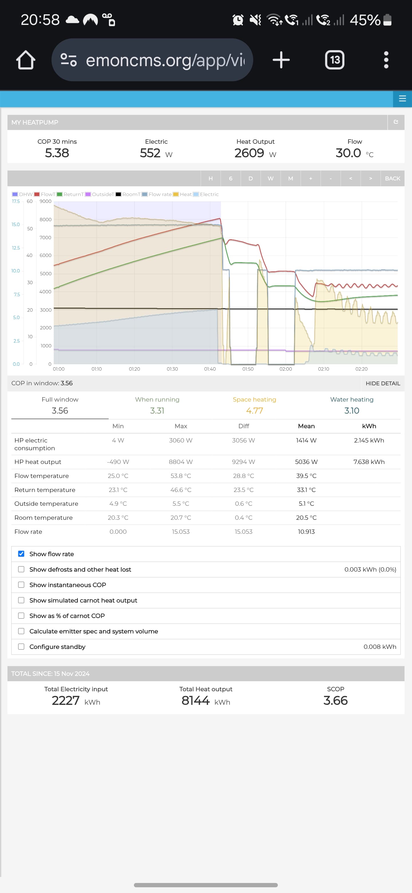

Has anyone noticed that on the Samsung HTQ during the end of a DHW run at say 65 degC LWT the space heating will not start until the LWT sensor drops to around 50 degC. The pump is not running at the end of the DHW even though the 3 way valve is switched to space heating so the LWT temperature persists. The delay is 20 minutes or so and is a significant loss of heating time.

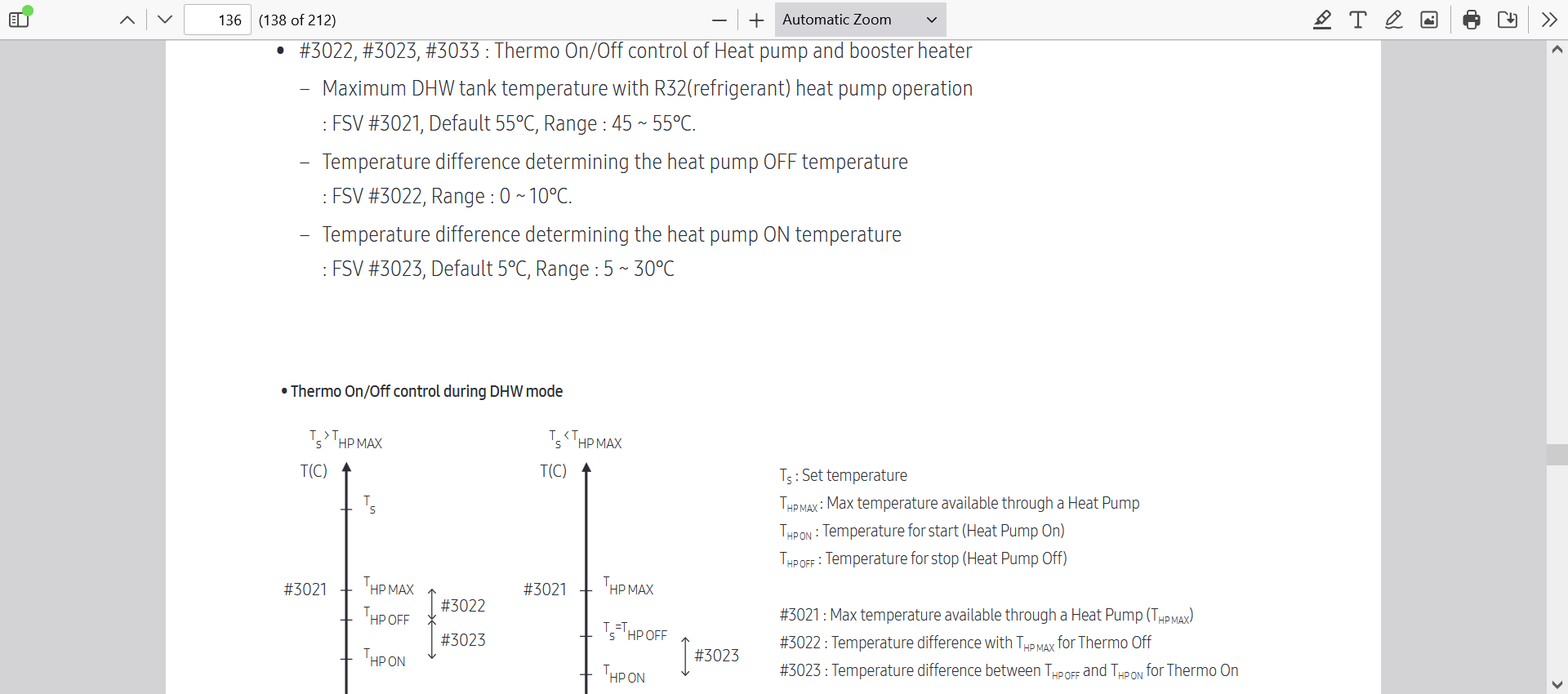

Just a long shot (the manual’s a pig) but what are your FSV#3021/2/3/4/5/6 settings?
There just might be a clue in the Installer’s Guide:
I’m wondering if the controller is using the #3023 setting (which should be for DHW restart only) for space heating restart…

the settings are :
3021 55C
3022 2C
3023 5C
3024 5C
3025 90min
3026 4hr
My theory is that the controller has a 55 degC LWT safety lockout for space heating restart somewhere - maybe 3021?
Worth trying raising it to 60.

Thanks Glyn, in my case I use the remote controller room temperature control 2093 and this was set pump1. I have now changed it to pump3 and will see how that goes on the DHW heating cycle.
Changing to the pump3 setting worked a treat!
This is a great result as I can now heat my water tank with only 30 minutes loss of space heating. In that sense the DHW performance of the Samsung HTQ at 65C is exactly the same as the old oil burner it replaces. It means that a standard UK indirect 120 litre tank size can continue to suit most household hot water demands as it is easily replenished within 30 minutes as required.
