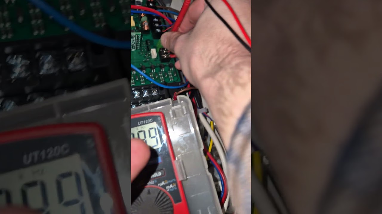

I’ve done some further testing with multimeters borrowed from work today, not sure if this is unusual behaviour or not, but with #4051 set to max 70% and the pwm cable unplugged from the pump, I’m getting a 30% signal at 1KHz which sounds promising, but as soon as I plug the PWM cable into the pump the signal disappears. I filmed a video to help show what’s happened.
[![](https://img.youtube.com/vi/lspv6QpIfGA/maxresdefault.jpg "27 November 2024") ](https://www.youtube.com/watch?v=lspv6QpIfGA)
 ![20241127_183148](https://community.openenergymonitor.org/uploads/default/original/3X/a/0/a0b7ea5d54afe6579184e9c98a374aa796e6a12d.jpeg)
 ![20241127_184418](https://community.openenergymonitor.org/uploads/default/original/3X/7/6/764b05e3605a45d5b5b1d35935c6d77eb7fe210a.jpeg)
 ![20241127_183435](https://community.openenergymonitor.org/uploads/default/original/3X/c/8/c89a702acc935674a82dbe619fd7e66644d02f87.jpeg)

Mmm your PWM connections look correct. B6 is the usual connection for the primary pump, but it sounds like you’re aware of this.
The oscilloscope reading shows that the heat pump is correctly outputting a PWM signal, maybe your pump needs to be put into PWM mode to accept the signal? My Grundfos PWM pump doesn’t have any manual controls, it’s PWM only so I didn’t have to worry about this
 ![screenshot](https://community.openenergymonitor.org/uploads/default/original/3X/1/2/12980bb65372156b1ff7ff32edc484e828ce1360.png)
It looks like you have a hybrid pump, have you tried setting it into a PWM profile mode:
 ![Screenshot 2024-11-29 01.53.03](https://community.openenergymonitor.org/uploads/default/original/3X/b/d/bdd6d7247ed589f299b7e48d6eb98933f7598ef2.png)

Still no luck with PWM. Fitted the UPM4 tonight and it’s still just running at fixed speed. Once, when i tried a different pwm cable the speed did start to jump up and down very quickly (changing speeds in less than a second). It also didn’t stop doing this when driven with a 0% signal from the controller. I haven’t been able to replicate this since turning the controller off.
The PWM light on the pump does light up (see image below) but does not flash to say that a PWM signal is established. Starting to think this may now be a Samsung issue, and not a pump issue.
Any words of wisdom from anyone would be greatly appreciated.
Also still only getting 16-17lpm on max speed, the data sheets for each pump seem to suggest I should be seeing a much bigger increase in speed.
 ![20241203_190431](https://community.openenergymonitor.org/uploads/default/original/3X/c/6/c6353fee806c52d7647fe625b7cb453bace8d013.jpeg)
 ![20241203_190545](https://community.openenergymonitor.org/uploads/default/original/3X/c/3/c395ae55dbf9c29beda1bfb18a924a7d46d19eb6.jpeg)
