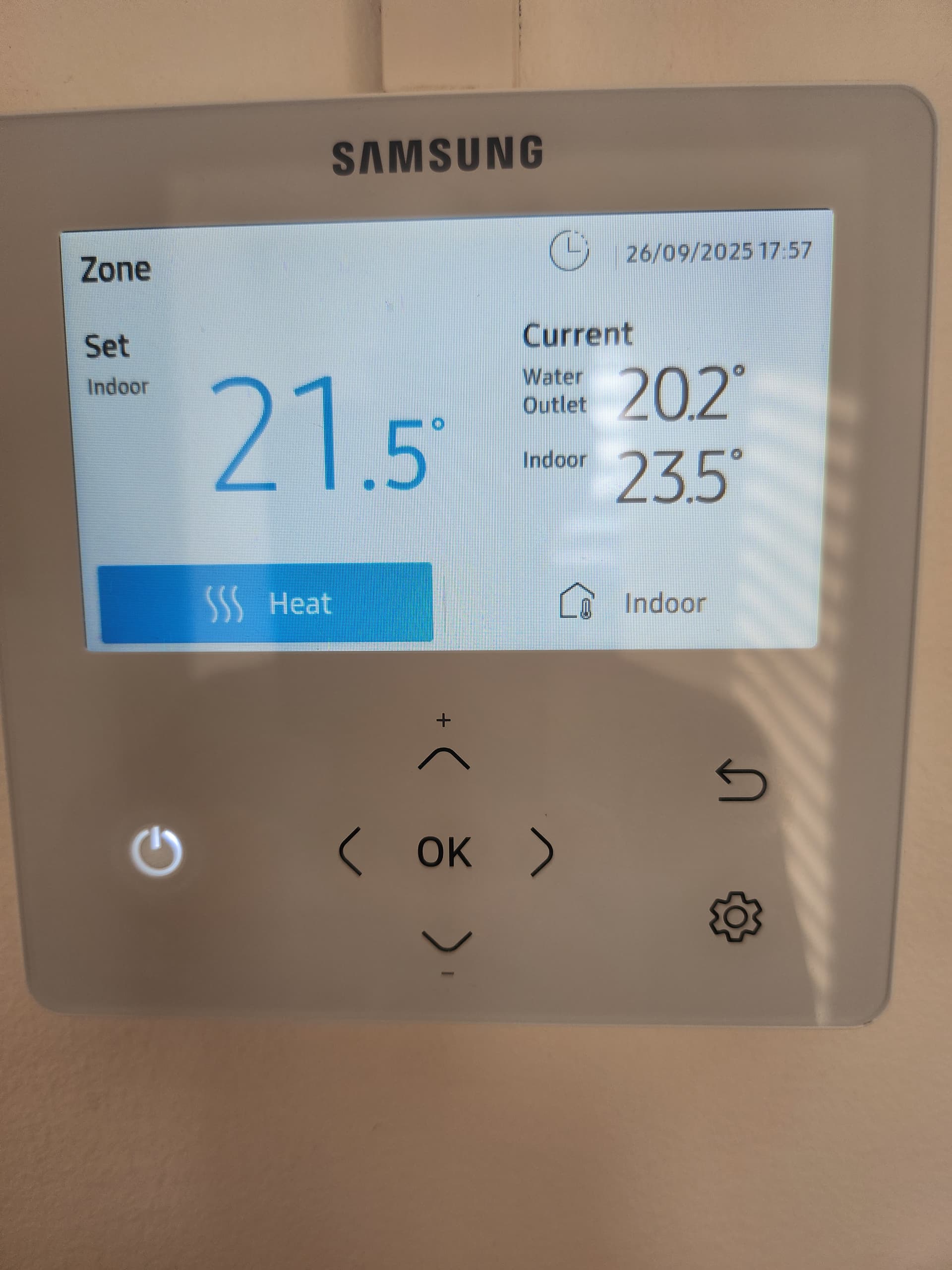

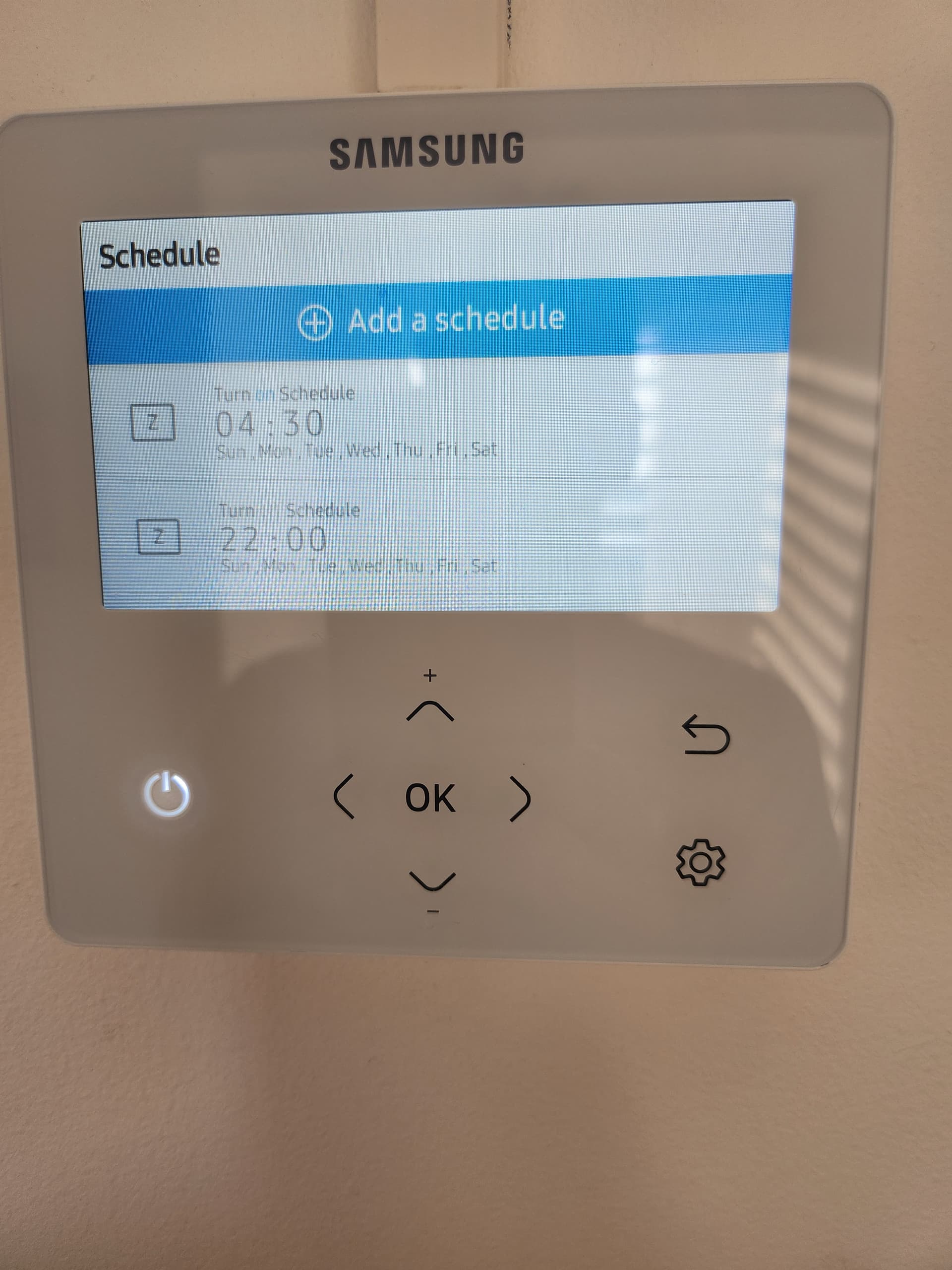

Im hoping this is a simple to resolve issue, but so far I have not been able to resolve it. Since starting up my Samsung for this years heating season, the weekly schedules are not being followed and the heat pump is working 24 hours a day at a single set temperature, instead of coming on at different times with different set temperatures. Im not aware of having changed anything.
The relevant FSVs are 2091 - NOT USE, 2092-NOT USE and 2093 Room Temp and WL (Water Pump 3)
I have deleted the old schedules and reinstated them to no effect, but all the weekly schedules appear dimmed. However I cant remember if they were the same last year when the schedules were working.
Thanks in advance.

Think I may have got to the bottom of it. I had Holiday mode enabled DOH! Thanks for looking 🙂
