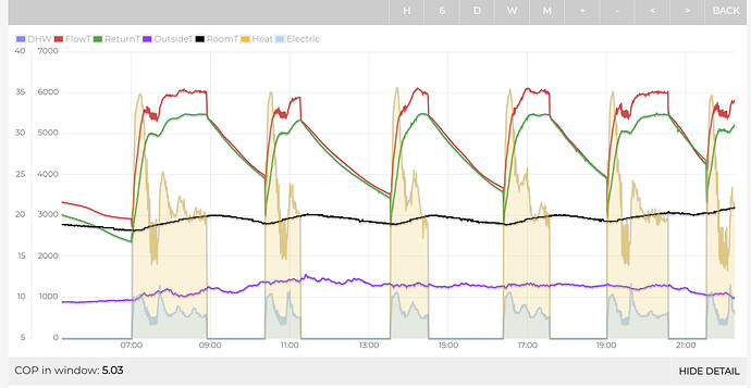

**Author:** ![billt](https://community.openenergymonitor.org/letter_avatar_proxy/v4/letter/b/ecc23a/32.png) [@billt](https://community.openenergymonitor.org/u/billt)\
**Post date:** [23 January 2024 19:40 UTC](https://community.openenergymonitor.org/t/samsung-gen-6-8kw-efficiency/22132/182 "2024-01-23T19:40:17Z")
> [@SarahH](#):
> There is plenty of experience on thus discussion group that Samsung have not properly implemented PWM outputs for circulating pump control on their MIM controllers,
How have you come to this conclusion?

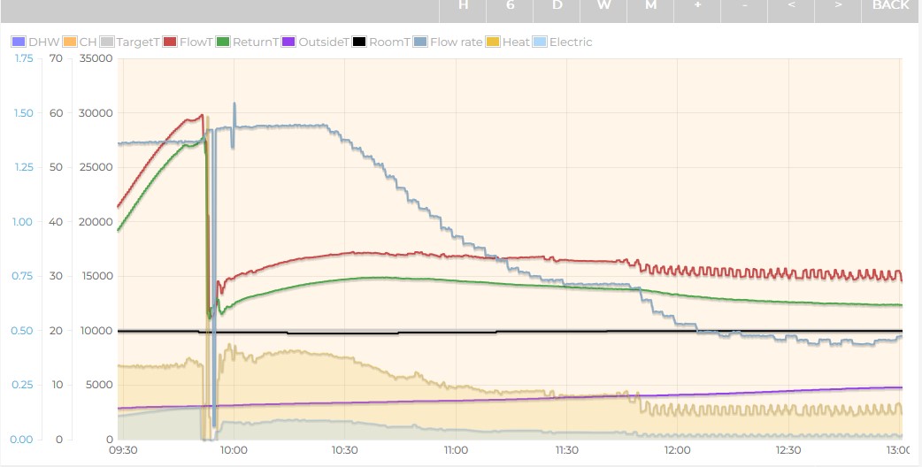

My system has a speed controlled pump and it seems to work properly as far as I can see.
 ![flow](https://community.openenergymonitor.org/uploads/default/original/3X/d/c/dc908c51e956c0de520e869fdde4a22293d1eedd.jpeg)
Starts off at high flow (1.44cu.m/hr) and 8kW output until it’s got up to temperature then gradually drops the flow rate, ultimately down to 0.44 cu.m/hr and 3kW output to maintain a DT of about 5C.

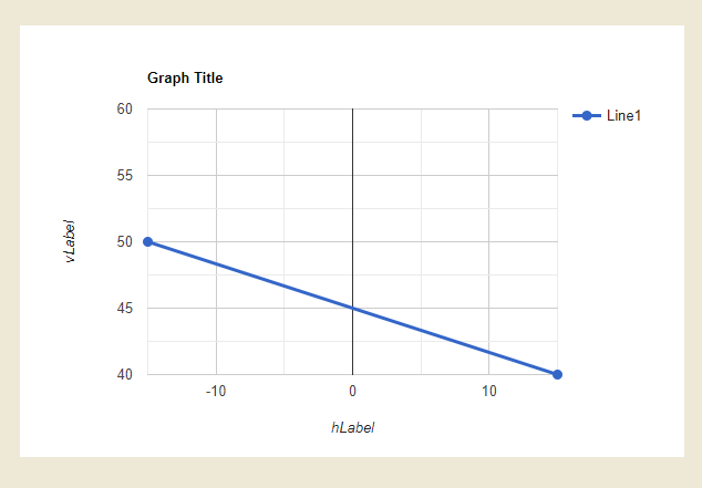

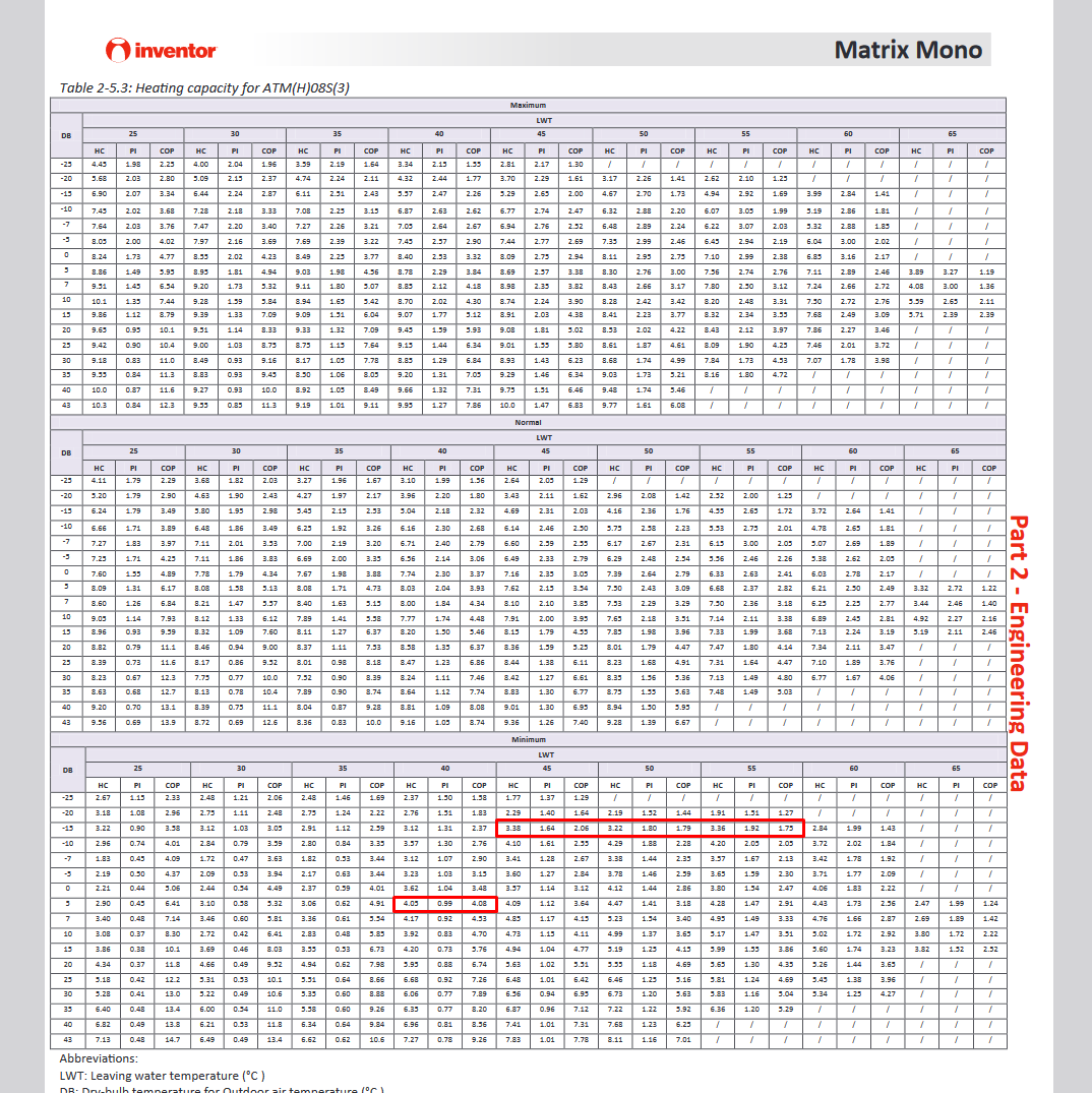

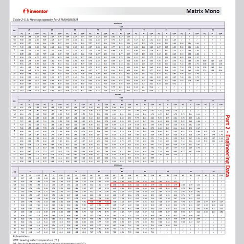

Yeah, that’s the issue. Seems it’s a bit big for my house but here I’ve looked to some other pumps and to be honest they are even worse. E.g. look at this inverter mono:
 ![inverter](https://community.openenergymonitor.org/uploads/default/original/3X/c/8/c800e0865f6f3bf12faa04feae252ec05b371fe1.png)
This is 8KW unit but look at the cold temperatures; at -15C and 50C water it outputs 4.67KW lol which would not cover my heat loss. Even -10C would not cover them. So here you can see my decision why I’ve choose Samsung HT. This will heat my house even at -20 like nothing.
And look at minimum power - this is poor as well. At 5C it runs min 1KW outputing 4KW of heat. This would be still too much for me and it would cycle anyway. Same as this samsung but maybe less depending how it is configured. And I can’t buy lower output units since I need at least 7KW at -15C. Maybe I would need to upgrade a pump but these temps are not usually and can live few days with colder inside.
So I would be pretty OK with Samsung in case start/stop cycle interval can be prolonged. For now, no one gave me an answer for this. I guess the only option is to use external thermostat. My problem actually is not that radiators or piping can deliver sufficient heat, problem is they delivers too much heat at given outside temperature. I could switch it for bigger ones or better pump for a flow but it won’t help me with excessive heat 🙂

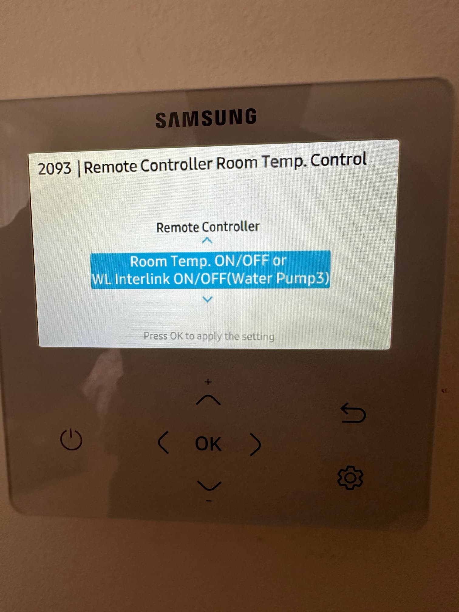

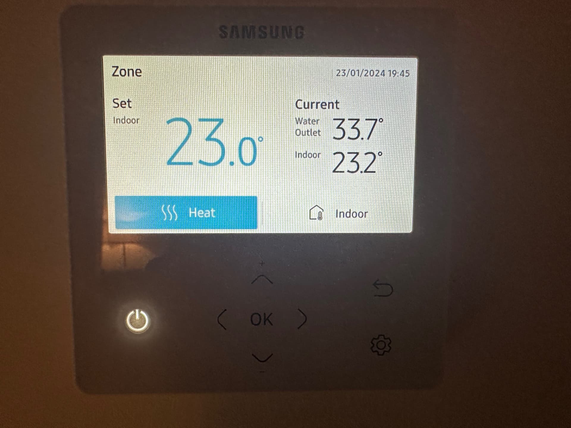

I’m telling you, this is the controller from Samsung. He can choose between “water law” or indoor temperature. I had it set to “water law” so it regulates by same magic based on temperature curve and LWT. And then you have this indoor settings which looks like kind of thermostat but seems it does not work like that. Seems it’s not just a on/off switch when target room temperature is reached. Until know I did not understand how it works. But I saw it switch off the pump at target temp and then started the pump 4 minutes later while indoor temperature did not drop a bit. Really a mystery but I think It’s shit and I need to use really an external thermostat which will send signal to pupm to simply shut off and then turn on.
 ![IMG_7116](https://community.openenergymonitor.org/uploads/default/original/3X/4/6/466012552b8f16b3592be81d9b06606cce2a75c0.jpeg)
Does this look like room thermostat or ? Does anyone know how it works ? I would expect it has some hysteresis setting e.g. +/- 0.3 so if I set I want have 22C in the room then while the pump heating it will shut down the pump at 22.3C and then turn on at 21.7C. I don’t know why this stupid Samsung controller does not do this. Really. So if anyone can explain it I would be happy.

I use the Samsung controller as a thermostat like this. It still uses water law (weather comp) to set the flow temperature based on the outside temperature and WL settings, but it will also switch the HP off when the indoor temperature set point is satisfied. It has 1C of hysteresis with is non-adjustable i.e it will wait for the temperature to drop by 1C before switching back on e.g. if the set point is 20C it will switch off when the house reaches 20C and then switch back when the house has dropped to 20C. Obviously for this to work the Samsung controller needs to be located in the living space rather than a plant room!

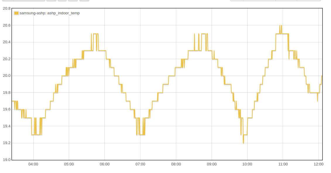

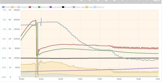

 ![Screenshot 2024-01-24 00.21.54](https://community.openenergymonitor.org/uploads/default/original/3X/8/c/8c2062cad22c3daefd229d47cf3cd04436ea323d.jpeg)
@Michal_S I wouldn’t focus too much on cycling and trying to optimise for the longest runtime, this may not always equate to the highest efficiency and lowest running costs. Here’s an excellent video by John Cantor on this topic:
Since updating the firmware on my heat pump (I had an old model) to get PWM pump control to work, I’ve found that I’m able to run a bit lower flow temperature and have longer runtimes since, it’s too early to draw conclusions yet, but It’s looking like this might result in slightly higher efficiency, it’s a marginal benefit, but I would try and get PWM working if you can, but it should be possible to get good performance running at constant speed pump, as I demonstrated last year.

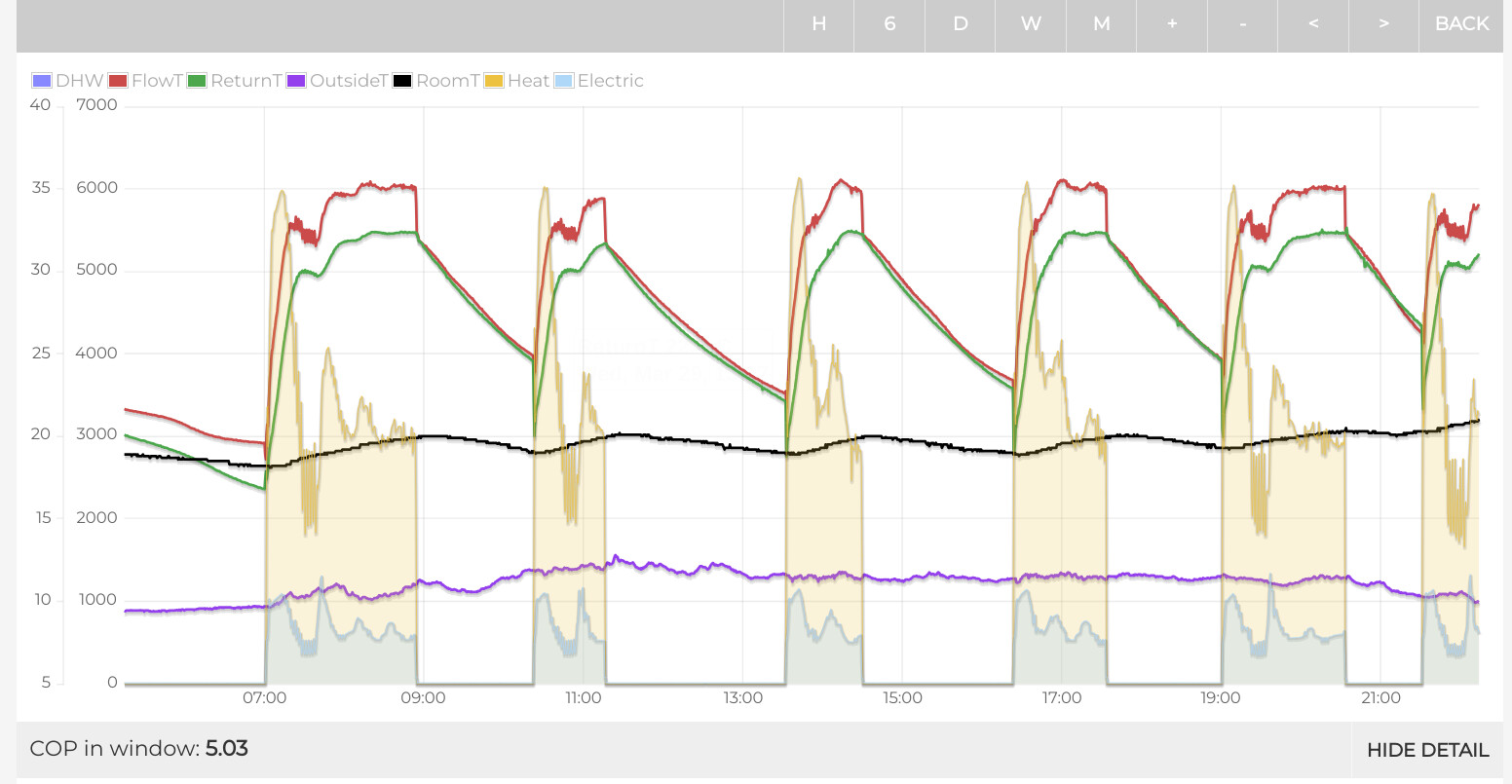

Here is the graph from last night. It wen fro1C to 5C in the morning and cycling nightmare started:
 ![20240124_cycling](https://community.openenergymonitor.org/uploads/default/original/3X/2/0/20130ea108eee7ee50c35f6cdb0de9a2a1c1fda8.png)

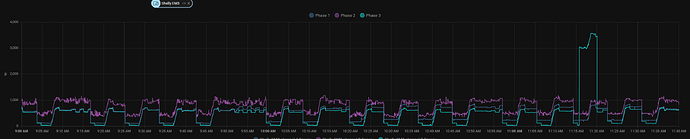

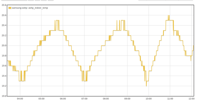

Beauty of this HP cycling. This is really extreme. 9C outdoor temperature. Can anyone tell me what shall I do here ? Indoor temperature set to 23C. Actual temperature 22.8. I think it is LWT/RWT difference which is shutting down the system before indoor thermostat even kicks in and send or or off signal.
Flow still constant 9.6L/m. Target LWT around 36C.

I think some of the information thats gone round about the behaviour of the controller when its in room temperature mode isn’t correct with regard to the hysteresis. Or if it is proven correct for that persons system then perhaps its the case that different samsung systems genuinely have different hysteresis behaviour? Which could perhaps be due to firmware (of which I have no knowledge, only speculating) ?There’s certainly no setting for hysteresis that I can find.
the way mine behaves, if set to 21.0, is this:
call for heat constantly until temperature reaches 21.9. switch off. house cools to 20.9. switch back on.
so the hysteresis for me, is +0.9 -0.1 . that is if there is no short cycling of course, if its in stable output.
in your observed case yes, it will still be calling for heat if controller is set to 23 and actual is 22.8. So what then takes over is the LWT/RWT difference being too close, if they are too close it will shutdown and cycle on the 7/3 timer.
the best fix for what you are getting is more emitters. A higher target WT is also worth a try as that increases emitter output, not guaranteed though and obviously less efficient.

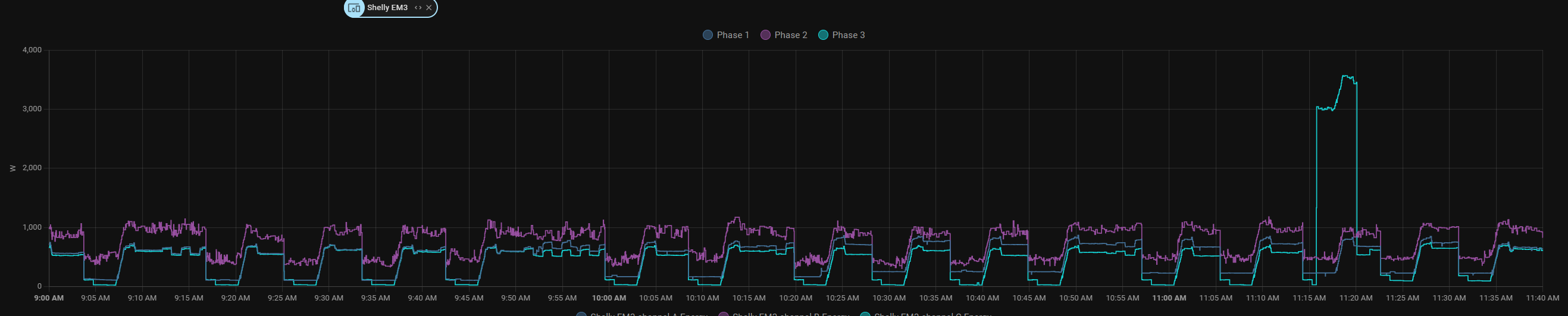

Thanks for explanation. I think this is how it works but I have to observe. For what I can tell now is that I simply cannot run my radiators under 40C if there is +5C outside since they are not able to output enough heat (indoor temp is 22.5C). So it happened that I’ve set 23C and at given LTW it was not able to achieve 23C because it has short cycled every few minute. BUT, then I’ve change to 22.5 and it was finally turned off by thermostat so I guess now it will wait until temperature drops to 21.5 to start heating again ?? This hysterezis of 1C feels a little bit to much but I guess if I set it to 23C it will stop here and goes all down to 22 when it starts again.
But this itself won’t solve the issue. Another issue is thermal characteristics of my K2 radiators. So I’ve change the curve like this which could help a lot with heat transfer so the thermostat can shut down the pump before T1 and T2 is too much or too low difference.
![image](https://community.openenergymonitor.org/uploads/default/original/3X/0/3/030be0a8fae2c3299028c5b4c4a12c55e7fb2ecf.png)

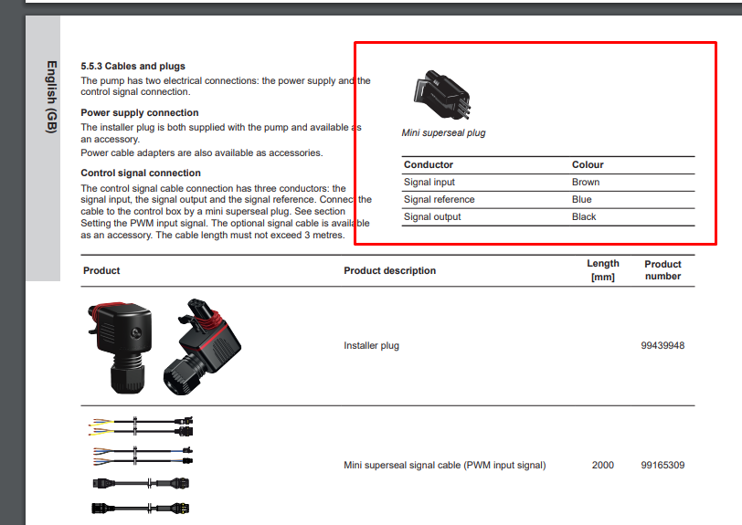

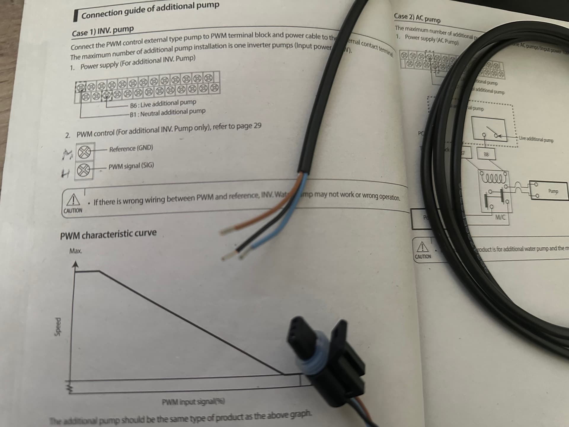

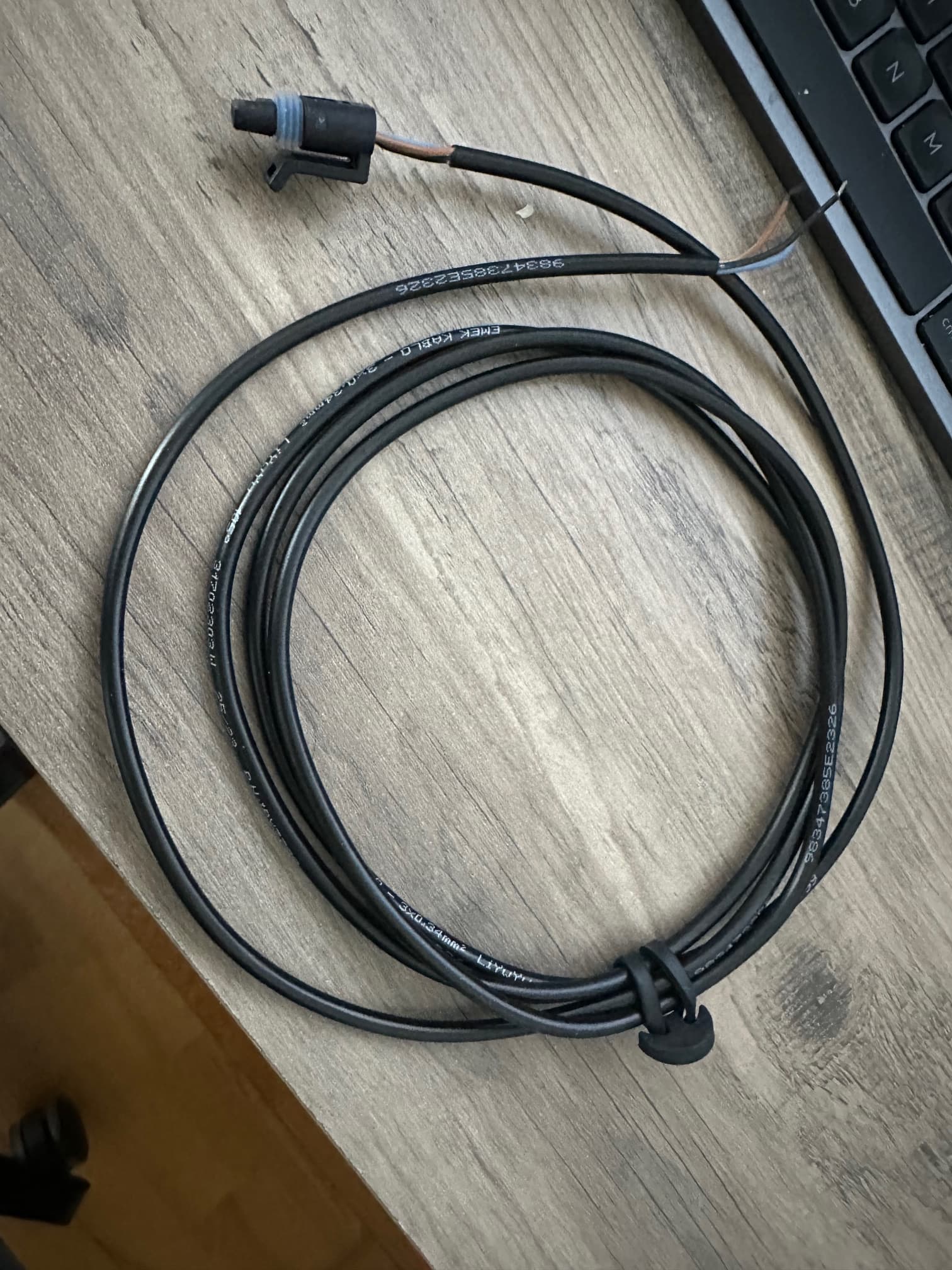

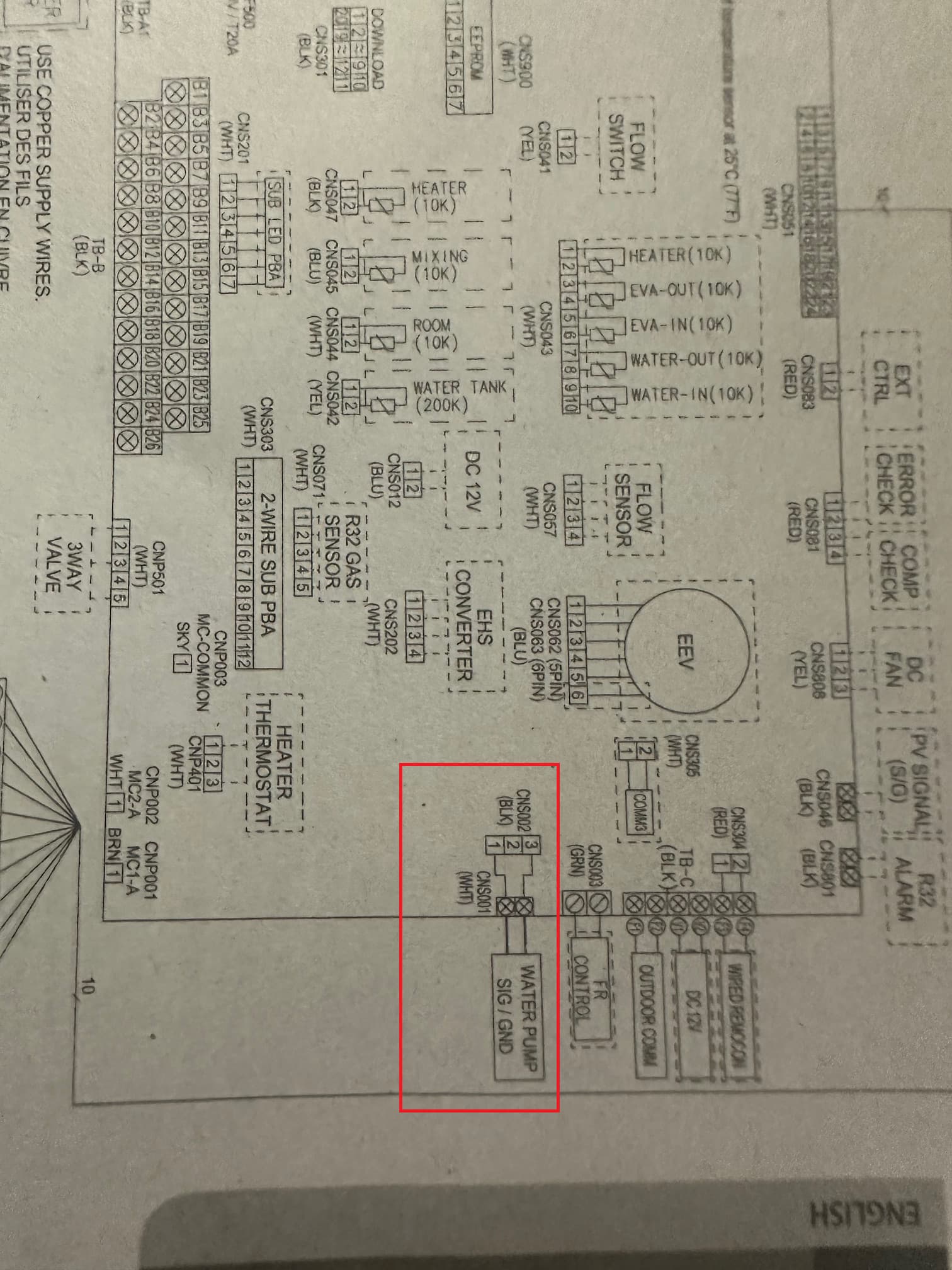

Also my PWM cable arrived so I really hope this will help in efficiency a bit since it can regulate the flow from 7 to 16 liters per minute. Actual it’s fixed at 9 lpm which is not sufficient in most of cases.
I’m going to connect it so pray for me these adjustments help to run in longer cycles 🙏
 ![IMG_7121](https://community.openenergymonitor.org/uploads/default/original/3X/2/3/23cef3818aaa781d6368e6eea061509eea3abb8f.jpeg)
Ian, could you please tell me what this settings mean exactly and what the difference between pump1 and pump2 and what means it there is no pump at all only on or off.
 ![IMG_7122](https://community.openenergymonitor.org/uploads/default/original/3X/f/2/f2e035862fd08943720ab5477fa54ac7c7532e90.jpeg)
**Author:** ![Ian\_Calderbank](https://community.openenergymonitor.org/user_avatar/community.openenergymonitor.org/ian_calderbank/32/24687_2.png) [@Ian\_Calderbank](https://community.openenergymonitor.org/u/Ian_Calderbank)\
**Post date:** [24 January 2024 11:52 UTC](https://community.openenergymonitor.org/t/samsung-gen-6-8kw-efficiency/22132/195 "2024-01-24T11:52:35Z")
> [@Michal\_S](#):
> **[MIM-E03CN | Samsung Support UK](https://www.samsung.com/uk/support/model/MIM-E03CN/)**
> MIM-E03CN. Solutions & Tips, Download Manual, Contact Us. Samsung Support UK
user manual page 28 and 29

BTW, do you know how to connect this PWM cable ? It has 3 wired but PWM terminal has only two screws. So I think I will connect BROWN cable to PWM signal and BLUE cable to Reference (GND) but where to connect the BLACK wire ?
 ![IMG_7123](https://community.openenergymonitor.org/uploads/default/original/3X/4/8/485f4ae071f10a0429810fc39e94bbd787f50c6a.jpeg)
**Post date:** [24 January 2024 12:09 UTC](https://community.openenergymonitor.org/t/samsung-gen-6-8kw-efficiency/22132/197 "2024-01-24T12:09:56Z")

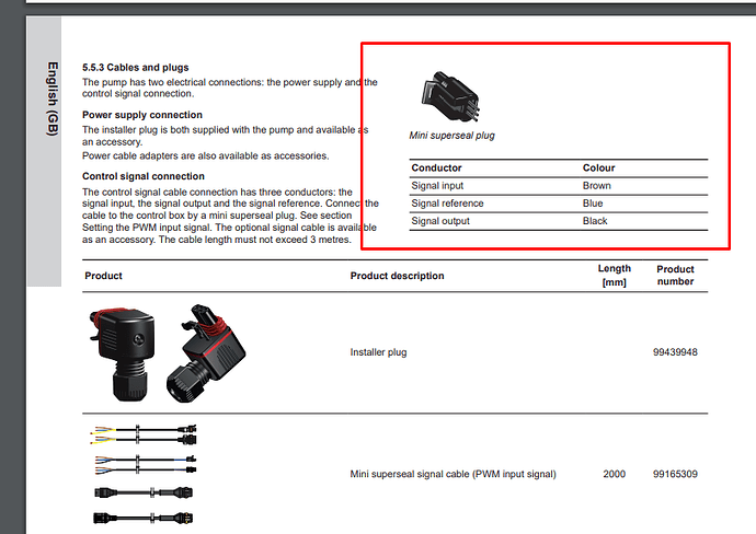

one is a return signal I think which you don’t need. can’t remember which is which. plenty of info available if you get googling.
**Author:** ![Michal\_S](https://community.openenergymonitor.org/user_avatar/community.openenergymonitor.org/michal_s/32/28455_2.png) [@Michal\_S](https://community.openenergymonitor.org/u/Michal_S)\
**Post date:** [24 January 2024 12:13 UTC](https://community.openenergymonitor.org/t/samsung-gen-6-8kw-efficiency/22132/198 "2024-01-24T12:13:43Z")
> [@Ian\_Calderbank](#):
Yeah, seems BLACK is output signal from pump so i will keep this disconnected.
 ![image](https://community.openenergymonitor.org/uploads/default/original/3X/8/c/8c26b6ea617ef47b54f7fb9a323cd07cc80bee75.png)
Or is it vice versa? Do I need to connect signal input to the MIM or Signal output ? 🙂
**Post date:** [24 January 2024 12:28 UTC](https://community.openenergymonitor.org/t/samsung-gen-6-8kw-efficiency/22132/199 "2024-01-24T12:28:30Z")
@Ian_Calderbank Sorry for bother again but want to double check, if this is proper terminal to connect ? It’s a bit chaotically written in manual.
 ![IMG_7125](https://community.openenergymonitor.org/uploads/default/original/3X/f/3/f3b51ac21321243c636138ad1fa4757be8a9b053.jpeg)
UPDATE:
OK, connected like this and seems working 🙂
**Post date:** [24 January 2024 13:31 UTC](https://community.openenergymonitor.org/t/samsung-gen-6-8kw-efficiency/22132/200 "2024-01-24T13:31:53Z")
> [@Michal\_S](#):
> Hi Glyn, did you that if you set 20 it reached this temp, it’s off until it drops to 19 and then turn on right ? Still I don’t understand why there is no hysteresis possible to set on this controller. E.g. 0.5C. 1C is pretty big drop you may fell.
I agree, it’s a shame the hysteresis is not adjustable. But I can’t see an option for this. 1C of hysteresis does not bother me, this makes for decent length runtimes.
> [@Michal\_S](#):
> Could you please reattach the video ? It was removed.
Here’s my video about my heat pump:
Installation:
[![](https://img.youtube.com/vi/Hyv_vQEvHgo/maxresdefault.jpg "How I fitted an Air Source Heat Pump ASHP: Samsung Gen6 5kW") ](https://www.youtube.com/watch?v=Hyv_vQEvHgo)
Performance:
[![](https://img.youtube.com/vi/kkNx2oSO-S4/maxresdefault.jpg "Air Source Heat Pump 1st Winter Performance in Solid Stone Welsh Cottage") ](https://www.youtube.com/watch?v=kkNx2oSO-S4&t=22s)
Interesting, mine defiantly has a 1C hysteresis. It’s quite possible there are differences between different firmware versions. This is my indoor temperature as measured by the controller, I’m reading the modbus output.
 ![Screenshot from 2024-01-24 13-30-57](https://community.openenergymonitor.org/uploads/default/original/3X/b/0/b0ed571a805b2fa3fd6bc7c3d2a1e4560e129aa0.png)
