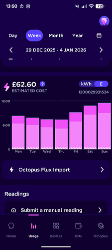

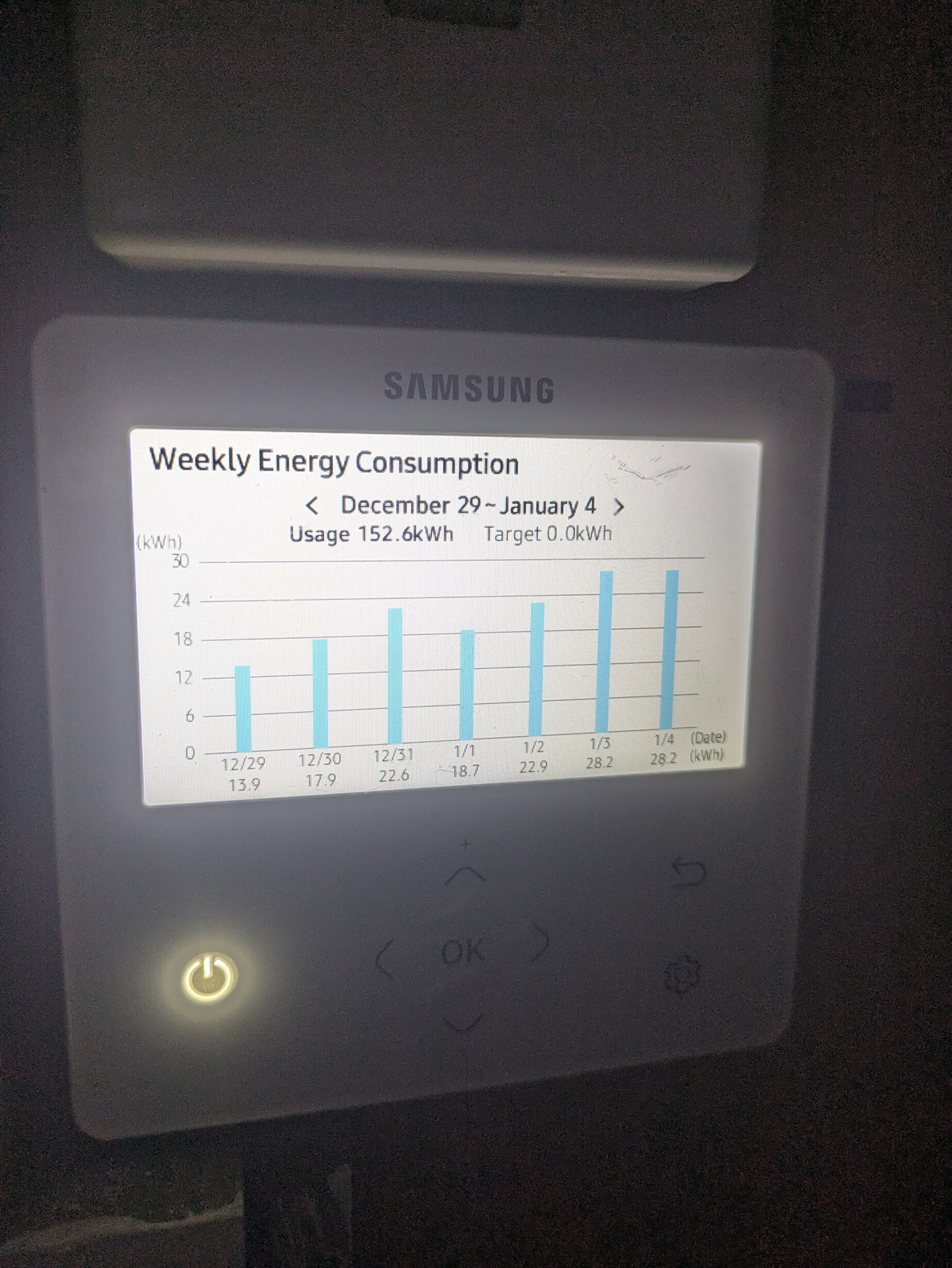

Hi all, hope you’re still feeling toasty warm in this cold snap we’re having. It’s been a good test of my settings though so thought I’d share.
Overall it has been working really well. Cycling is about the same so no problems there. I did bump up the higher flow temp (the one for the lower outdoor temp) to 42 and then 43 from 41 as it was just a little too chilly upstairs where we’ve not got the best sized rads. But honestly the power consumption/cost is fine for us.
Just before it got really cold I actually put the lower flow temp figure (or one for the higher outdoor temp) down to 28 and that was fine. Will see when we get closer to the 14 degrees mild temperatures.
4 degree hysteresis seems to be working fine too. The house temperature doesn’t really drop before the compressor kicks back in.
So thank you for all your help.

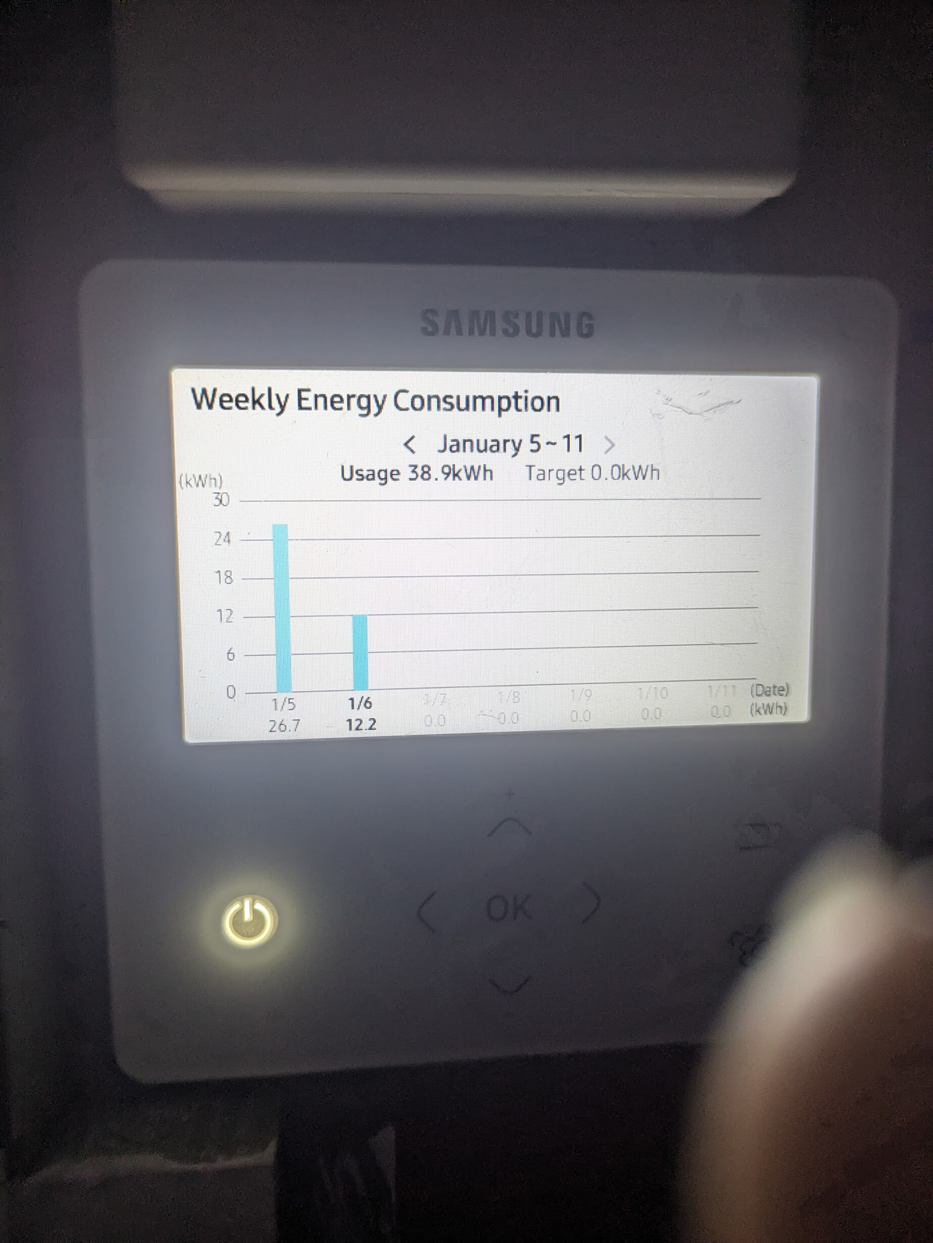

Here are some shots of our heat pump energy consumption over the last week or so
 ![image](https://community.openenergymonitor.org/uploads/default/original/3X/1/8/188dd56a777c5beecd9d594ff21b35d110685d40.jpeg)
 ![image](https://community.openenergymonitor.org/uploads/default/original/3X/5/6/56cff44a12908538086f9e6fb44ac971a1cf9e31.jpeg)

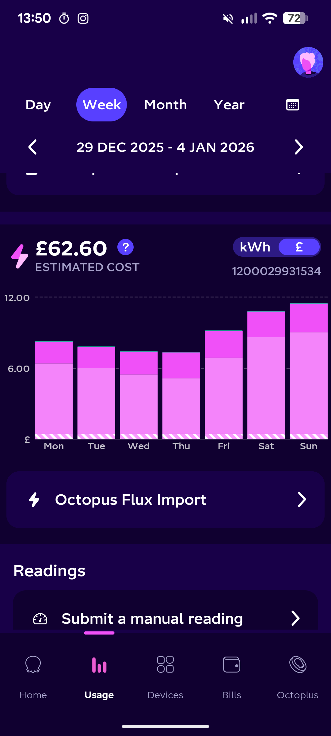

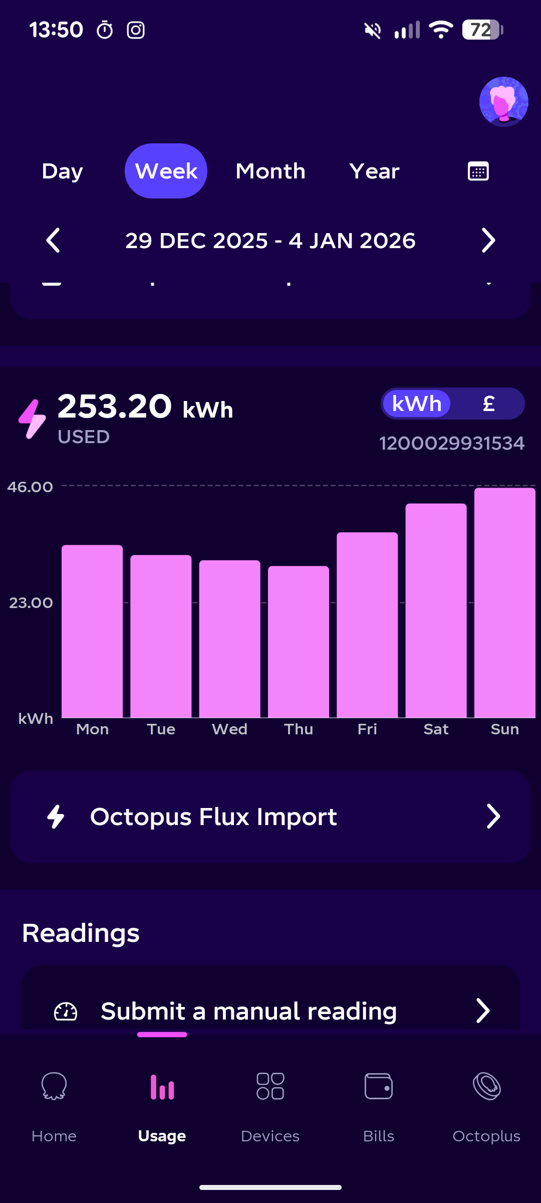

And then overall consumption and cost, just in case it’s of interest.
 ![image](https://community.openenergymonitor.org/uploads/default/original/3X/e/8/e8b4f82506bc3db7defb9991899621d67bbc58ef.png)
 ![image](https://community.openenergymonitor.org/uploads/default/original/3X/d/0/d09a2201ca6495bb2ce19e54968f174f8cffbbb2.png)
