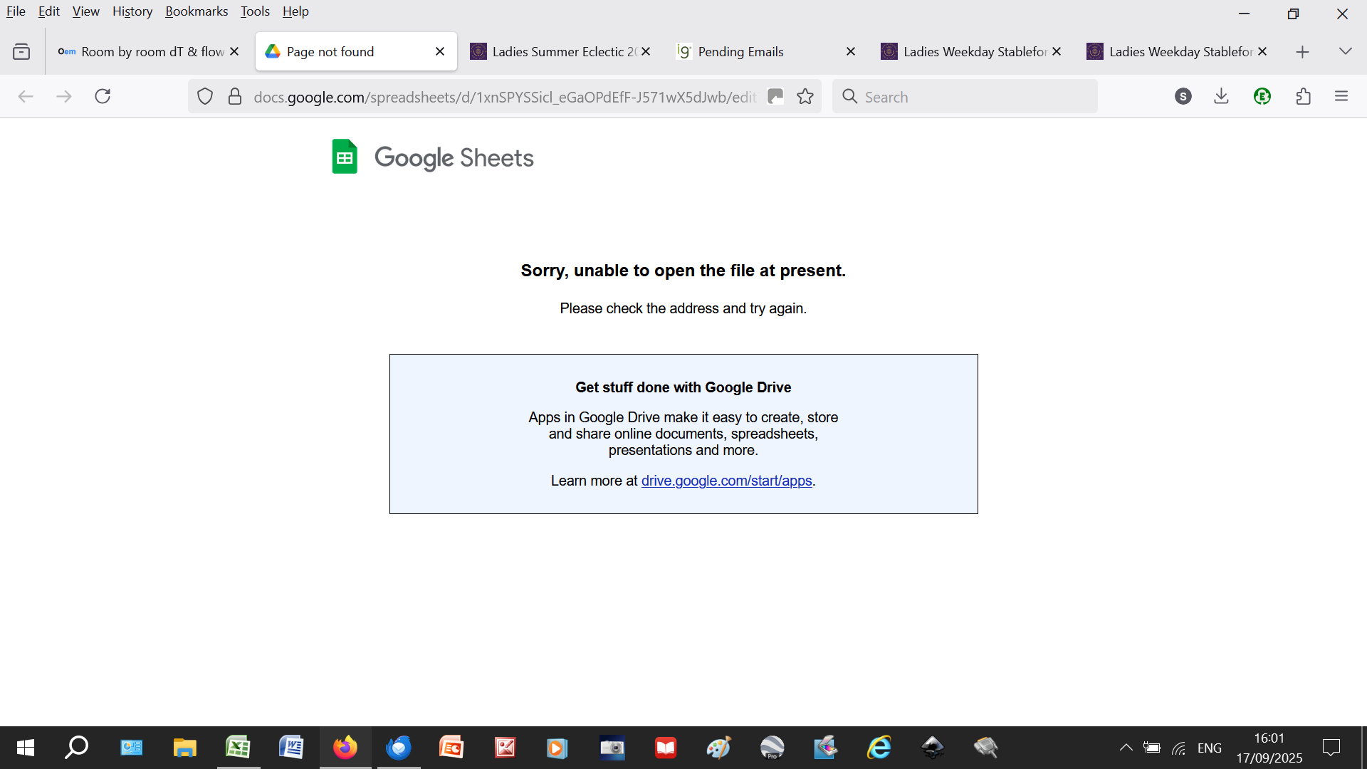

I’m getting this when I click your link, @jakeymd1 :
 ![image](https://community.openenergymonitor.org/uploads/default/original/3X/b/0/b0cc92289bbbfe78795c44ccb0debbb034233a26.png)
**Author:** ![jakeymd1](https://community.openenergymonitor.org/letter_avatar_proxy/v4/letter/j/db5fbb/32.png) [@jakeymd1](https://community.openenergymonitor.org/u/jakeymd1)\
**Post date:** [17 September 2025 15:11 UTC](https://community.openenergymonitor.org/t/room-by-room-dt-flow-rate-calculator/29112/4 "2025-09-17T15:11:50Z")
@SarahH try again now.
**Post date:** [17 September 2025 15:59 UTC](https://community.openenergymonitor.org/t/room-by-room-dt-flow-rate-calculator/29112/5 "2025-09-17T15:59:03Z")
Thanks @jakeymd1 it downloads now, though I don’t have time to look through your spreadsheet logic at the moment…
