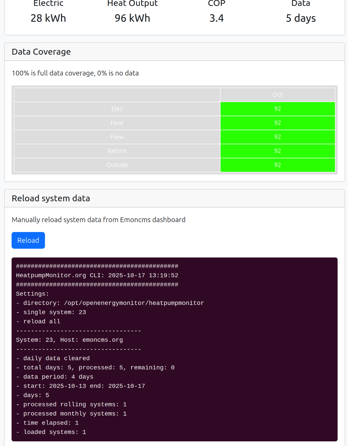

Restricting MyHeatPump data set for SCOP calc
In the 3 years I’ve had my Daikin EDLA09 installed it’s effectively been 3 different setups;
1 As installed, not many radiators so a poor performer
2 Extra radiators, a better performer but still poor at low modulation
3 Post-Daikin 2025 firmware upgrade; better modulation
Is there any way to limit the data that MyHeatPump shows and publishes on HeatPumpMonitor to show the most recent incarnation? I tried the “Unix time stamp” option but it doesn’t seem to do what I expected.
Hello Simon, after setting the timestamp, if you then press the button to reload the data, it will update to that timestamp, e.g just ran on your system:
Thanks Trystan!
