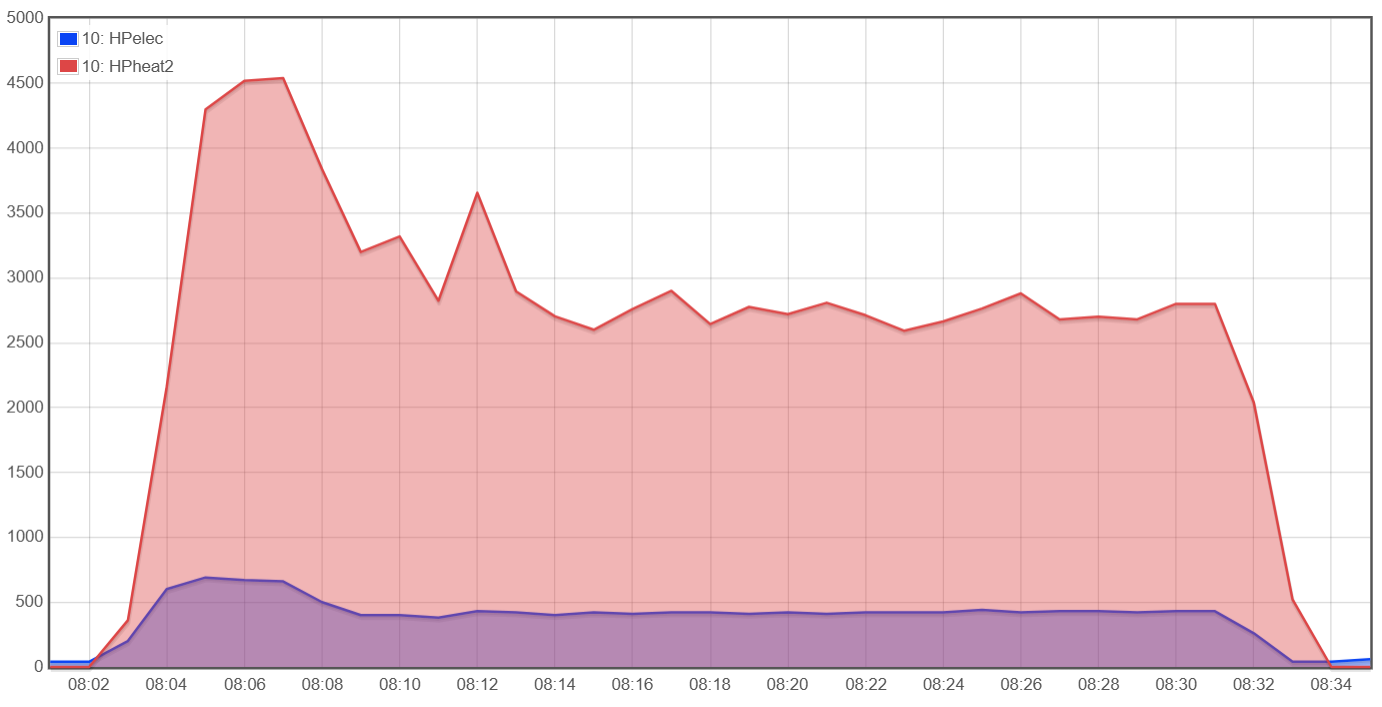

In the end I have used the Sontex 531 programmer as is (without being able to correct the flow meter pulse factor in the 531 settings) and instead I have made the adjustment to the calculated heat output by adding a new process in the input feed to multiply the Wh accumulator by the ratio of the pulse factors. Good enough for my purposes (plot of new data below). Unfortunately my 531 doesn’t have the Mbus module so I have to use the heat energy pulse output to the emonpi.
