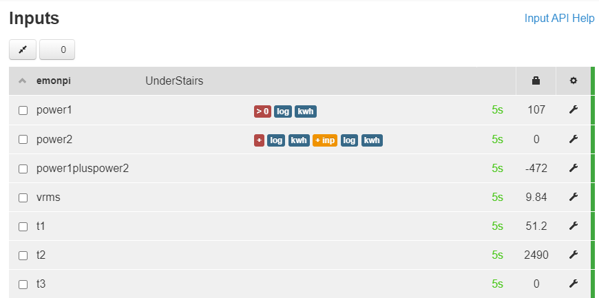

From what I can determine, it appears that the inputs are mixed up and getting the wrong data. I.e. VRMS is not showing the voltage but some other figure.
Hello @Neil_Hack, could you share a screenshot of your emonPi inputs? and if you go to Setup > Emonhub > Edit config, the entry that you can see in the nodes section for the emonPi?
Do you just have an emonPi there or do you have other nodes as well that the emonPi is receiving via radio?
Are you now running the latest emonSD image?
Hi Trystan,
Here is everything.
emonpiRelease - emonSD-21Jul21 (Latest version does the same except the demandshaper is not installed)
Response from emonhub
2023-06-24 11:41:47,985 DEBUG RFM2Pi 98 NEW FRAME : OK 5 101 0 0 0 119 254 133 3 252 1 41 97 0 0 0 0 0 0 0 0 0 0 0 0 0 0 0 0 0 0 0 0 132 219 253 255 167 87 11 0 (-0)
2023-06-24 11:41:47,988 DEBUG RFM2Pi 98 Timestamp : 1687603307.985073
2023-06-24 11:41:47,988 DEBUG RFM2Pi 98 From Node : 5
2023-06-24 11:41:47,989 DEBUG RFM2Pi 98 Values : [101, 0, -393, 9.01, 50.800000000000004, 2487.3, 0, 0, 0, 0, 0, 0, 0, 0, 0, 0, -9340, -3, 22439, 11]
Actual Solar right now, while writing this response is 3.47KW
It almost feels like, to me, that the inputs CT1 CT2 are feeding incorrectly or in a non-standard way.

Not quite. I think Trystan will also need sight of the contents of emonhub.conf, because as you say, the numbers for power1, power2 and power1pluspower2 should add up and they donā€™t. Also, 51.2 and 2490 for t1 & t2 donā€™t look sensible. It looks to me as if the raw values (` OK 5 101 0 0 0 119 254 133 3 ā€¦ etc) are out of step with the decoding instructions in emonhub.conf.
I appreciate the help. Do you need the while thing or just the emonpi section?
Itā€™s safer to send the whole file so we have the whole picture, just in case thereā€™s a duplicate or something silly like that.
Full File.

The single quote in front of ā€œpulseā€ (many instances) is not right, but I donā€™t think it will be interfering with Node 5. What is wrong there is the ā€˜datacodesā€™ line is commented out, meaning that everything is treated as a signed integer (h); besides which, the count of bytes of data doesnā€™t fit the names. This is no doubt your problem.
Comment out the whole of your Node 5, and substitute this:
[[5]]
     nodename = emonpi
     [[[rx]]]
         names = Msg, power1,power2,power1pluspower2,vrms,t1,t2,t3,t4,t5,t6,pulsecount,pulsecount2,E1,E2

ā€œMsgā€ is a serial number for the radio message - allows you to know when one (or many) goes missing. There are two pulse counts, you will only see the first. E1 and E2 are the accumulated energies from power1 & power2.
With luck, youā€™ll get sensible numbers. E1 & E2 should track the kWh values that emonCMSā€™s processing generates (but in Wh).
Luck is good. So things look normal now. I have numbers 12 to 20 in the inputs where the timer is just going up, so suspect I can simply delete those.
I am happy itā€™s working. Donā€™t get why a fresh installation simply does not work. For your question, I commented out the datacodes because it was causing an error in the emonhub. All the inputs and feeds were showing N/A. When I commented it out, it was able to read data, albeit incorrectly. I read that in the community somewhere.
At least now I can work on the energy use and the solar generation and fine tune it so that it matches the inverter, or as close as can be.
Iā€™m really grateful it is working now.
I think there is a bug in the way the emonhub config is imported.
That was telling you the data coming in wasnā€™t what the config file expected.
because the default decoding didnā€™t fit the data.
Because it inherited your old emonhub.conf. Although the emonPi itself has changed the format of the data it was sending, everything else coming in from outside needed your old emonhub.conf
It would need some fairly serious code to automatically edit emonhub.conf to replace the Node 5 section (or whichever node your emonPi is).
Thanks for all your help. Everything seems fine now.
