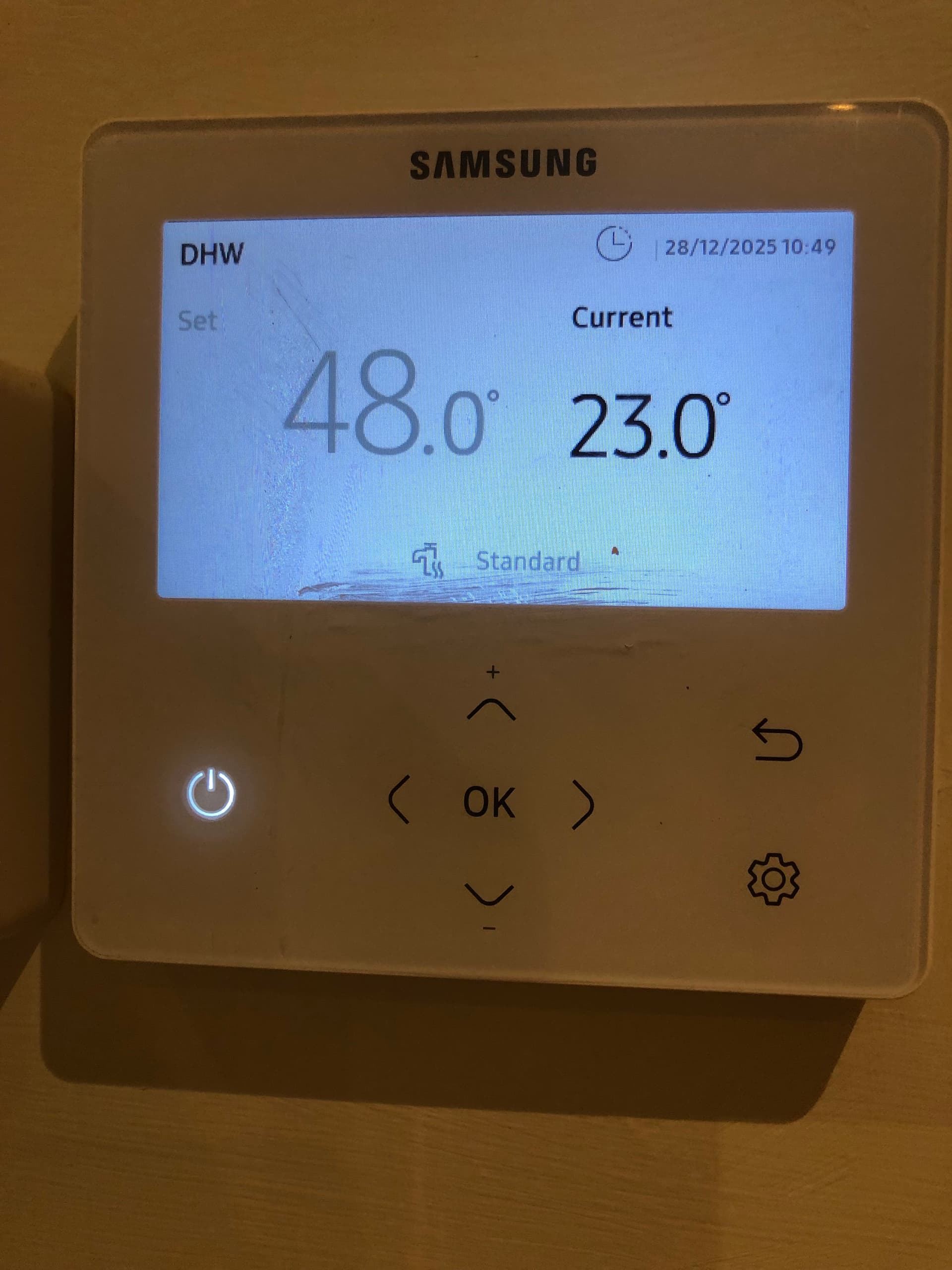

1. The Samsung remote controller (the MIM-E03\*N) displays – as opposed to monitors – all the info you need to optimise your setup (i.e. instantaneous heat generation and power consumption, thus CoP). Setting Water Law – FSV #2011/2 and #2021/2 (or #2031/2) – such that your house is just warm enough over a range of ambient temperatures, should get you 90% optimised without the need for a separate heat meter. I did install one (a Sontex because I have glycol, which cost me about £500 including installation cost/VAT), because I have a buffer tank and wanted to know what heat was actually entering the house rather than leaving the heat pump. But using it I found that 1) external heat losses were virtually negligible (about 150W on a really cold day), 2) the Samsung LWT and RWT temperature instruments and the circulating flow instrument give reasonably accurate results (compared with the heat meter) if averaged over time. and 3) the Samsung-published performance data for my model (HTQ, not Gen 6) were fairly consistent with my readings.

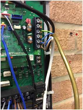

The MIM-B19N connects to F1/F2 (which is the internal Samsung NASA bus). The installation instructions tell you to put it in the outside unit, but of course, it is an RS485 bus so you can equally connect it (more conveniently) at the indoor unit F1/F2 connections, doh!
Mine has been running reliably for years now. The only trouble it has given was locking up after a few months. I was polling Modbus too fast (10ms), reducing to 50ms and it has been reliable ever since.
So you now have a Modbus RTU interface (RS485). You now need a USB\<-\>RS485 convertor to get it into the PC. You could use one of the cheap FTDI convertors
> **[Industrial USB to RS485 Converter, Original FT232RNL and SP485EEN](https://www.waveshare.com/usb-to-rs485.htm)**
but I prefer to galvanically isolate systems from each other where possible, so this is a better solution
> **[FT232RNL USB TO RS232/485/422/TTL Interface Converter, Industrial Isolation](https://www.waveshare.com/product/usb-to-rs232-485-422-ttl.htm)**
A bit of 2/3 core wiring, 120R Modbus termination resistor and you’re done.

In your MIM-E03 controller (may be within the Indoor Unit if you have one, or a standalone box if you don’t), you’ll see the controller circuit board which contains a 6-terminal block labelled F1-F2-V1-V2-F3-F4:
- F1/F2 are used for serial communication with the Outdoor Unit
- V1 is a 12V DC supply
- V2 is digital ground
- F3/F4 are used for serial communication with the Remote Controller (MWR-WW10N)
Here’s a photo showing my (gold coloured) cable wired to F1/F2 which goes to my RS485-to-Ethernet adapter, in parallel with the white cable which goes to the Outdoor Unit F1/F2.
 ![image](https://community.openenergymonitor.org/uploads/default/original/3X/b/b/bb01837e6c064dd9a5972246c1caeec99a3c74b8.jpeg)
So as @toadhall says, everything you need for your MIM-B19N is here - comms to F1/F2, 12V supply to V1, and the earth to V2 (if you need this).

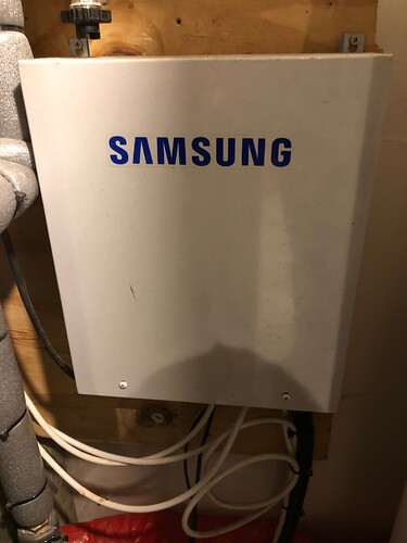

I have an MIM-E03 (probably, but I’ve not yet taken the lid off)
 ![IMG_8883](https://community.openenergymonitor.org/uploads/default/original/3X/6/0/60a0d1525c72a1baf650e65fbbb62ea276961949.jpeg)
… and a so-called wired remote controller…
 ![IMG_8884](https://community.openenergymonitor.org/uploads/default/original/3X/3/1/31570d812c8104f255196e2935d3607e879b32af.jpeg)

My MIM-E03 is in an ‘airing cupboard’ near an outside wall - on the other side of which, is sited the heat pump. From what you’ve described, I can scrap the need to run any cabling from the heat pump to the airing cupboard, and simply mount the modbus unit near the MIM-E03 tap into it for my feeds to the MIM-B19-N. I then plan to take the output from there, to an RS485 converter with USB…

Yup, your newly added photo is the MIM. You’ll find the comms terminal block inside on the right.
