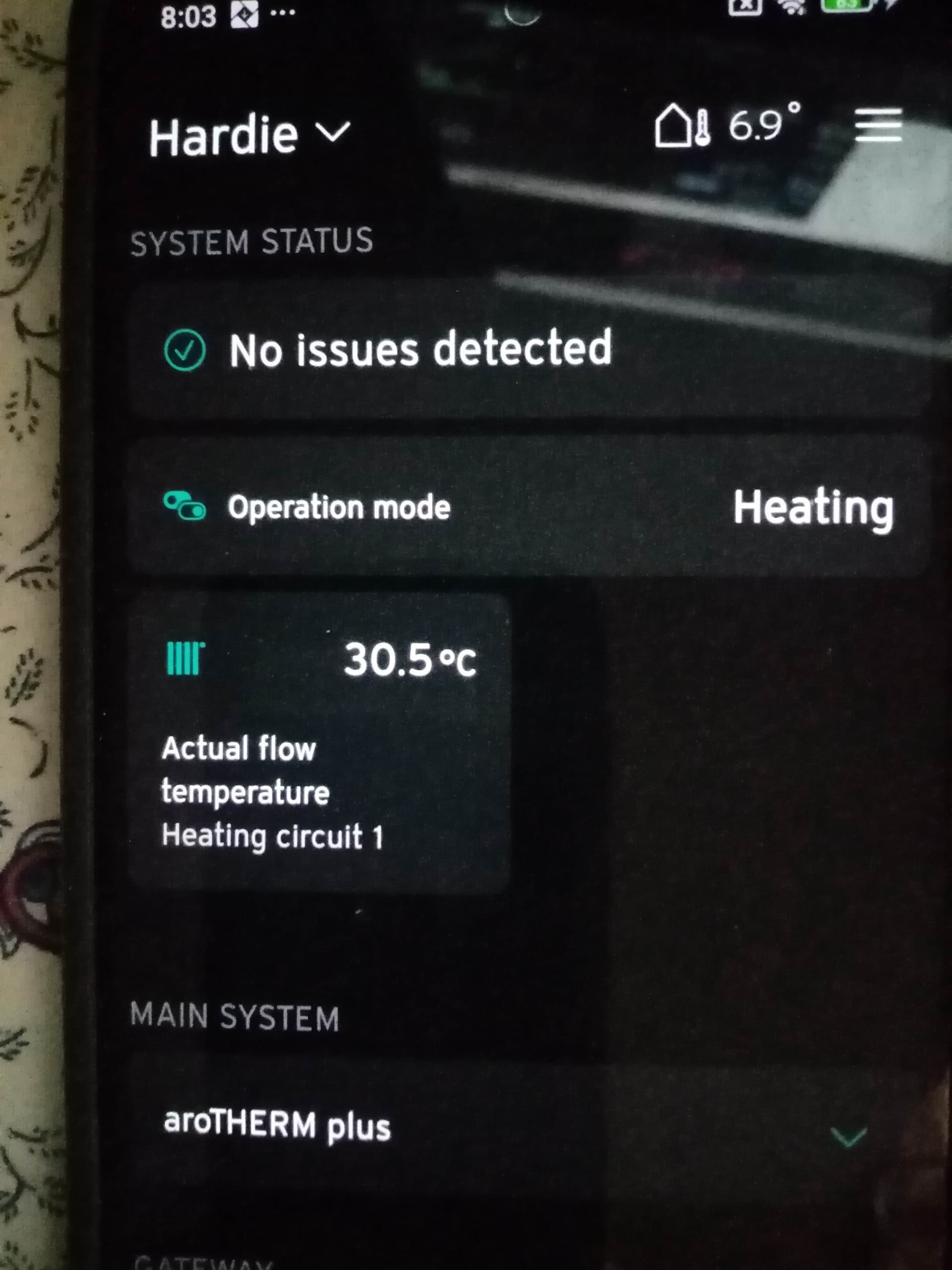

Hi. I noticed that in myVaillant app V2.x the system pressure was available but
cannot find it in versions 3.x. Maybe I missed it ?
It is also seems to be absent from the output of myPyllant.export, so suspect Vaillant
is not supporting it.
Short of physically going to the plant cupboard or using the VWZ-ai control or installing an ebus adapter anyone know of any way of reading system pressure remotely ?
Thanks,
Nick

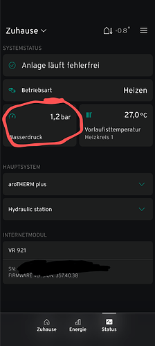

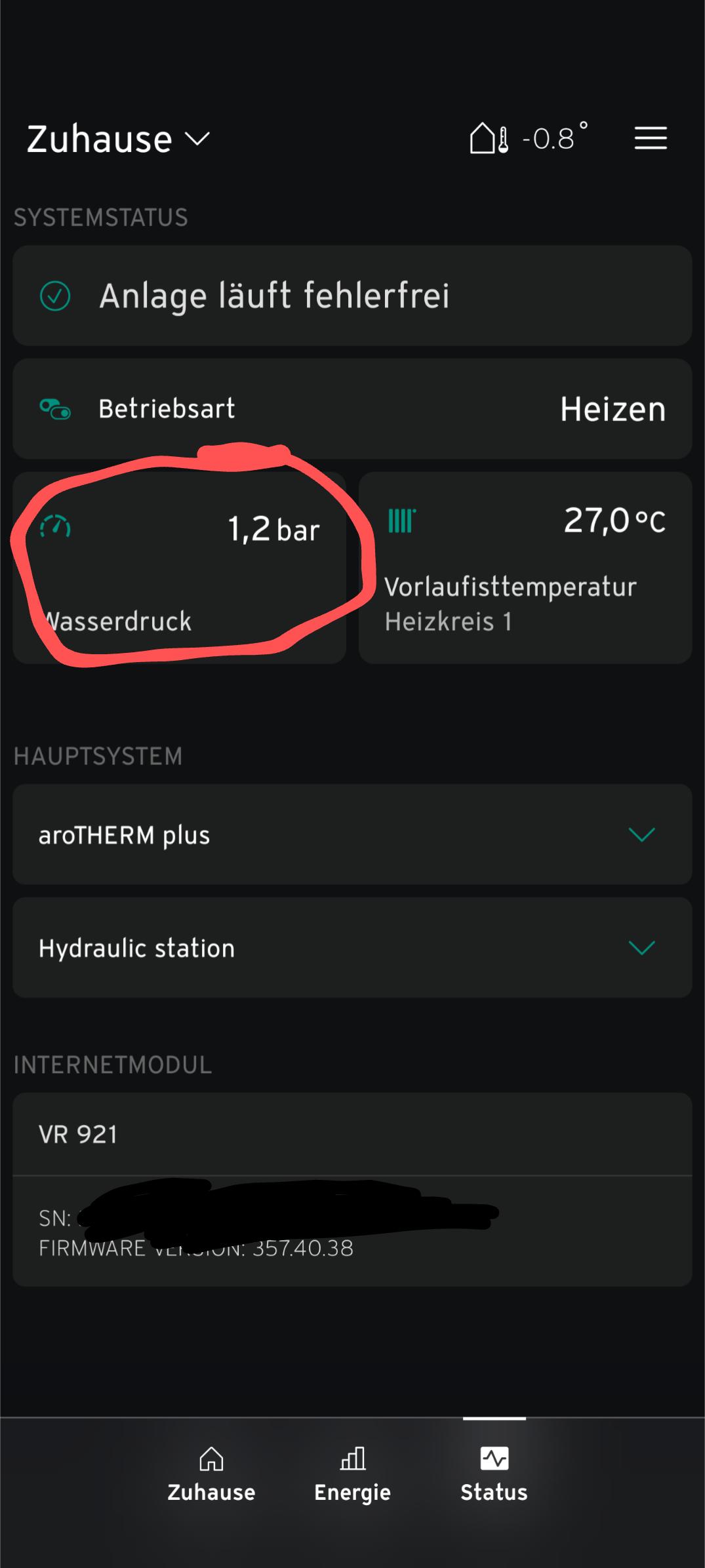

Hi Nick,
for me, it’s right in the “Status” tab accessible in the bottom when you open the app. I’m on version 3.40.

I have it connected to vr 940f.
It’s a shame there isn’t more useful info in the app.
Hi Andre. Unfortunately mine only shows flow temperature, current power use, running time and on/off cycle count.
I don’t have the hydraulic station, and the gateway is a VR940f whereas yours is a VR921.
I am also on app version 3.4.0.
Interesting you have the system pressure as well.
Cheers,
Nick

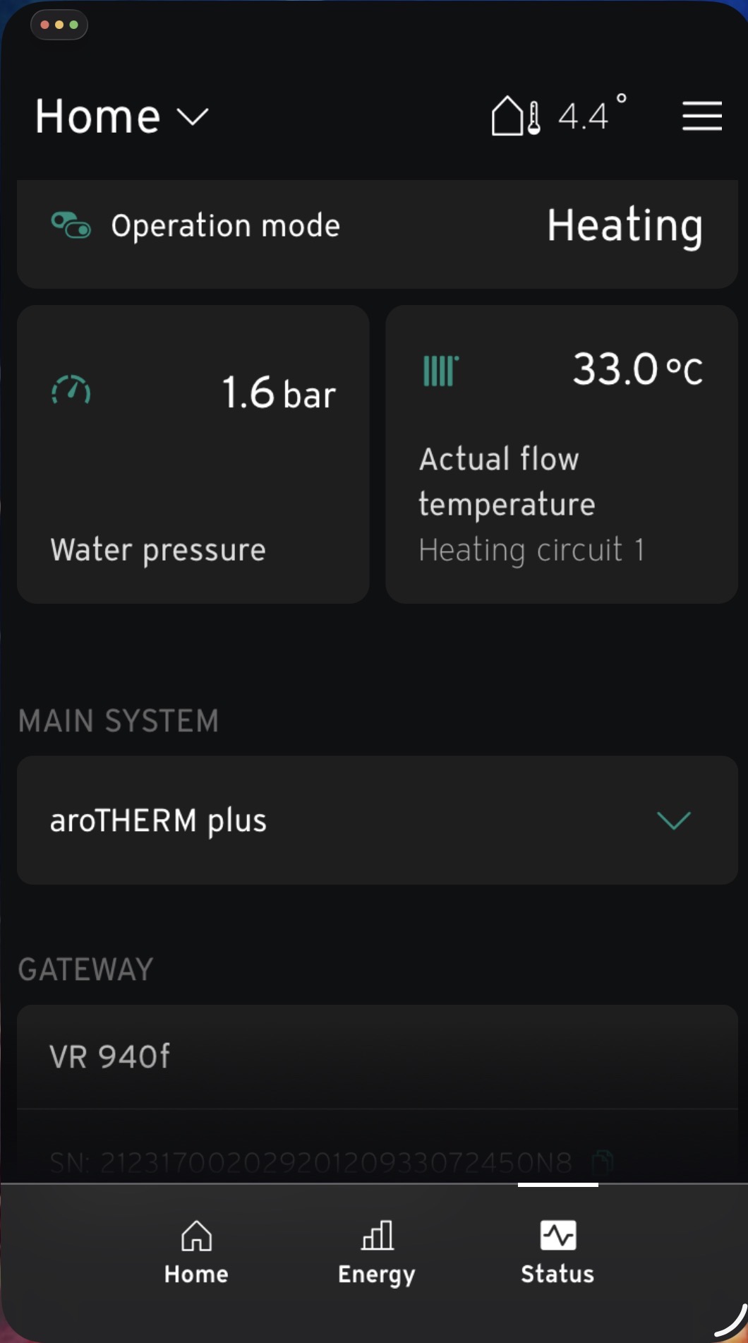

It’s present for me with a 940f and app 3.4. Also shows in home assistant via mypyllant.
That’s interesting Andy. I only have the one box below Operation mode / Heating
What’s your Arotherm Firmware version ?
Mine’s 404.1.28 .
