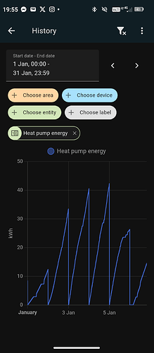

**Author:** ![scigulinsky](https://community.openenergymonitor.org/user_avatar/community.openenergymonitor.org/scigulinsky/32/32962_2.png) [@scigulinsky](https://community.openenergymonitor.org/u/scigulinsky)\
**Post date:** [6 January 2025 20:21 UTC](https://community.openenergymonitor.org/t/pushing-for-cop-5-on-daikin-edla08e2v3/25446/39 "2025-01-06T20:21:59Z")
![Screenshot_20250106-195556](https://community.openenergymonitor.org/uploads/default/original/3X/d/d/dd96969ffe6cf8c0e2b696171d5701bd51deef74.png)
I will check your setting, so far I have tweaked it a bit and the efficiency is so much better already without compromising the heat (we do like to have house at 21-22 degrees) and same foe water as family of 5. I am surprised that small changes can make massive difference. I have digital trv on most radiators but my best indicator is happy wife 🤣
