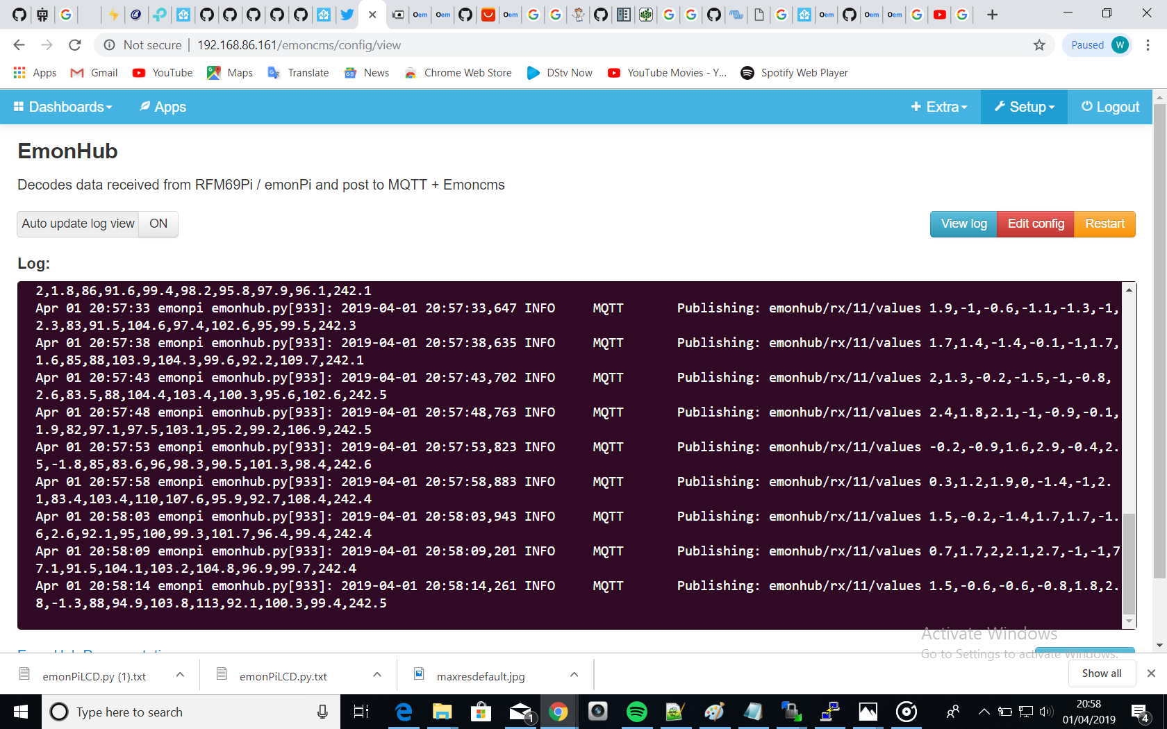

@pb66 @Robert.Wall. Thank you much appreciated, i think i have opened the door to allot of work ,with the 20x4, but its worth the time,looks great and worth the effort.Thank you, to both off you, without your help, i would not have likely, in anytime soon, solved the mystery of the 20x4, high 5 🖐

Hi @pb66 wonder if you may know off the top off your head.
```auto
 [mqtt]
mqtt_user = emonpi
mqtt_passwd = emonpimqtt2016
mqtt_host = 127.0.0.1
mqtt_port = 1883
mqtt_emonpi_topic = emonhub/rx/11/values
mqtt_feed1_topic = emon/emonpi/RP1
mqtt_feed2_topic = emon/emonpi/Vrms
that is working fine with the values, that’s in the lcd.cfg file emonhub/rx/11/values it displays 100% on page 3.
what i am trying to figure out is the following, as its coming from the RPI that is writing to mqtt is the temperatures it has no rx/values. So i cannot use a basedata[2,3,4…ect], if i use a number eg: 7 it does wright that value in, as the board has got 15 inputs being logged.
Obviously the script created a different node.

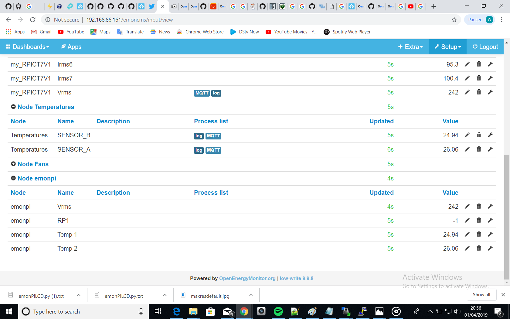

**Author:** ![tonertiffi](https://community.openenergymonitor.org/user_avatar/community.openenergymonitor.org/tonertiffi/32/9427_2.png) [@tonertiffi](https://community.openenergymonitor.org/u/tonertiffi)\
**Post date:** [1 April 2019 18:59 UTC](https://community.openenergymonitor.org/t/problems-with-gpio-push-button-on-self-build-emonpi/10347/146 "2019-04-01T18:59:43Z")
@pb66
 ![temp_1](https://community.openenergymonitor.org/uploads/default/original/2X/b/b4f2f205218646e78c7ce822f56d0c60064c12e8.png)
**Post date:** [1 April 2019 19:00 UTC](https://community.openenergymonitor.org/t/problems-with-gpio-push-button-on-self-build-emonpi/10347/147 "2019-04-01T19:00:19Z")
@pb66
 ![temp_2](https://community.openenergymonitor.org/uploads/default/original/2X/1/1d69066a26b9291375fb900ffd99af1b0deb2253.png)

**Author:** ![pb66](https://community.openenergymonitor.org/user_avatar/community.openenergymonitor.org/pb66/32/27_2.png) [@pb66](https://community.openenergymonitor.org/u/pb66)\
**Post date:** [1 April 2019 21:56 UTC](https://community.openenergymonitor.org/t/problems-with-gpio-push-button-on-self-build-emonpi/10347/149 "2019-04-01T21:56:15Z")
I’m not entirely sure I’m understanding your question 100%, but if you are asking how to display the temp values from the script we previously put together, I see 2 things that spring to mind from what you’ve said.
First, the basedata is the values from the emonpi add-on board, the temp sensors are handled by the RPi directly so they would not be in that payload. Therefore you must use the other “mqtt\_feed\_topic” method to get those values.
Secondly, the topic format you chose for the temperature value in the original script didn’t look right to me, but since you had it working and I just helped add more sensors, I stuck with it. IMO and now your MQTT printout sort of confirm my suspicions. The topic should be `emon/Temperatures/SENSOR_B` not `emon/Temperatures/SENSOR_B/values`. I’m not entirely sure where the `/values` part came from or what impact using it (or not using it) might be, I just didn’t recognise it and it now sticks out like a sore thumb in your MQTT output.
You will need to change the `elif page == 5:` code to resemble the `elif page == 3:` code and use a couple of new feeds to display the temp data eg
```auto
    elif page == 5:
        if r.get("feed1") is not None:
            lcd[0] = feed3_name + ':' + r.get("feed3") + feed3_unit
        else:
            lcd[0] = feed3_name + ':' + "---"
        if r.get("feed2") is not None:
            lcd[1] = feed4_name + ':' + r.get("feed4") + feed4_unit
        else:
            lcd[1] = feed4_name + ':' + "---"
for this to work you will need to add the 2 new feeds to the `on_message` and the `on_connect` functions as well as in the config parser section at the top of the script and of course, in the cfg file you will need to add the topic, name and units for both too.
There are of course many different variations on how you could do it.

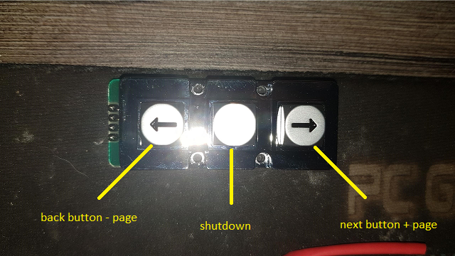

**Post date:** [19 April 2019 08:34 UTC](https://community.openenergymonitor.org/t/problems-with-gpio-push-button-on-self-build-emonpi/10347/159 "2019-04-19T08:34:45Z")
Hi @pb66 hope you well, you guessed i found something else to mess with,below is the item, its a 3 way button push, i am sure by the picture you can determine what i plan to do with it.
i have been studying the lcd code, determined i would have to add a new gpio pin for the 3rd button, that would seem easy, i can also see the page +=1 that i assume, as the button is pressed, it goes to the next page, do you know off any easy way off achieving a back button?
**Post date:** [19 April 2019 08:58 UTC](https://community.openenergymonitor.org/t/problems-with-gpio-push-button-on-self-build-emonpi/10347/161 "2019-04-19T08:58:08Z")
Hi, not offhand no sorry. I would need to study the code over again and to be honest, I would do it a completely different way. As I mentioned previously in response to you saying things go wrong if you press the button too fast, the button presses should be counted then executed, I’m not keen on every press opening a page, it’s too slow and error prone.
**Post date:** [19 April 2019 09:07 UTC](https://community.openenergymonitor.org/t/problems-with-gpio-push-button-on-self-build-emonpi/10347/162 "2019-04-19T09:07:05Z")
I Kinda agree with you on that, it makes 100 % what you saying, so far i must say you have added functionality to the product that that is mind blowing, i am sure a lot of readers have implemented the code that you have put together. what i love about your way, off doing it is, it works and keeps working, so if you can once again help me here, i would greatly appreciate any help or suggestions. Thank you again
**Post date:** [19 April 2019 09:14 UTC](https://community.openenergymonitor.org/t/problems-with-gpio-push-button-on-self-build-emonpi/10347/163 "2019-04-19T09:14:38Z")
> [@tonertiffi](#):
If I get the time (and the urge) I might take a look, but please do not rely on me to do it, have a go yourself.
