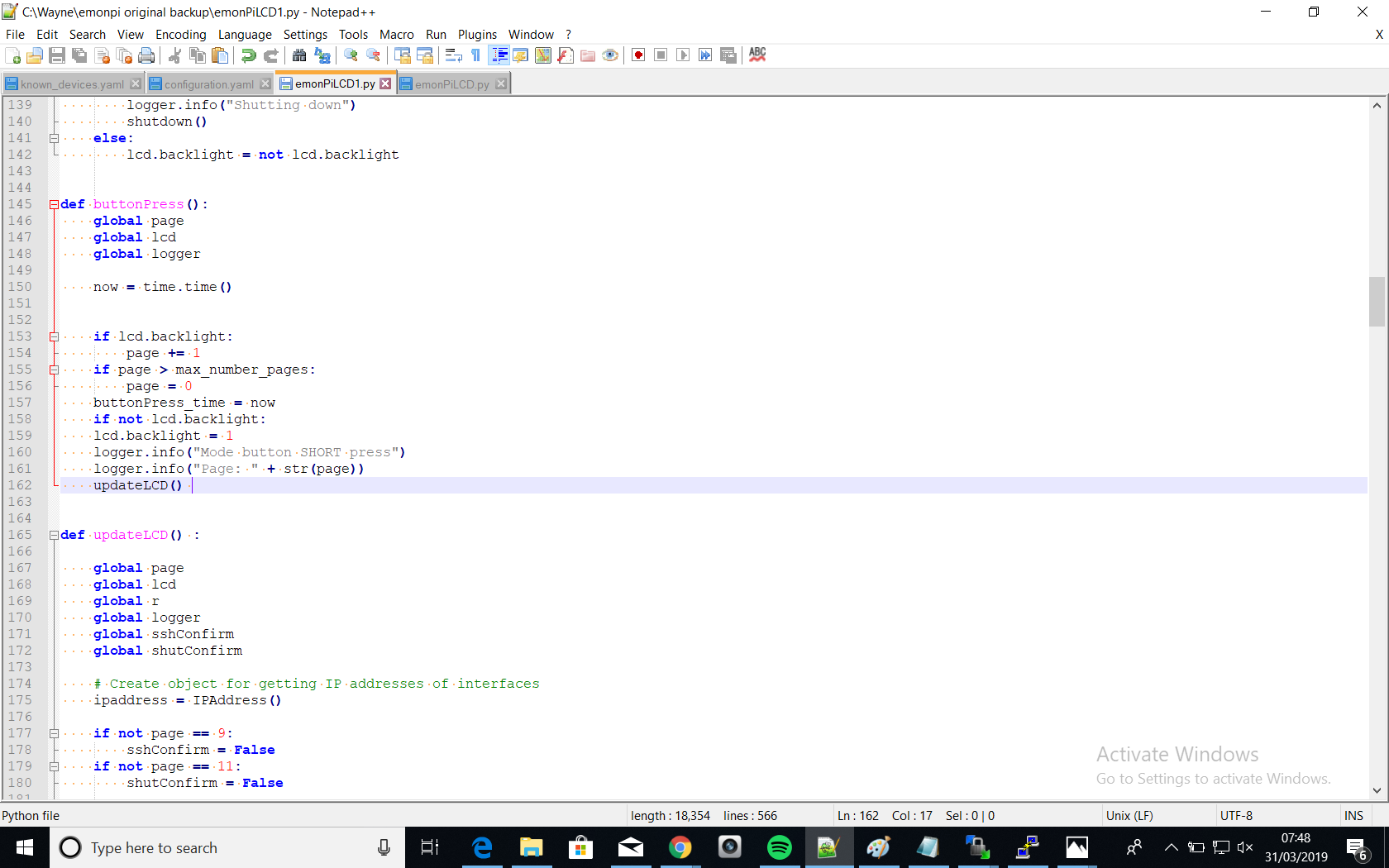

**Author:** ![tonertiffi](https://community.openenergymonitor.org/user_avatar/community.openenergymonitor.org/tonertiffi/32/9427_2.png) [@tonertiffi](https://community.openenergymonitor.org/u/tonertiffi)\
**Post date:** [31 March 2019 05:51 UTC](https://community.openenergymonitor.org/t/problems-with-gpio-push-button-on-self-build-emonpi/10347/115 "2019-03-31T05:51:08Z")
As always you a star.
I have notepad++ and set to look at white spaces and tabs,compared the 2, at the point that it stops, cant find a fault.
this is the error i get
```auto
pi@emonpi:~/emonpi/lcd $ sudo python emonPiLCD1.py
  File "emonPiLCD1.py", line 159
    lcd.backlight = 1
IndentationError: expected an indented block
**Post date:** [31 March 2019 05:51 UTC](https://community.openenergymonitor.org/t/problems-with-gpio-push-button-on-self-build-emonpi/10347/116 "2019-03-31T05:51:48Z")
![lcd_mod_1](https://community.openenergymonitor.org/uploads/default/original/2X/3/37f86ee73c1f750951de480cd3df277334e9cfa2.png)
**Author:** ![pb66](https://community.openenergymonitor.org/user_avatar/community.openenergymonitor.org/pb66/32/27_2.png) [@pb66](https://community.openenergymonitor.org/u/pb66)\
**Post date:** [31 March 2019 08:00 UTC](https://community.openenergymonitor.org/t/problems-with-gpio-push-button-on-self-build-emonpi/10347/118 "2019-03-31T08:00:44Z")
Line 159 needs to be indented further as it is the code that only runs if the previous “if” line dictates, so you’ll need to add the 4 spaces to indent it correctly.

Hi @pb66 understood, tried new edit, get this as a result.
```auto
pi@emonpi:~/emonpi/lcd $ sudo systemctl stop emonPiLCD
emonPiLCD logging to: /var/log/emonpilcd/emonpilcd.log
I2C LCD DETECTED Ox27
  File "emonPiLCD1.py", line 565, in <module>
    main()
  File "emonPiLCD1.py", line 449, in main
    lcd = LCD(logger)
  File "emonPiLCD1.py", line 391, in __init__
    self.lcd = lcddriver.lcd(int(current_lcd_i2c, charCount))
ValueError: invalid literal for int() with base 20: '0x27'
