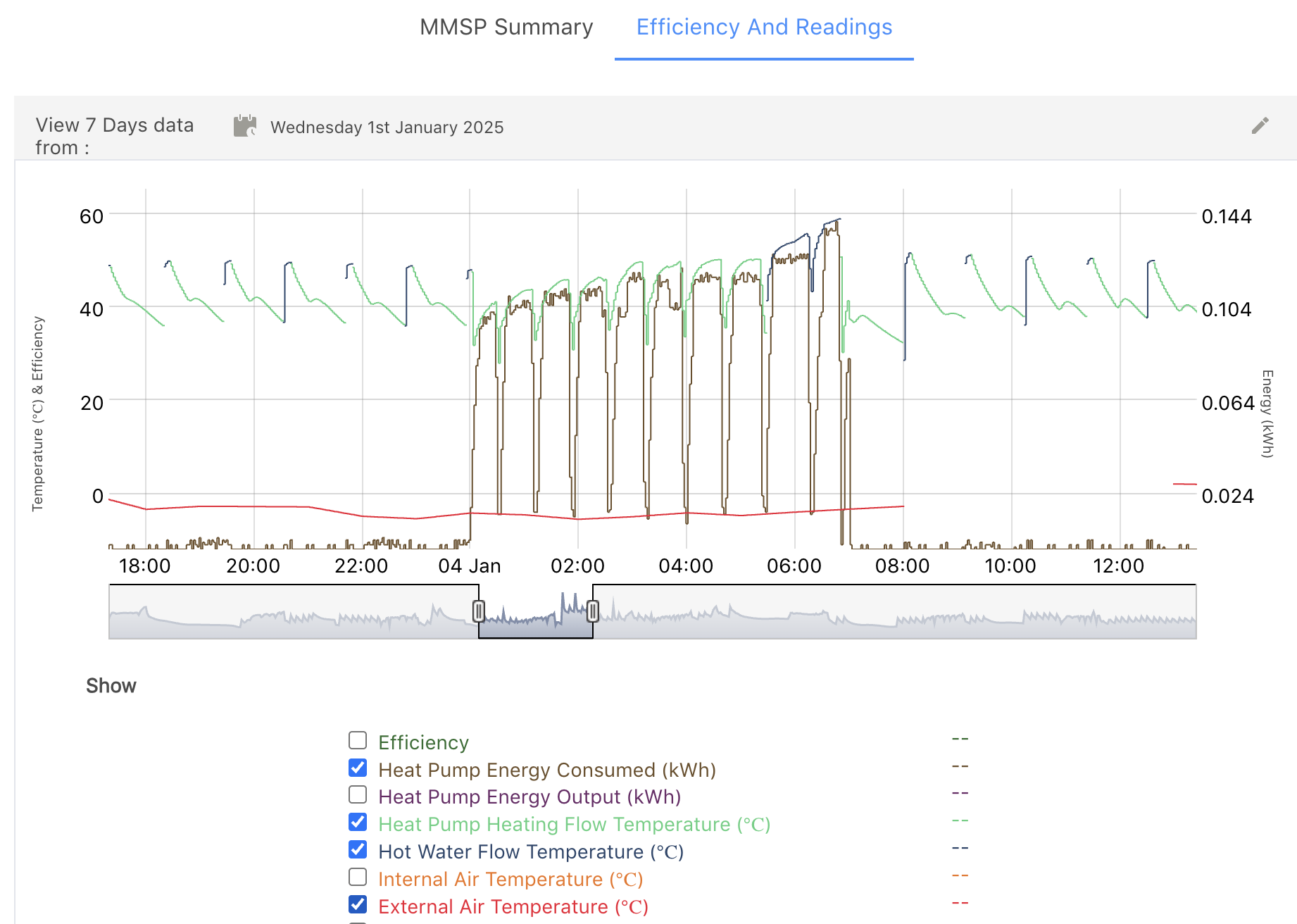

I use cheap overnight electricity to heat my DHW. I have a good size hot water tank and a very large buffer (750l or so). Normally this works well, but when it is cool, the defrost cycle switches the divert valve to take from the DHW, reducing the DHW temperature about a degree each time. I rapidly have no hot water! Essentially I do not want it to turn the divert valve, and instead to take from the buffer. But there is no obvious option to do this. I have a modbus unit that I haven’t connected yet. I was wondering if there was any way of overriding the divert value? Preferably an elegant way rather than a bodge!

**Post date:** [12 July 2025 22:31 UTC](https://community.openenergymonitor.org/t/problematic-samsung-gen6-defrost-cycle/27374/6 "2025-07-12T22:31:03Z")
I’ve had a careful look at this again, and you’re absolutely right. The defrost takes from whatever source the ASHP has most recently been heating. See attached.
 ![Screenshot 2025-07-12 at 23.23.00](https://community.openenergymonitor.org/uploads/default/original/3X/4/7/47e2ef886dc7ef8b90dbb46dbec101b7d38dc58a.png)
What seems to be happening is when the outside temperature is around zero and then the defrost cycle is taking from the DHW. I’m assuming this is the default. Some time ago Samsung technical suggested building in a 5-minute delay to the relay so it misses the signal.
