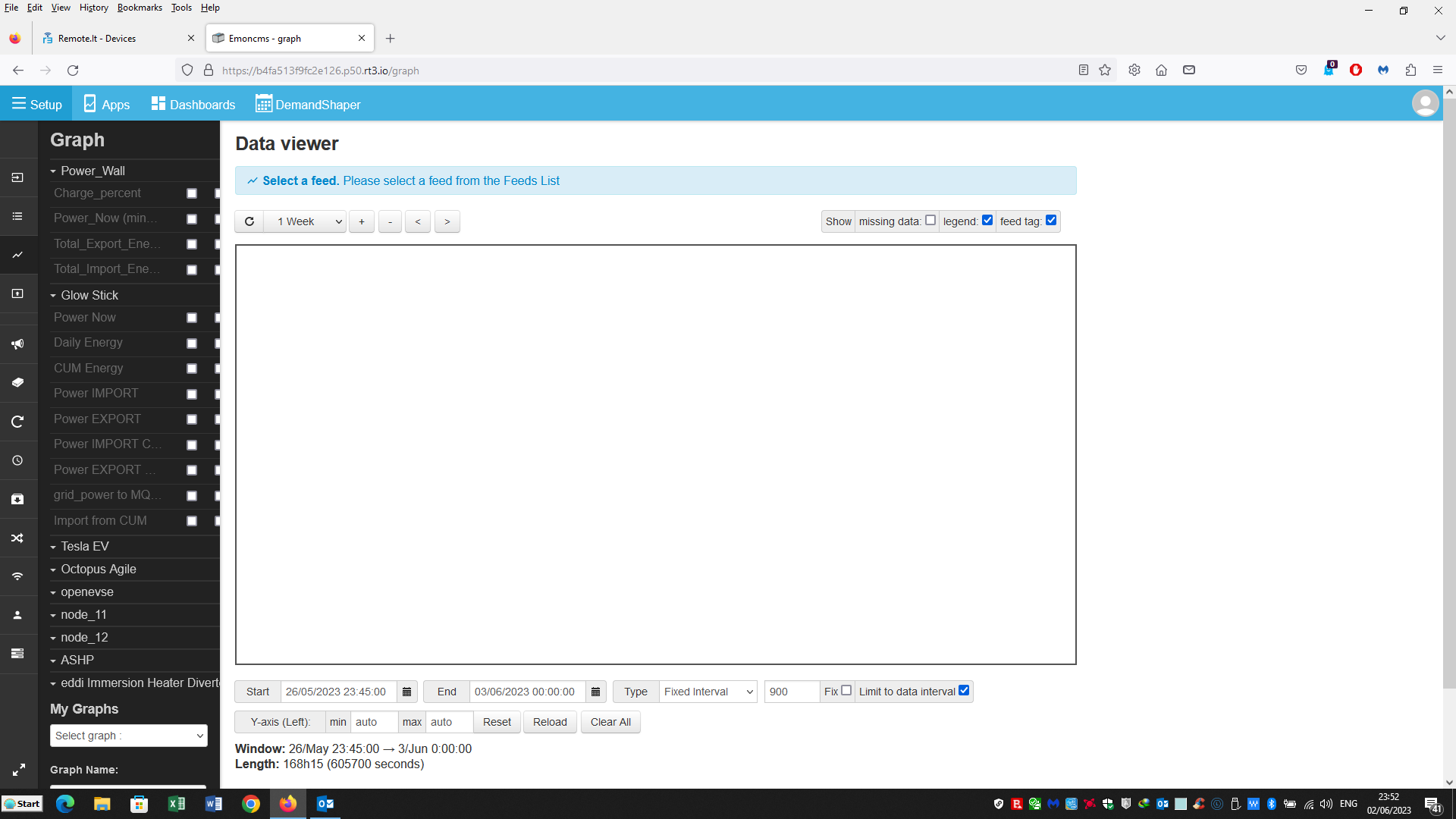

Problem with Data View - Graph
Please see the ScreenShot …
The right hand Graph tick boxes are almost obscured.
I first noticed this problem a few days ago whilst running low write 11.0.9
Have since updated to low write 11.3.20
But the problem still persists
Any suggestions - thanks

Hello @johnbanks I think this is being caused by the ‘eddie immersion heater’ node name which is quite long and likely pushing out the positioning?
@TrystanLea
That was the problem
Many thx
