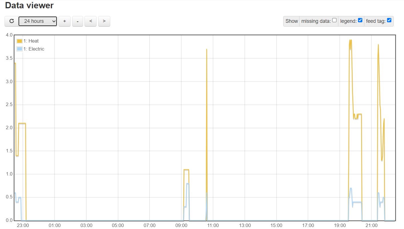

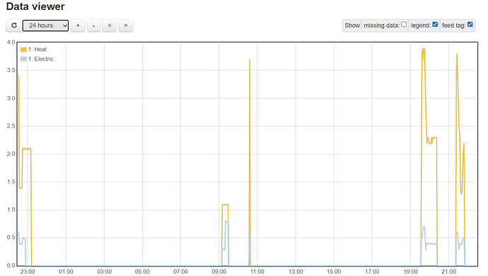

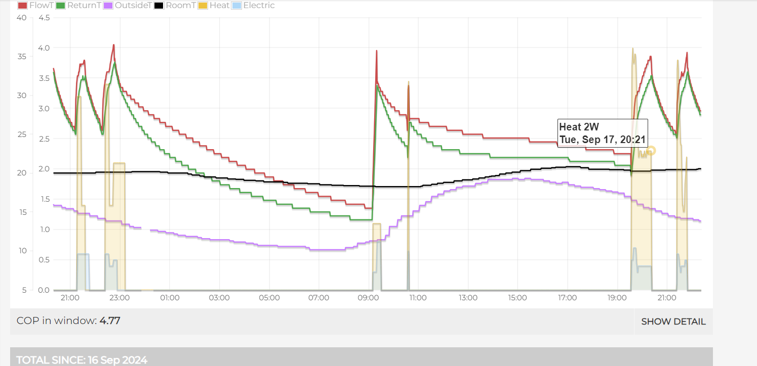

I’ve a silly problem with the kW units, which are being interpreted as Watts. In Home Assistant, they are seen as kW, so they should be arriving to Emoncms as kW too, and the input item is configured as kW, but it’s clearly being displayed or tagged as being in Watts
But in the Data Viewer, they indeed appear to be correct
Timbones
(Tim)
7

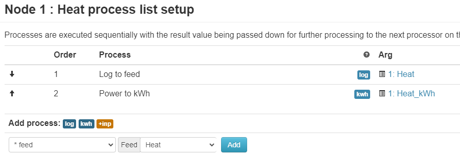

My Heatpump app requires the power feeds to be in watts.
You can multiply the input by 1000 to the same or different feed, or create a virtual feed that does the same.
championc
(Cormac Champion)
8
How do I multiply this by 1000 ? I don’t see an option to * by a value in the dropdown list
Timbones
(Tim)
9
Look for x under “Calibration”.
