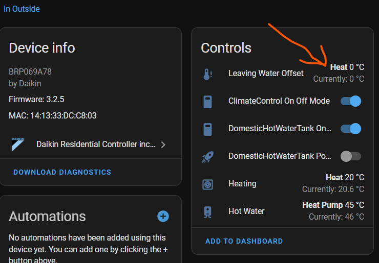

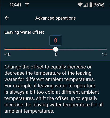

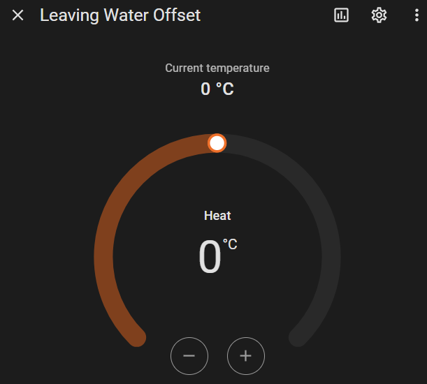

yes, do a backup 1st, so you have a rollback plan, then remove the HACS original integration and manually install the fork (it’s the same dev, but the fork does not rely on another contributor, he is a nice guy (HACS on the way) and I have sponsored his efforts), install the ‘samba share’ add-on and copy the repo via file explorer, restart, and add back the integration, it’s not too difficult, note the sensor names changed.
The system has been working really well at an outside temp of ~2 with my flat ish WDC, so my thinking is for uber efficiencies outside this operating window, I can ‘automate’ and add some external non-daikin logic and control while not screwing up the system and just using an offset, so, if the house either does not cope with high or low shoulder temps. eg
eg
if outside temp is \<2 (based on multiple sensors)
set offset +1 (via the cloud API integration)
else
set offset 0 (via the cloud API integration)
and the reverse
if outside temp is \>8
set offset -1
else
set offset 0
Maybe run the automation every ~60 mins, so not to make loads of API calls, and continuous variation within the HP’s own logic.
Values TBC based on experimentation; I have no idea yet :-), would be good to get any feedback from others who use the offset paradigm.
I use Node Red for my automations and visually easy to apply intention and logic.
hope this makes sense?
 ![image](https://community.openenergymonitor.org/uploads/default/original/3X/3/e/3eb8ff9f7fe6da4b3706df867893afbb3bc9679c.png)
 ![image](https://community.openenergymonitor.org/uploads/default/original/3X/a/4/a483736f731ef5d7d353796573dcd6370175f8b4.png)
 ![image](https://community.openenergymonitor.org/uploads/default/original/3X/9/9/99a7a3df44d75bd26cc92d16c8e86c6127705a20.jpeg)

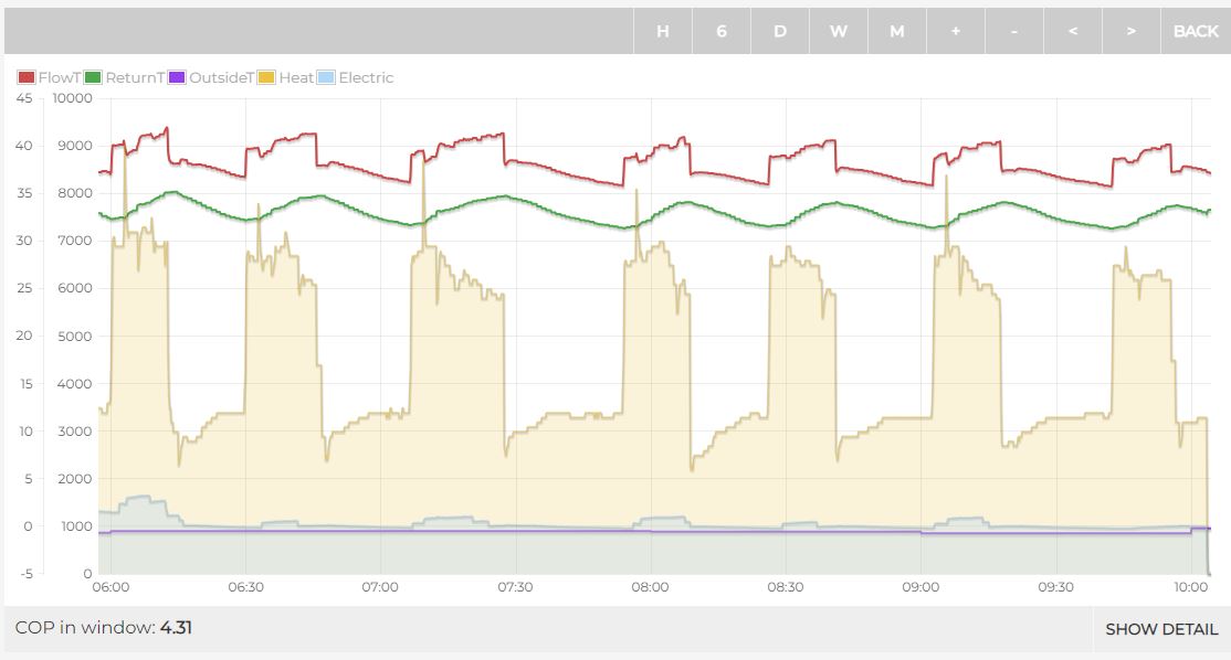

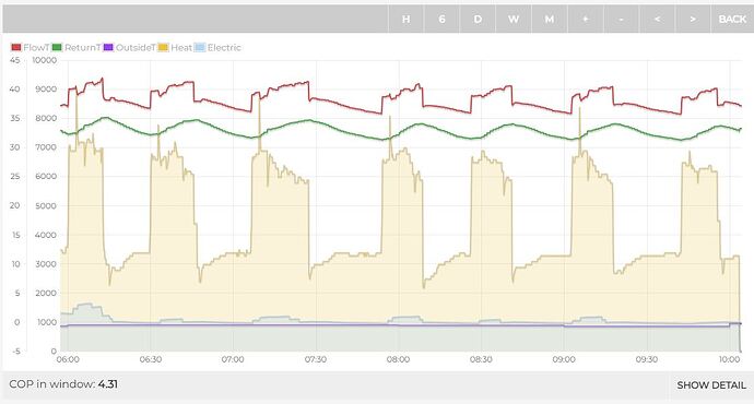

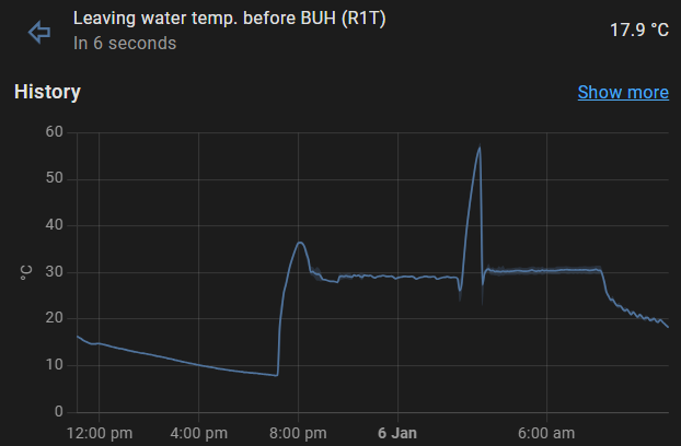

Personally, (caveat - with the right sized system) I think it’s best to let the Daikin manage itself with the Madoka and modulation, but influence the offset, again without being to intrusive from the intention of the manufacturers design or operation and years of experience with predetermined parameters that I guess fit 80% of use cases and houses.
I think modulation is meant to influence the offset, but we have not gotten cold enough yet for me to notice any real results, we are currently at a steady ~30 degrees LWT and ok to maintain room temps. However, it did change from~29 to ~31 either side of the DHW cycle, maybe it’s working but very subtly?
![image](https://community.openenergymonitor.org/uploads/default/original/3X/5/7/57e954a371942764c52a4cd78c09e6b0ea63838a.png)

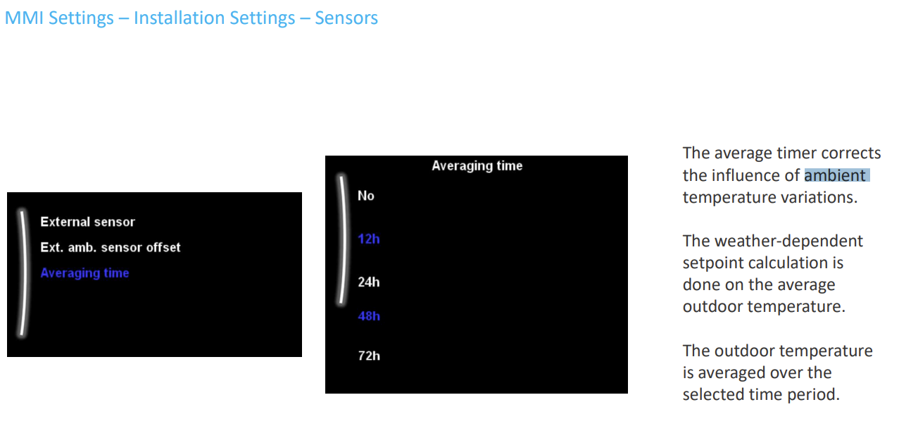

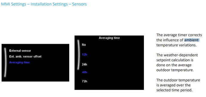

You can change the sample size of the ambient outside temps, this may slow down the modulation and change of the LWT. way too many Daikin parameters to tweak 🙂 (ours is set to ‘no’)
 ![image](https://community.openenergymonitor.org/uploads/default/original/3X/d/8/d89658faf7b5ee4ae3fd97d3f0f348b8043c5977.png)
