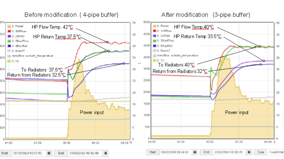

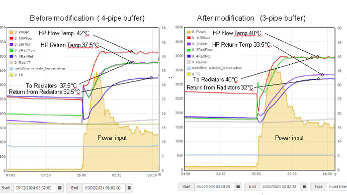

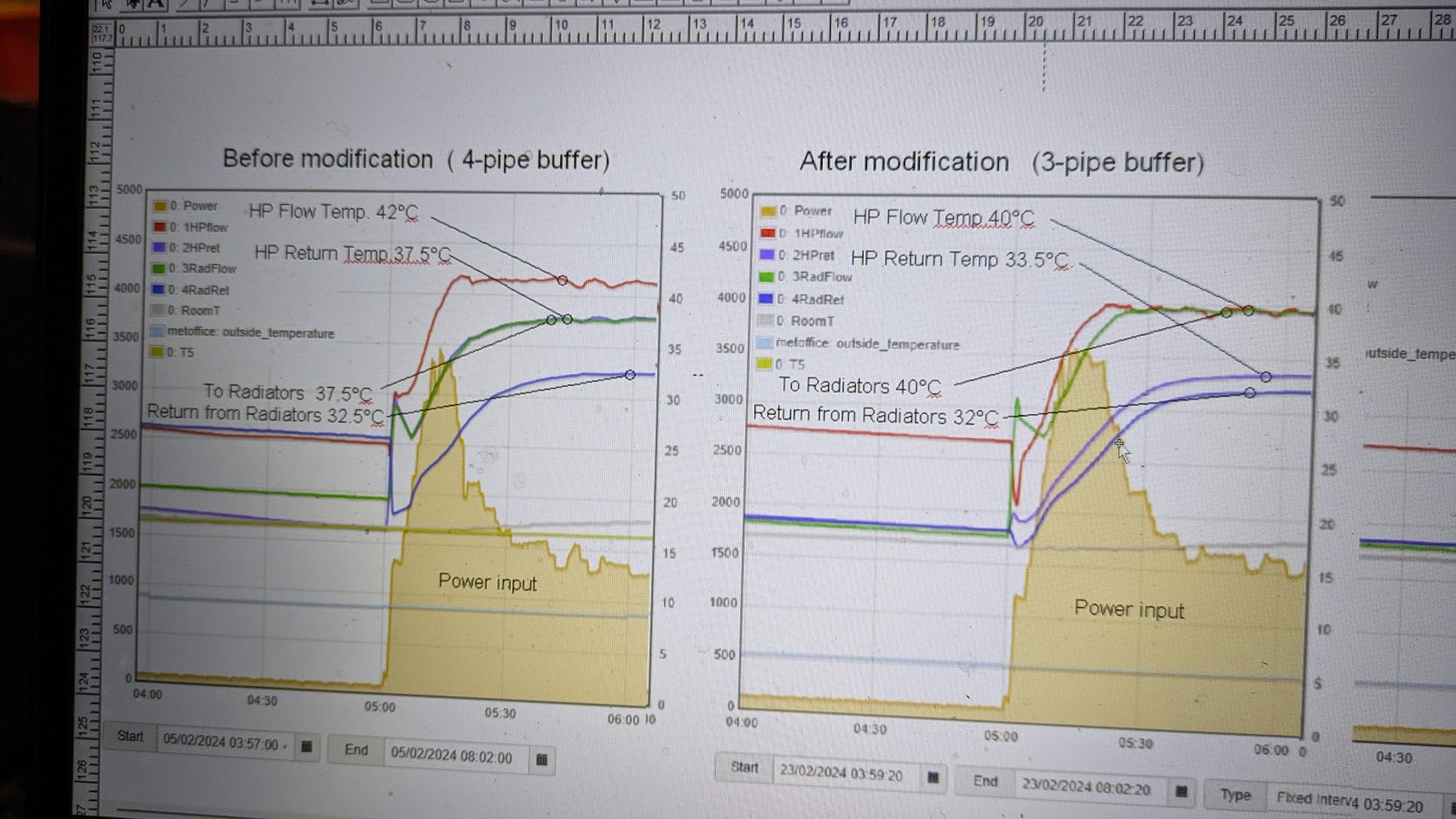

This is where the inefficacy from a buffer tank comes from. You’re loosing 1.4C due to distortion (mixing) in the buffer tank. This means the heat pump needs to deliver 1.4C higher flow temperature compared to if it was directly connected to the system. 1.4C is not terrible, here’s an example of a recent remedial job that @johncantor was involved in:
The first graph shows the temperatures when the buffer was connected in the usual 4-pip arrangement, there’s a 4.5C drop in flow temperature due to distortion. After re-piping the buffer as a 3-pipe arrangement the distortion dropped to 0C, this allowed the heat pump to run 4.5C cooler flow temperature while delivering the same MWT into the emitters. John estimated this should improve efficiency by about 10%

Sorry, not read much of the threads here, but i did convert a system with ‘bad mixing’ buffer at bottom of DHW cylinder.. managed to reduce the flow temp by 4deg. . I chise the 3rd option, and have a before and after emoncms graph

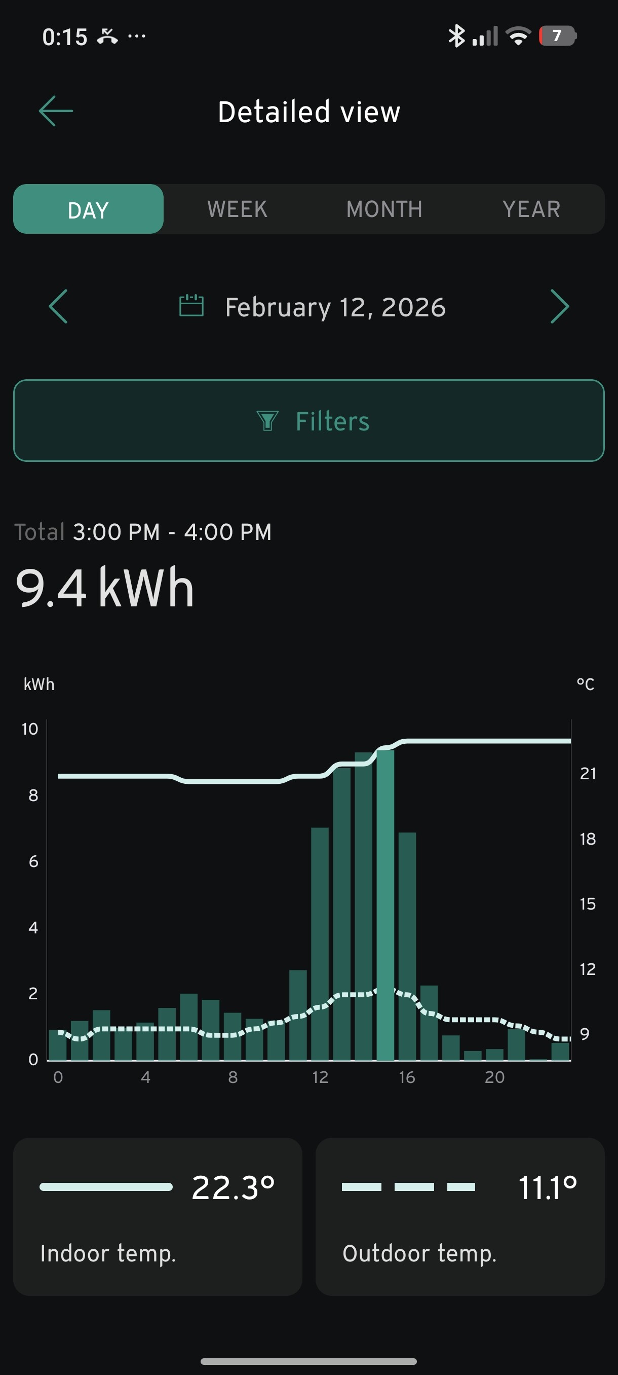

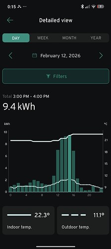

I’ve attached a screenshot of my generated heat for the test period. Discounting the “warming up” and “cooling down” periods, the middle 3 hours are 8.9kwh, 9.3kwh and 9.4kwh per hour, unless I’m reading that wrong. Outside temp did step up to 11 degrees throughout the test aswell :+1:t3:
As you can see, it was putting the heat into the house fairly efficiently over this period.
Oh, right - your peak heat output was 9.4 kW, with a significant rise in internal temperature. That seems as expected, and demonstrates plentiful heat delivery in mild weather.

So:
  • 7kW heat pump installed, on a 5.5kW calculated heat loss
  • Manages to peak at 9.5kW output in mild conditions
  • Kept the house warm while averaging 2.5kW output on a day that averaged 2c
I don’t think there’s an issue here? You have a massive headroom to keep warm in freezing conditions, it’s really unlikely you need to get anywhere near a constant 7kW output at any point.
