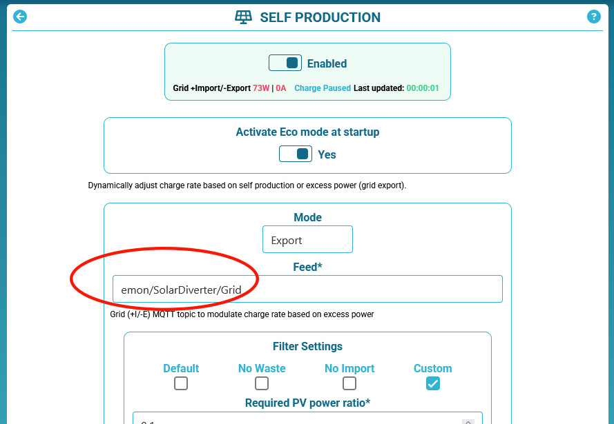

I have an openevse charge controller and a Martin Roberts based energy diverter.
The system has worked brilliantly for the last 9 years or so but recently the energy diverter had a problem which required switching it off to investigate. While the power to the diverter was off, I noticed that the car had stopped charging. When I checked the openevse app Self Production feed I found it was set to ‘emon/SolarDiverter/Grid’
Clearly this is not ideal but I can’t figure what feed to replace it with so the system will charge the car even if the diverter is switched off.
Any advice will be much appreciated.

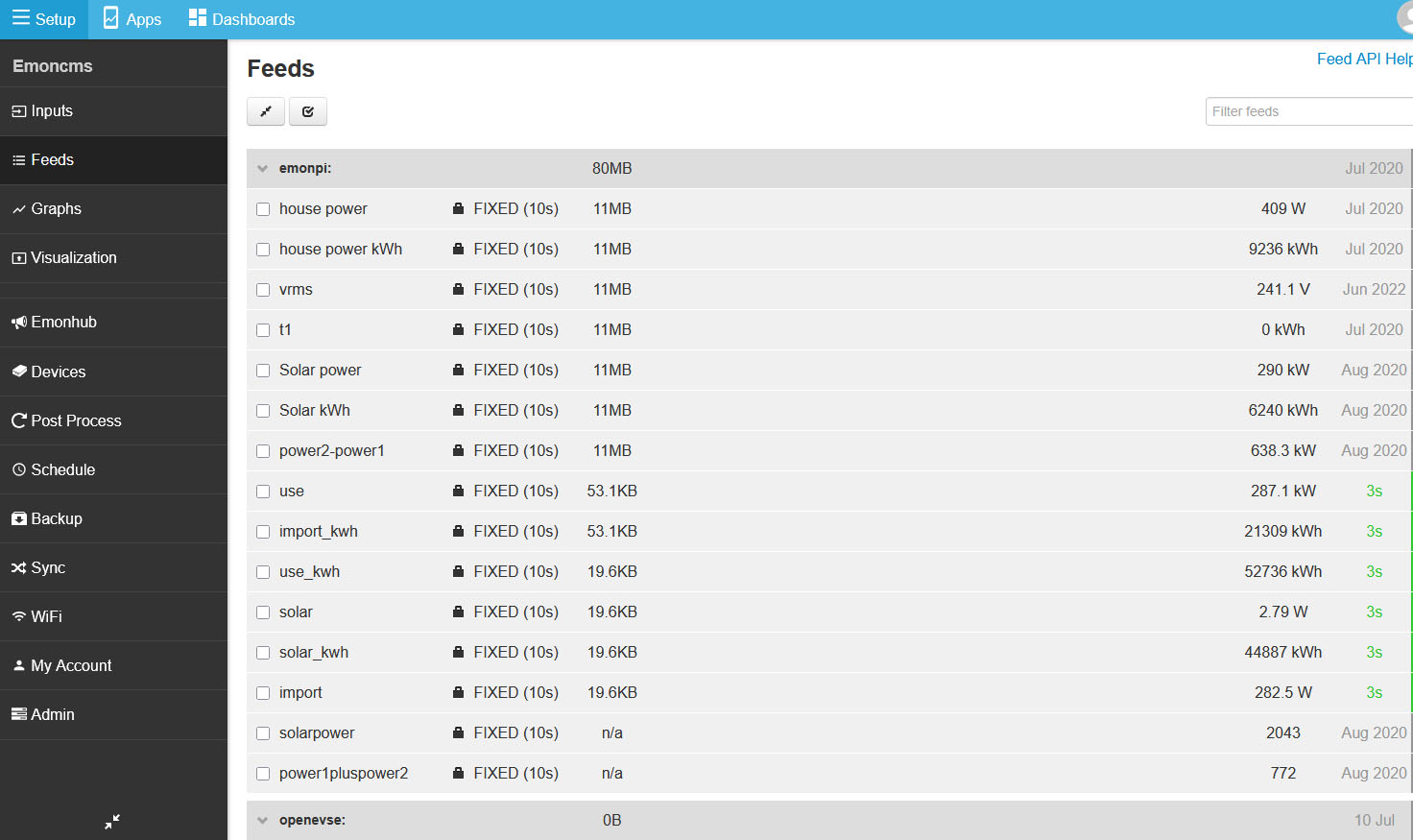

Yes, I have a rpi which provides real time data:
My system
I was hoping one of these feeds would be suitable:

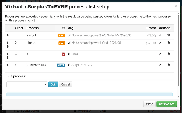

As I recall, I made a new virtual feed which was solar generation minus house consumption minus some constant ( perhaps 100W) in order to give some margin to avoid import.
Then I published that to MQTT.
Readers: Please note that it is no longer possible to publish to MQTT from a Virtual Feed. It is only possible via the Input Process List on the Inputs page. (Moderator - RW)
Here’s a screen grab of how that feed looks today - but line #2 has been changed along the way probably at the time when it was being abandoned. But it might show you the shape.

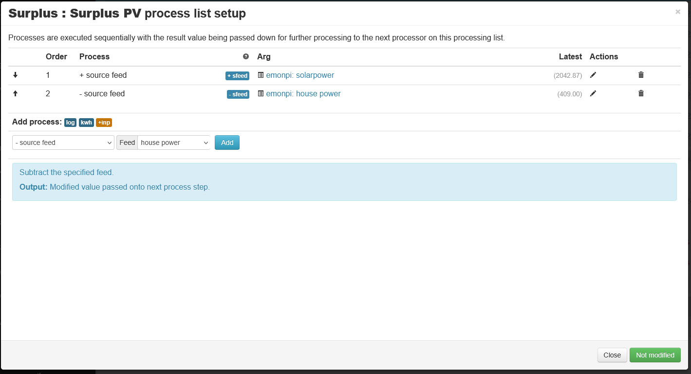

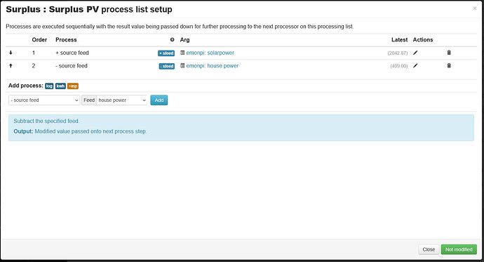

I have created a new virtual feed called ‘Surplus’ it has the attached setup entry.
The output is always NULL which presumably means it’s not right.
I’m in no way an expert with manipulating feeds like this. Do some more trial & error.
Try starting the process list with an “absolute value” set at zero?
Try using “+ input” rather than “+ source feed”?
Others with way more knowledge may chime in.

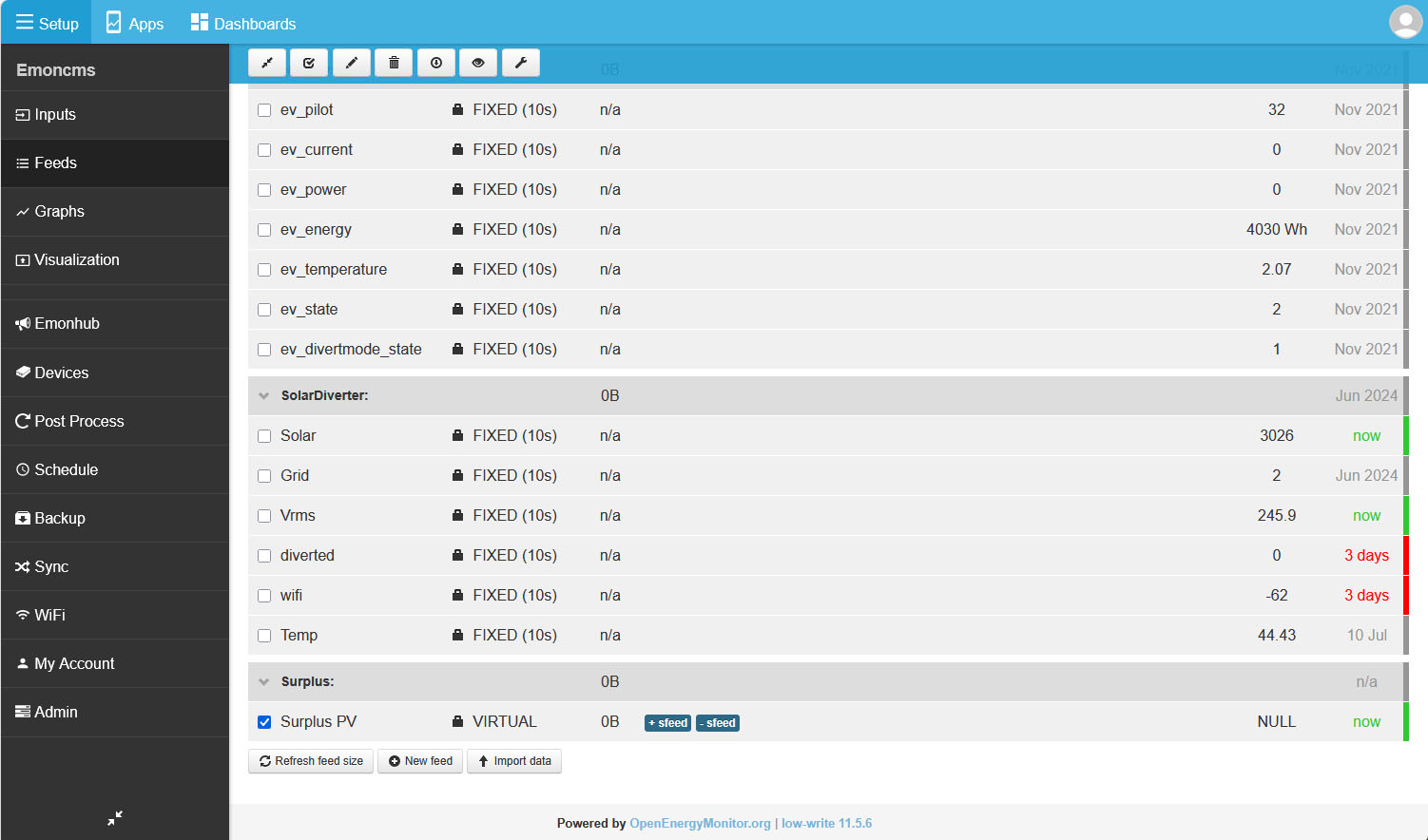

I tried an absolute value of zero and now the Feeds are all greyed out. Tried re-boot the Rpi but still grey. The system appears to be working OK though.
Before writing, I tried the same “absolute value” on my emonPi without issue. Adding it to a new virtual feed had the effect of changing a NULL value to zero, which I took as progress.
This might help, if you’ve not seen it:
Should the first process step be Source Feed, not + source feed? (Not that I think it should make any difference if you start with a definite value of Zero - but you never know :wink:.)
My understanding is, you cannot do that - maybe it has changed?
Until I am able to restore the feeds page I am stuck. Is there a reset somewhere?
I’ve done the same trying to reproduce your problem. It appears when reloading the Feeds page. This must certainly be a bug for @TrystanLea, I’ve never seen it reported before :frowning:

This is the MQTT feed of your gird, the value should be positive for import and negative for export. Also, its important that the power used the OpenEVSE is included, I.e the CT is around the main incoming cable before any henley blocks.
It should be emon/emonpi/power1 if you’re using emonPi CT1 input to monitor the grid. If your using CT2, then you should instead use emon/emonpi/power2
See the OpenEVSE setup guide: https://docs.openenergymonitor.org/emonevse/setup.html#mqtt-setup
However, I would recommend using the PV divert in ‘Generation’ Mode rather than 'Export. In my experience it works better in the mode. You are welcome to experiment YMMV.
