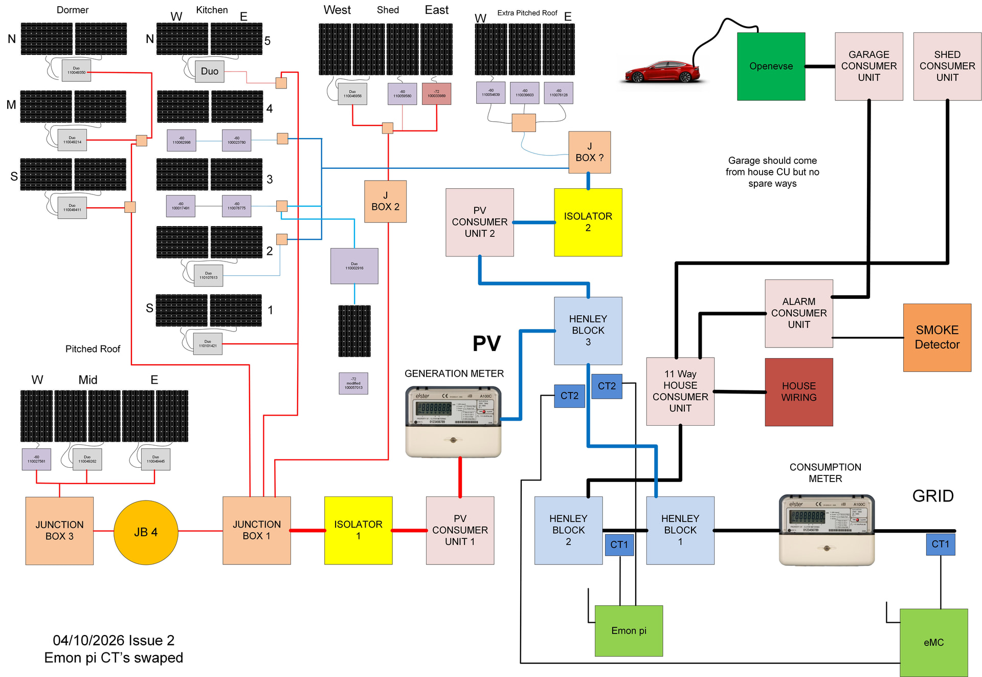

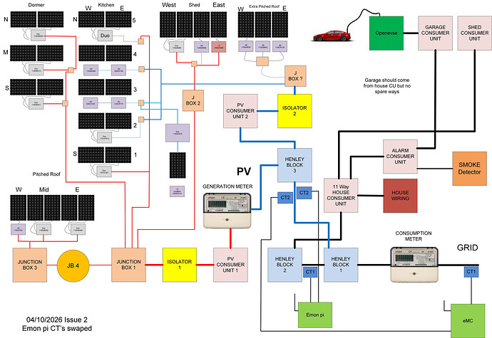

Arrgh! My problem is the diagram, I drew it about 10 years ago but failed to include any of the CT numbers. When I recently decided to publish it here to help solve my export problem, I numbered the CT’s but mixed up Emon pi CT1 and CT2. eMC CT1 and CT2 were and remain correctly labelled.
I have now changed the diagram to reflect how it is wired. I must emphasise I have not changed the position of any CT’s just changed the numbers on the diagram for the Emon pi.
The original export problem remains as before. New diagram attached

Well spotted @Robert.Wall
**Post date:** [4 October 2026 16:18 UTC](https://community.openenergymonitor.org/t/openevse-out-of-balance-with-solar/30384/23 "2026-10-04T16:18:23Z")
Looking at your corrected 4/10/26 diagram, emonPi CT1 is reading the **TOTAL** infeed¹, emonPi CT2 is reading the PV Infeed. You must not use power1pluspower2 (as we do) for total power input². What I think you need for your EV diverter is power1 **minus** power2, i.e. the power between the grid meter and Henley block 1 – which is essentially the same as eMC CT1.
Note 1. except at night, when it will miss the “stay alive” consumed power to all the inverters, which CT2 will catch.
Note 2. If you have a timing problem between emonPi power1 & power2, you could turn CT2 around and use -1.0 in “scales = …” in emonhub.conf. Then power1pluspower2 will actually be power 1 - power2 and the minus in “scales” corrects the sign for emonCMS. This bypasses the time delay because the arithmetic is done on readings from the same sample interval, which is not guaranteed when you do it in emonCMS.

Yes indeed. I believe all in your last post para 1 is correct.

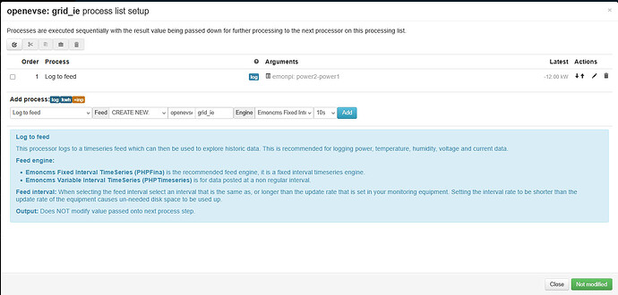

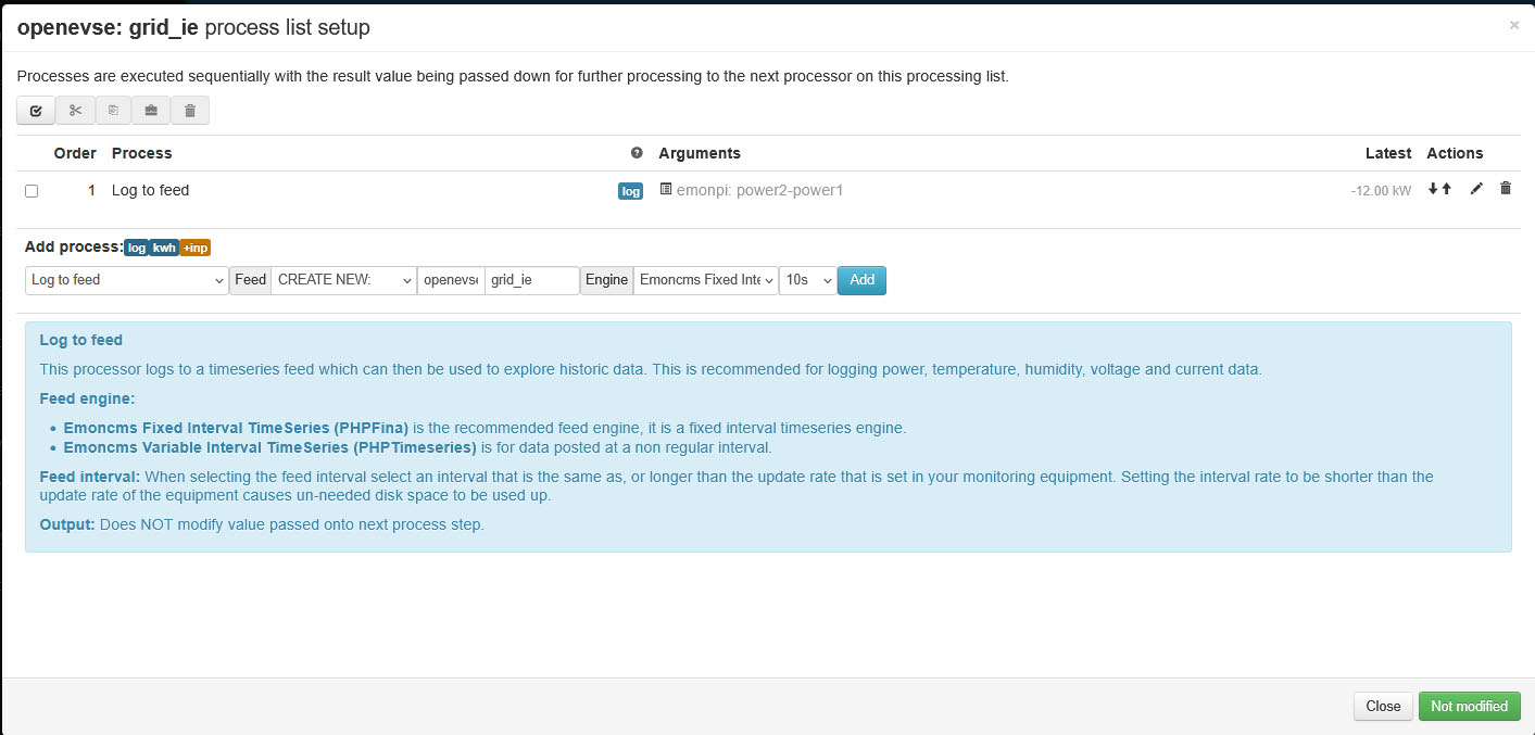

Checking how the openevse: grid\_ie process list setup is currently (and has always been) you will see that it uses emonpi:power2-power1 but the result is -12W and never changes. There is not a drop-down option to use power1-power2. How do I change to power1-power2?
Your note 1 is correct but does not trouble me.

**Post date:** [4 October 2026 22:34 UTC](https://community.openenergymonitor.org/t/openevse-out-of-balance-with-solar/30384/27 "2026-10-04T22:34:49Z")
Of course you can, but you risk power1 and power2 coming from different sampling intervals with a 10 s difference between them - I just thought reversing the c.t. so that power2 becomes -power2 so that power1pluspower2 is actually power1plus(minuspower2) was the best way of going about it and guaranteeing that the two numbers were consistent.
If you really need to do it in the process list, do it for power2 (the last to be done), and after you’ve done all the things for power2 on its own:
Reset to Original _{gives power2}_
× `-1`
+ feed `power1` _{gives power1 + (-power2) = power1 - power2}_
log to feed `power1minuspower2`_{or whatever}_
> [@BrianD](#):
Where can I see that? Remember all I know about your setup is what is in this Topic. A process list is executed when its data arrives in emonCMS. In which Input’s process list is power2 - power1 calculated? You are not doing it in post no.24, that is logging the Input `grid_ie` to a Feed you are calling power2-power1, it is not doing the maths. Where does the Input `grid_ie` get its data from? Is it getting data regularly? It looks like it isn’t, it is 3 days old.
If you put the maths in power2, it will be calculated every time the emonPi sends its readings to emonCMS, and with the value in a Feed, it is readily available at any time and less than 10 s old.

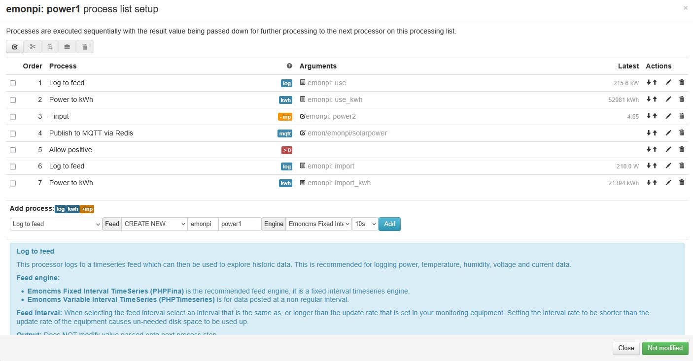

However, in answer to your question there is an image showing the derivation of power1 and power2 for the emonpi in my original post but I have included it here again.

Can you show us the Input processing list for Power1? Why is there an Input being subtracted from Power1 before logging to feed, and whats being published to MQTT?

But it doesn’t show that at all! It only shows the input values and that there is processing, not what the actual steps are, and the names of the Feeds involved.

I have attached what I believe @glyn.hudson is asking for but I must point out that I did not write this stuff it was kindly provided for me by a member of the old forum. I don’t know what is being published to MQTT because I don’t know how to find out. Maybe I shall go and read up on it and learn.

Ok, that looks fine.
