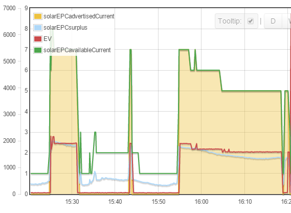

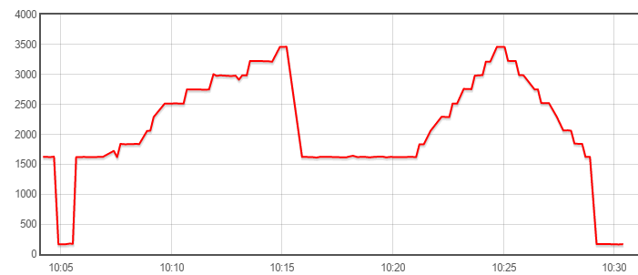

Evening all. I experimented with variable rate charging in the summer of 2015 with my Leaf. I do own an OpenEVSE (since 2014) but I didn’t use that I used a Virdian EPC and an arduino based board made by another forum member driven by inputs from OpenEnergyMonitor / Emonms over RF.
Some finding that may be interesting for others :
- The leaf will support charging from 6 amps up in 1 amp steps. It switches almost instantly when the EVSE changes the max available current.
- The leaf will also support charging ‘pause’. When the sun goes in you can command the car to stop pulling current by switching the available current to zero. At this point the leaf charging lights stop flashing and the 3rd light on the dash flashes. (you can also test this with an OOTB OpenEVSE, when charging press the button and it pauses, press again and it continues.)
- I only have 12 x 250w (3kW) of solar installed currently. Its surprising how little time in the day I have enough ‘true surplus’ to charge only from solar. With a base load in the house of 2-300w, even a minimum charge of 6A means I need over 1700w from the PV to be in the clear. On a good summers day I am only above this threshold for a max of 6 hours a day which only allows a max of about 8 kWh to be captured directly from PV.
test tracking the solar surplus and what could be available :
> <https://twitter.com/snfosberry/status/624528907480485888>
logging what was going on to emoncms :
> <https://twitter.com/snfosberry/status/625049317800308736>
monitoring the actual power drawn by the car as I change the available current value :
> <https://twitter.com/snfosberry/status/622338873809608704>
