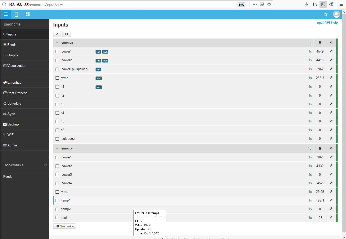

The emonPi is inches from the MartinR diverter antenna but it will not decode the UHF TX signal easily.
I am very happy to use only the local emoncms to control the OpenEVSE
This page of the guide has me very puzzled:
[https://guide.openenergymonitor.org/integrations/evse-setup/#emoncms-server-setup](https://guide.openenergymonitor.org/integrations/evse-setup/#emoncms-server-setup)
This image shows how to add a ‘Publish to MQTT’ process but try as I may there appears to be no such option in my setup.
 ![process_list](https://community.openenergymonitor.org/uploads/default/original/2X/2/22c19373d8bd2e23a73b3b88959d5fda321be25d.jpeg)

> [@BrianD](#):
Are you looking at the local emoncms? It is there by default on an emonPi/SD image but not available on [emoncms.org](http://emoncms.org).
[edit] Also what is the update frequency of the diverter? And what else is on the same circuit from the House CU as the remote diverter load?
Can you also confirm what “ext\_divert” is exactly? is it just the remote load? Is it switched by another switch eg a thermostat? or does it accurately reflect the actual use rather than available to use?

So your diverter data should be visible in emoncms but perhaps unrecognisable? because the current “node 10” definition in emonhub.conf [nodes] is
```auto
[[10]]
    nodename = emontx1
    [[[rx]]]
       names = power1, power2, power3, power4, vrms, temp1, temp2, temp3, temp4, temp5, temp6, pulse
       datacode = h
       scales = 1,1,1,1,0.01,0.1,0.1, 0.1,0.1,0.1,0.1,1
       units =W,W,W,W,V,C,C,C,C,C,C,p
do you have a “emontx1” showing up in emoncms? Try commenting out the current node 10 definition and adding the correct definition, so the bit shown imediatly above should be replaced with

> [@pb66](#):
> Or you can post your emonhub.log and emonhub.conf for us to check first. There should be some evidence of your diverter trying to post.
 ![inputs_01](https://community.openenergymonitor.org/uploads/default/original/2X/4/46ea45245e56b35c2ac9f942858d626fe2d467ec.jpeg)
> [@pb66](#):
Log file below:
[emonhub\_log.txt](https://community.openenergymonitor.org/uploads/short-url/b0t0S7WCYf1kAPwSKHQG3QGOxM4.txt) (1.6 MB)

**Author:** ![pb66](https://community.openenergymonitor.org/user_avatar/community.openenergymonitor.org/pb66/32/27_2.png) [@pb66](https://community.openenergymonitor.org/u/pb66)\
**Post date:** [29 August 2019 16:46 UTC](https://community.openenergymonitor.org/t/openevse-charge-regulation-a-possible-improvement/11735/37 "2019-08-29T16:46:30Z")
So in your conf file there is this section
```auto
[[10]]
    nodename = emontx1
    [[[rx]]]
       datacode = h
and that is trying to decode your diverter and not getting it right because it is defining a emontx payload. A emonTx used to use node 10 by default. So the “[[10]]” must be reused,
The `nodename=` can be anything you like that is unique and no special chars etc hyphens and underscores, eg “DHW-Diverter”, “SolarDiverter”, MartinR\_Diverter etc etc
The names, datacodes, scales and units should all reflect the 7 integers in your diverter payload like so.
```auto
[[10]]
  nodename = SolarDiverter
  [[[rx]]]
     names = Grid, Solar, power3, Vrms, Temp, Freq, ext_divert
     datacodes = h,h,h,h,h,h,h
     scales = 1,1,1,0.01,0.01,0.01,1
     units = W,W,W,V,C,Hz,W
The “datacodes=” line is important. In the original form of “datacode=h” would allow any payload of integers to pass, hence your 7 value payload was not rejected and only the first 7 names, scales and units were used of the expected 12 value emontx payload. A stricter check is prefered so by using “datacodes=h,h,h,h,h,h,h” we are defining that a payload must be exactly 7 ints long (14bytes). The reason this is important is because when your diverter starts controlling the remote load it will also use “node 10” but I do not know what that payload looks like, is it the same? If it varies it must be rejected so it doesn’t contaminate the data collected from the standard payload. It’s good practice to do it this way anyway.
Once you make the changes above to your emonhub.conf, you will see a new input created with your new name (SolarDiverter ?) and all the “emontx1” inputs can be deleted.
From this point forward you can use these values as your basic grid and solar values and we have 2 spare inputs on the emonPi for other things.
