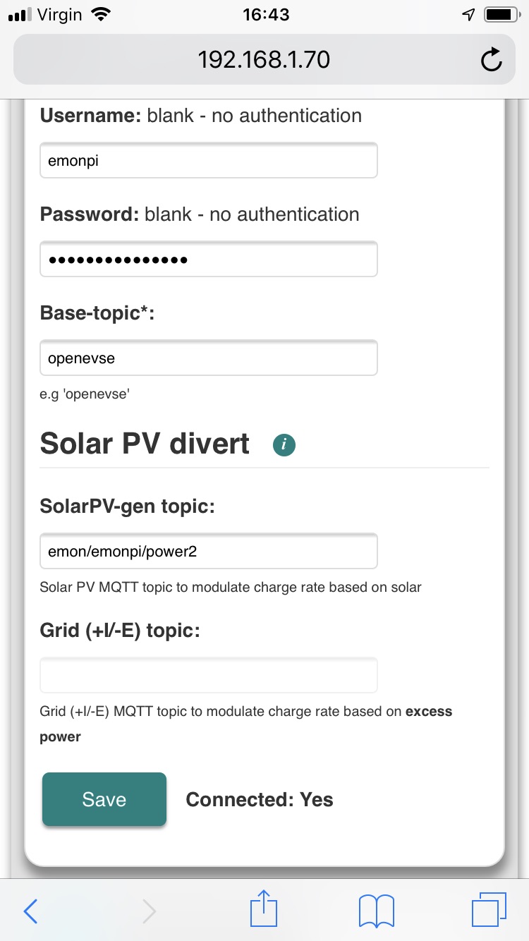

Today is sunny and the ~ 4kW excess solar is charging the car nicely taking priority over my energy diverter as intended using SolarPV-gen topic: emon/emonpi/power2
All good until my wife turns on the oven!
The problem seems to be that SolarPV-gen topic: emon/emonpi/power2 simply allows the car to use all the PV power. Now this could be handled better in software but in the short term suppose I connect another CT on the house feed but position it to be out of phase with the existing CT and wire it in series with the PV CT. Now the uncontrolled house load will ‘regulate’ the available PV power and emonpi should control the OpenEVSE to match the surplus PV.
Is this feasible?

I guess my problem is trying to sort out too many issues in one go. Yes thank you Paul I did read your instructions but I am a long way behind you in understanding how this stuff hangs together and did not wish to burden you with more dumb questions. You appear to have great patience so I shall try to explain my difficulty.
I looked up MQTT and it’s a protocol which I guess is used between the emonPi and the OpenEVSE. It may also be used to communicate with the car but I have not looked into that.
There are two MQTT topics I can control using the OpenEVSE web interface under the Solar PV divert heading. These are SolarPV-gen topic and Grid (+I/E) topic.
I currently have emon/emonpi/power2 in the SolarPV-gen topic and the Grid (+I/E) topic is blank.
You are suggesting that I:
“simply need to subtract your normal consumption from the PV and use that “available PV” value to drive your EV charger via a “publish\_to\_mqtt” process and just change the openEVSE “solar topic” to use that new “available PV” topic.”
Looking again at the instructions I see:
This may be required for a [Type 1 solar PV system](https://guide.openenergymonitor.org/applications/solar-pv/#sensor-installation): Grid (import/export) = site-consumption – Generation.
Are you suggesting I put Grid (import/export) = site-consumption – Generation in the Grid (+I/E) topic box?
 ![PV-divert](https://community.openenergymonitor.org/uploads/default/original/2X/1/17f18b3bf80251264c52ac25d2b3c691eafa7db6.jpeg)

> [@BrianD](#):
Not quite true,
There are 2 MQTT selection fields where you can enter MQTT topics, but the MQTT topic is what controls the EV charger not the other way round.
There is a choice of 2 ways to subscribe to any single MQTT topic. The pool from which you could choose that one topic is only restricted by your own implementation, you can choose from existing MQTT topics or create custom MQTT topic(s).
It seems the difference between the 2 MQTT selection boxes is simply that one works on a positive “available for EV” and the other on a negative “available for EV” value, the latter obviously ignores also any positive “import” value and without testing or diving into the code, I do not know if the former will also ignore negative values.
So all you need is to (create and) select a feed that better tracks what you want as “available for EV”, selecting that feed in which ever of the 2 boxes suits it’s sign.
Put it in “SolarPV-gen topic:” if it is a value that increases positively when the EV should be charging or in “Grid (+I/-E) topic:” if it is a value that increases with a negative sign when the EV should be charging.
Think of the MQTT topic as a “EV charge limiter” rather than specifically PV or export etc. You could if you chose, fabricate these values and drive it manually or automate it with a complex algorithm. How you get the numbers is up to you, which box the topic goes in depends on the sign/direction of the values, the EV charger will just try and operate under that limit you give it.
As for the topic path/name, if you are using an existing topic eg emon/emonpi/power1 or emon/emonpi/power2 etc then you need to use the topic path/name in question, but if you are creating your own feed in emoncms and publishing that then you can designate your own MQTT topic specifically for the job eg emon/openevse/available and that is what you enter both in the “publish to mqtt” process in emoncms and also in the EV web interface. ie emoncms is publishing values to emon/openevse/available and the EV is subscribing (listening) to emon/openevse/available to get a value to control the charging level.
So working backwards here 🙂 We’ve covered how to get the feed value to the EV and what it does with it. That just leaves the source of the data to be established.

Originally 8 days ago on the other thread
> [@emonPi Solar PV OpenEVSE Setup Tesla Model 3](https://community.openenergymonitor.org/t/emonpi-solar-pv-openevse-setup-tesla-model-3/11675/26):
> I think you need to create a “available\_excess” feed which is pretty much PV minus regular non-diverter consumption.
. . . and in this thread 3 days ago
> [@pb66](#):
> You simply need to subtract your normal consumption from the PV and use that “available PV” value to drive your EV charger
Alternatively you could move CT4 to between HB2 and the house CU or maybe some form of feedback value could be used, for example **available for** EV = PV – (HB2 - **used by** EV). Whether the EV is removed from the “normal use” by changing the wiring, moving the CT or in the maths, EV must be removed from the basic PV - USE equation.
Otherwise when there is 2KW of spare PV the EV will be told to use 2kW at which point there is no spare PV so the EV will be switched off and then the 2kW spare reappears so the EV is told to use the 2kW etc etc etc
Do you agree with this part before we reintroduce the diverter?
[edit] Looking closer at the diagrams, moving the CT not the wiring seems the easy choice, the change of diagram style confuses comparison between what you had originally and what you have now.
**Author:** ![BrianD](https://community.openenergymonitor.org/user_avatar/community.openenergymonitor.org/briand/32/5022_2.png) [@BrianD](https://community.openenergymonitor.org/u/BrianD)\
**Post date:** [26 August 2019 12:13 UTC](https://community.openenergymonitor.org/t/openevse-charge-regulation-a-possible-improvement/11735/18 "2019-08-26T12:13:12Z")
> [@pb66](#):
Yes indeed I have always agreed with what you are saying. My first post in this thread was seeking to achieve the same thing but by a different method.
If I move CT4 between Henley 2 and the house CU the emonPi will have the information required to calculate surplus PV (EV = PV – CT2) However, the power consumed as displayed and recorded on emoncms will not include the EV.
If we leave things as shown on version 6 of my drawing let’s consider what will happen if as the system operates.
Where EVm = EV measured
EVc = EV control level
House = House CU load
Assuming that the command sent to EV will be EVc = PV – (House + EVm)
Initially EVm = 0 therefore the calculation will result in EVc = (PV – House)
Some short while later as the OpenEVSE ramps up the value of EVm will increase and consequently will effectively apply negative feedback by reducing EVc which should prevent overshoot. The inherent delays in this should result in a damped control system which will not oscillate up and down.
I am very happy to try this but I don’t yet know how to do it. If you could please give me an example I would be delighted to try and report back the result.
