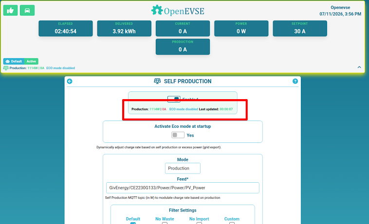

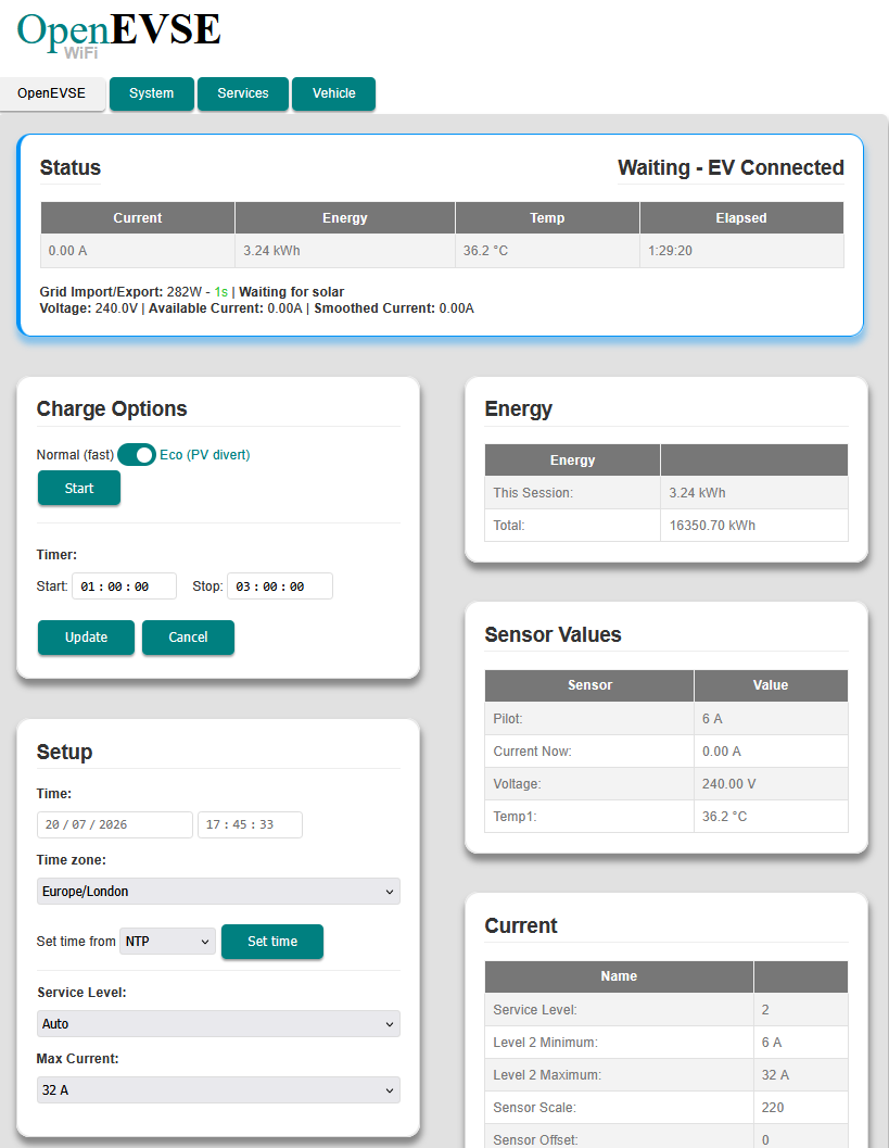

Can you share a screenshot of your self-production page e.g

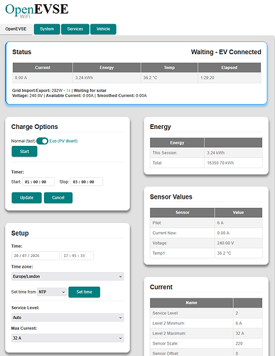

Hi Glyn,
Thanks for looking at this for me.
As I mentioned I am on a pretty old version of the firmware, so it looks pretty different to your example. I should update it sometime, but right now, as it was working before I replaced the cable, I think that would just introduce additional variables.
Here is how it looks right now, although the sun has gone in so it is not trying to PV Divert right now:
 ![image](https://community.openenergymonitor.org/uploads/default/original/3X/e/b/eb268e2d8b30456554913e16d710a86699e02e69.png)
**Post date:** [20 July 2026 17:40 UTC](https://community.openenergymonitor.org/t/openevse-charge-rate-problem-on-solar-divert/30158/4 "2026-07-20T17:40:22Z")
That looks good as far as I can see. Maybe try posting some more screenshots when PV is generating and your trying to use divert

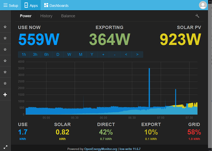

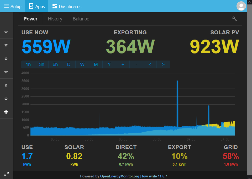

As you suggested, here are some more screenshots as the sun is climbing in the sky this morning.
Firstly, at about 7:40am, the PV is now making a bit more than the house is using:
 ![image](https://community.openenergymonitor.org/uploads/default/original/3X/2/5/258fc08ff69dac2b60158ab76c7baa849c629752.png)

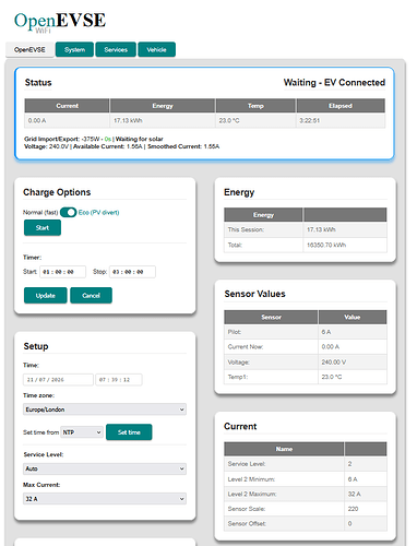

At this time, EVSE looks good, correctly picking up the solar from my EMONPi and working out available and smoothed current, and not charging the car yet as there is not enough:
 ![image](https://community.openenergymonitor.org/uploads/default/original/3X/a/8/a88c05d67dab3c95b4556d54eb89b4985a5f0bca.png)
I’ll post the next screenshots as soon as the sun is enough to charge the car.

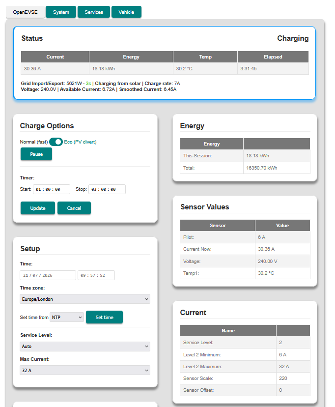

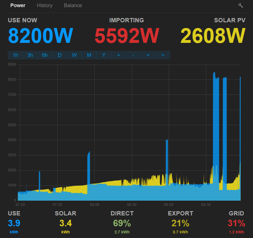

So now we see the problem. The sun is now strong enough to generate spare PV to charge the car.
 ![image](https://community.openenergymonitor.org/uploads/default/original/3X/8/3/832d26ff2508a8dfdd314dc9c3a961da02b7a2f5.png)
As you can see, it is correctly working out the available solar with just over 6A available, and it starts charging the car. But instead of charging at about the avaialble current (previously it would have charged at about 5.5A or so) it charges at the full 32A, resulting in drawing over 5KW from the grid.
The amount being drawn from the grid is shown correctly, but it is charging at the wrong rate. If I manually modify the current limit from 32A, it then does charge at the rate I have manually set.
 ![image](https://community.openenergymonitor.org/uploads/default/original/3X/c/6/c69b7c2e50c3e03985322f62a60c61a9db53e9a2.png)
You can see the other two 8KW spikes when the sun came out briefly earlier.
So something must have changed when I replaced the cable - either I have not fitted it correctly in some way, which I can’t work out because all the of the other functions that require control of the charging current work ok, or have I somehow disturbed something else?

> [@PeteBee](#):
> As you can see, it is correctly working out the available solar with just over 6A available, and it starts charging the car. But instead of charging at about the available current (previously it would have charged at about 5.5A or so) it charges at the full 32A, resulting in drawing over 5KW from the grid.
This screenshot is showing +5.6kW which means 5.6kW if import. A positive value is import and a negative value is export.
I would recommend instead of using Grid Import/Export to change solar PV divert to be based on solar PV generation. You’ll need to change the MQTT topic for solar PV generation.

Hi Glyn, yes, 5.6KW is what is actually happening, it is showing that value correctly, but it is failing to limit the charge current to the 7A that is shown as available.
It is working out all the figures correctly using the settings and MQTT topic, which was originally set up as per the instructions. It is getting the correct import/export figures, and working out the correct available current (7A in the example above) but then failing to limit that current in the charger.
So if you are saying that the MQTT topic needs changing, why was it working perfectly until I changed the physical charge cable? I havn’t changed any settings or topic etc.
If I change the topic so it looks at solar generation alone, how would it know how much of that generation is available to charge the car and how much is being used by the rest of the house and not available?
